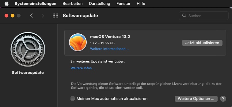

I went back into System Update and all it shows is a Ventura upgrade. I deseleceted and reselected all the update options and all it shows is Ventura. Is the latest Monterey version of Safari 16.3?
It should show you more things below the Ventura upgrade marked by a small text saying "more available updates" or similar, just forgot the exact wording and below that a text URL "more Info". There you should see after clicking on that updates to Monterey 12.6.5 . Safari 16.3 is currently the most recent update to this.
It did have the more followed by dots and a + sign and no I did not click on that but since you mentioned it, I will.

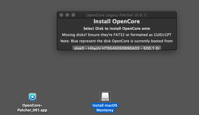

OK, I think I uderstand my situation a little better now. The instructions mention the possibility of creating the installer USB manually, so I used "createinstallmedia" to make a Monterey installer USB (GPT with ESP), and went straight to the "Build and Install Opencore" step. It built fine, but when I went to install, this is what I saw:

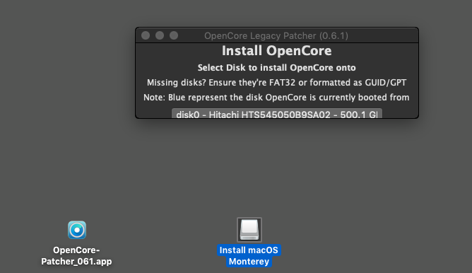

The only disk it sees is disk0, my internal drive. I have several external drives, USB and Firewire, including the USB Monterey installer, but they don't show up.
My guess is that the patcher GUI app is incompatible with my system for some reason, and it cannot locate any external drives. Something about the way the app locates external drives doesn't work on my system. Of course, that means that the patcher GUI is useless for me to create an Opencore installer USB.
Is there any way to use a Terminal window command line to put Opencore on the Monterey installer USB? I need a way to bypass the GUI.
The USB should be made with HFS+ format, not ESP (whatever that is) with the GUID Partition Map setting. Do you have another Mac or have access to one, a friend's Mac or such?
When you start up the OCLP app from another Mac, you will see a menu that has a Settings item. Use that to specify the intended target Mac, and then install OCLP to the USB.

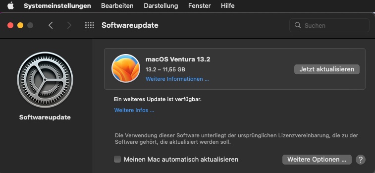

Okay so I checked and all I see is More Info.... below the option to upgrade to Ventura. If I click on more info, it opens Safari and directs me to Apple.com

It should look like this..not the "more Info" directly below the Ventura upgrade but the second one further down.

Thank you. I believe Apple's createinstallmedia script formats the USB as HFS+, and I can confirm that my Monterey installer USB is HFS+. ESP stands for "EFI System Partition", the standard EFI partition. By the way, GPT is GUID Partition Table, the post-MBR standard, which usually includes an ESP.
I am on a Macbook5,2 (mid-2009) on Mojave using the dosdude1 patcher. I have no access to any other Macs.
Do you know how to install Opencore to an installer USB via the command line? I think that's my best option at this stage.
What exactly keeps you from formatting your USB medium with the right partiton map and format? When it is formatted it will be shown as an install medium by OCLP, if it is not correctly formatted neither Finder nor OCLP will recognize it as it seems to be the case here?
I don't understand what you mean. It's formatted GPT with an EFI partition and the install partition as HFS+. How is that not the "right partition map"? I did it with Disk Utility. And it's Apple's createinstallmedia script that ensures it's the right format.
Also, my other external disks are GPT/EFI/HFS+. They're not showing up either. The problem must be the method the app uses to locate external disks, which doesn't work on my system, as I explained.
No, it doesn't look like that. The only option that is available is the upgrade to Ventura. The option for updates below Ventura is missing. However it was a few days ago that I installed the latest version of Monterey via OCLP so perhaps there aren't any updates as of yet.
Well, nobody suggested anything, so I tried to figure it out on my own. The "Build" process creates a temporary directory containing "EFI" and "System" file trees, so I copied those to the USB installer from "createinstallmedia". (I noted that would overwrite a System "boot.efi" with a new one.)
I was able to boot the USB into Opencore.efi, but couldn't start the installer, so I booted back into Mojave....
...and discovered that simply booting into Opencore.efi on a USB overwrote my hard disk's Refind EFI setup, as well as overwriting some nvram variables.
Seriously, that was rude. That's the sort of behavior I expect from malware, not community software like Opencore.
My guess is that someone did some quick-and-dirty programming, without any "fail gracefully" finesse.
So, no, I'm not going this route any time soon. I was able to clean up that mess, and am not inclined to try and find more.
