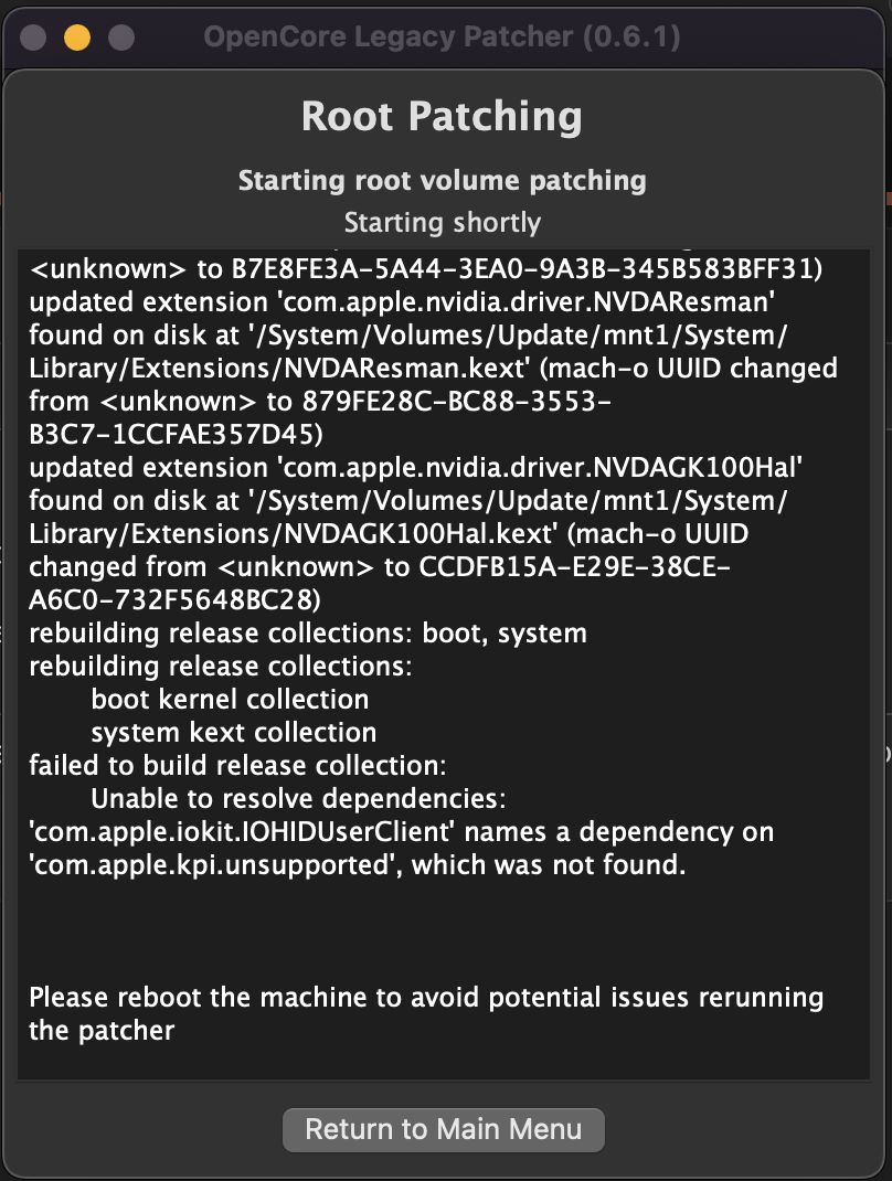

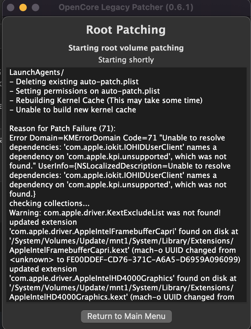

Hi I'm running Montery on MBP 10,1 using OCLP. Everything fine and done a couple of OTA updates since first upgrading and running post install root patches. After upgrading to OCLP 0.6.1 I have issues running post install patches (I should note that I ran "post install root patch" before running "build and install opencore" after first installing to 0.61 - not sure if this matters.
1) can't Copy from the log window hence I've not posted the full log
2) unable to build new kernel patch error domain=KMErrordomain code=71
Subsequently rebooted, ran "build and install opencore" (no errors/issues) rebooted but I'm still getting the same error when running "post install root patch". Any suggestions how to fix this?
Try this.
1. Download OCLP 0.6.1 from GitHub again.
2. Move downloaded file into program folder.
3. You will be asked if you want to replace the existing OpenCore Patcher. Click Replace.
4. Open the OpenCore-Patcher application.
5. Ran Post install Root Patch.
Prospect0r
macrumors newbie
Mar 5, 2023
8
4
Try this.

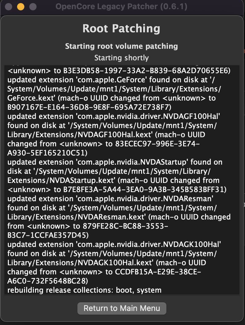

Thanks, I tried re-downloading and installing OCLP 0.6.1 to the applications folder instead. Still getting the same error. Still can't copy from the log so screen grabbed it instead:
Screenshot 2023-03-06 at 19.02.13.png Screenshot 2023-03-06 at 19.03.22.png Screenshot 2023-03-06 at 19.03.42.png
