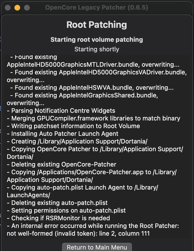

When I do the Root Patches using 0.6.5 I receive this on my MacBookAir4,2
Any clues?
Thank you,
J

Unable to do post install root patch on OCLP 0.6.5 (no issue on 0.6.4), does anyone have any idea what's the error about?

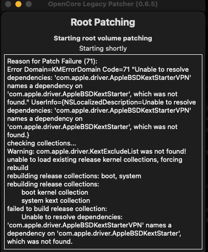

I just installed OCLP 0.6.5 On a 2008 mac pro running Monterey. i tried installing root patch but it gives me this failure message, " FAIL TO BUILD RELEASE COLLECTION: UNABLE TO RESOLVE DEPENDENCIES: 'COM.APPLE.DRIVER.USB.APPLEUSBHOSTPLATFORMPROPERTIES' NAMES A DEPENDENCY ON 'COM.APPLE.DRIVER.APPLEUSBHOSTMERGEPROPERTIES; WHICH WAS NOT FOUND. PLEASE REBOOT THE MACHINE TO AVOID POTENTIAL ISSUES RERUNNING THE PATCHER. your help would be greatly appreciated in resolving that issue.

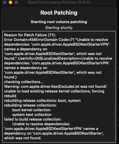

I had a similar case, solved by:
1. use MountEFI (available on Github) to mount the EFI partition, and
2. erase everything in that partition, then
3. reboot and reset the NVRAM (hold down Command + Option+r+p keys at startup until you hear 2 bongs)
4. rerun the OCLP build and Install, write to the startup disk, reboot, and
5. rerun the post install root patches.
There is no need or benefit in using OCLP later than 0.6.1, and 0.4.11 may be best for Monterey.
I suggest trying 0.4.11 first. <https://github.com/dortania/OpenCore-Legacy-Patcher/releases>
I found out the hard way - apps not playing well / at all - that this is the recommended strategy. OCLP 0.5.0 is my sweetspot.
