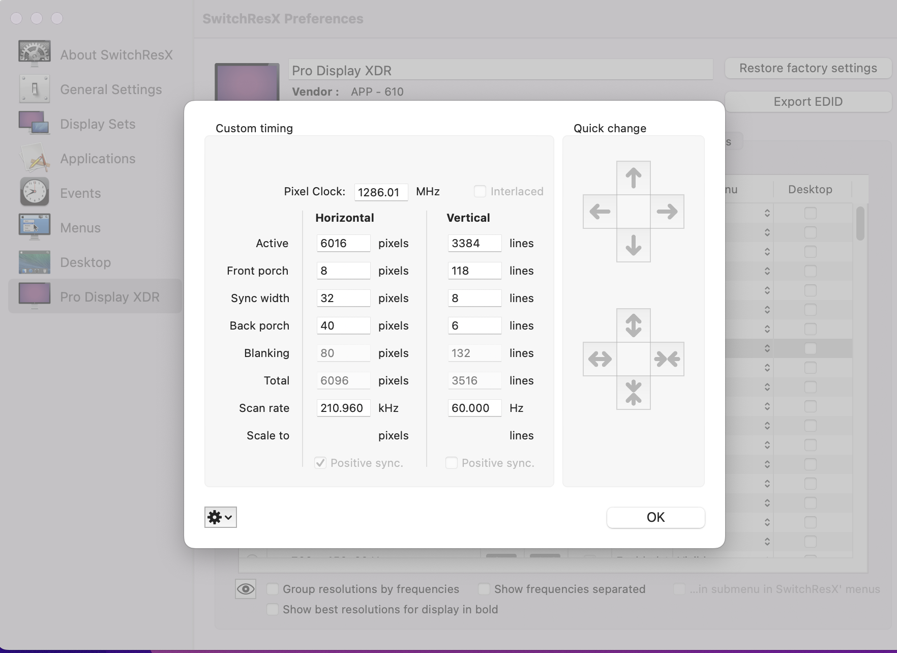

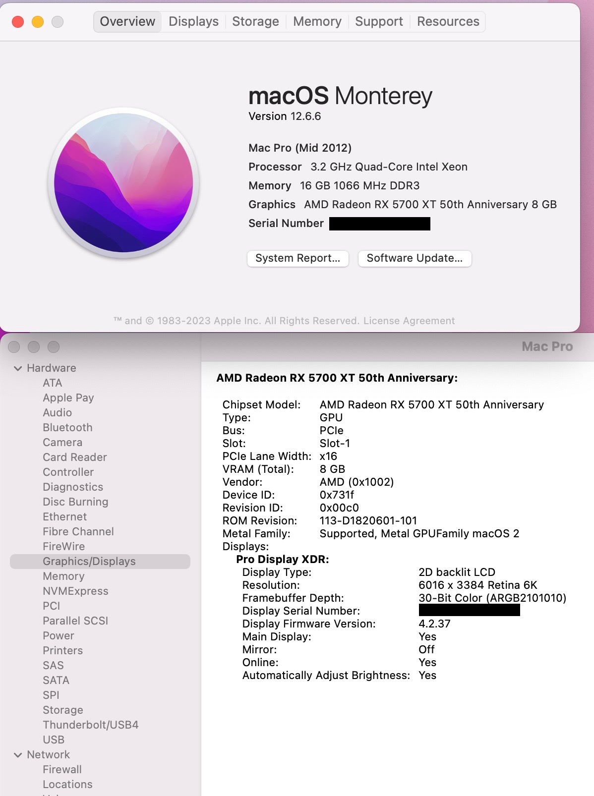

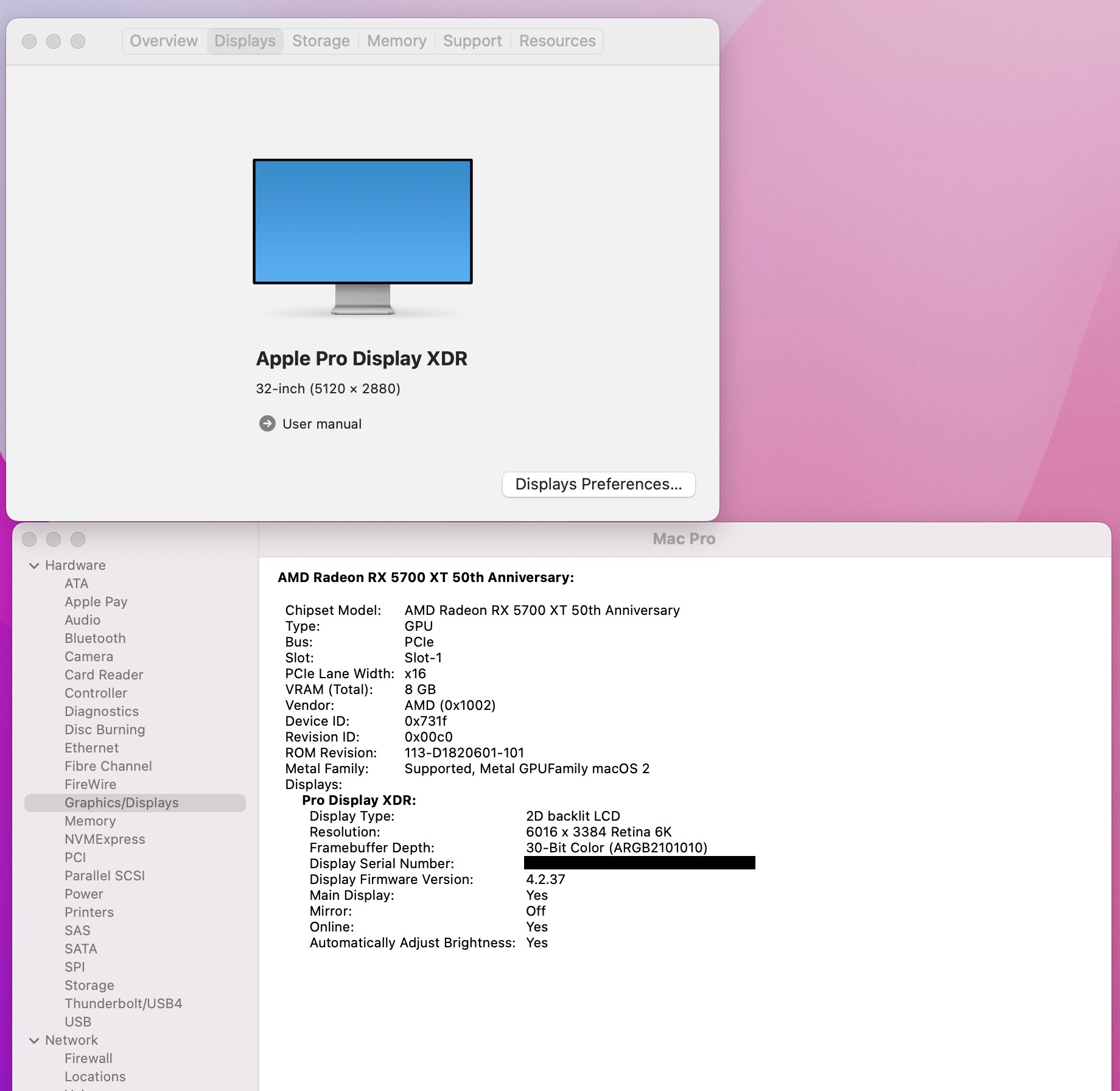

Got it working! Even connected to my Pro Display XDR, but only at 5K?
@joevt shouldn't a 5700XT + Belkin Huawei VR cable work at 6K with the Pro Display XDR? See attached, on the System Info Displays screen I'm only showing 5120x2880.
I don't think macOS shows the output resolution. Use SwitchResX, double click the selected Current Resolution to view the timing info. It should say pixel clock 1286 MHz and active pixels 6016x3384.
Looks like I'm good-to-go. Thanks for the tip.
