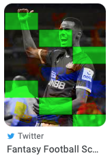

Hi! I installed Monterey on my Imac 13,2 with OCLP 0.5.0 according to this thread's installation info. However, I get som issues, one being in Safari where I get these weird green squares in some pictures on the web, very random. It only occurs in Safari. See attached a picture.
The other thing is that most sites reload and crash in Safari 16.5.1, "A problem occured multiple times". I know the easy solution is to not use Safari, but one major reason for using OCLP for me is the oppourtunity to use Safari on this machine, as I also have an iPhone and a Macbook Air that syncs bookmarks etc.
Any tips?
Any tips?
Did you reapply post patches after installing Safari?
