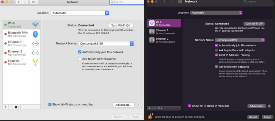

The problem is what crjackson2134 and I have is our audio interface (firewire) works fine.
Although running Pro Tools and quitting a session it won't quit and have to force quit.
I'm just thinking out of the box here. but I noticed on Mojave in the network tab it shows the firewire icon, but in Monterey is gone,
So I'm thinking maybe that's why Pro Tools doesn't see the firewire device to shut it down >?
Reactions: 0134168
******* thanks so much.

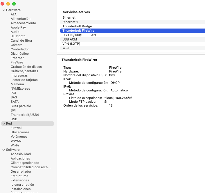

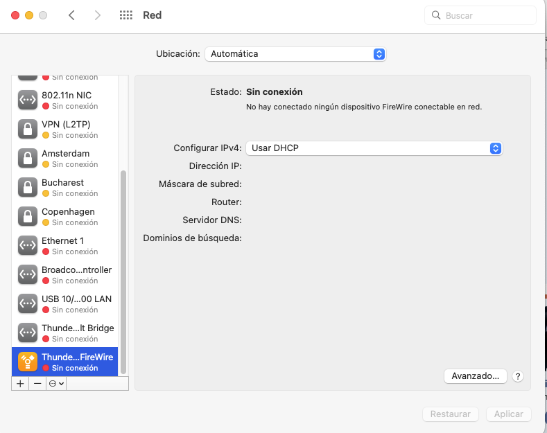

In Mojave Pro Tools gets to shut it down?
What I can tell you is that in Monterey, some time ago I had a thunderbolt Titan pci card, and It could see a thunderbolt to Firewire adapter.
According to this post IOFireWireIP.kext was removed with Big Sur - which should be the driver for getting an ethernet device on a FireWire connection.
So, from Big Sur on, you cannot any longer conclude from the network device list whether you have a working FireWire device or not.

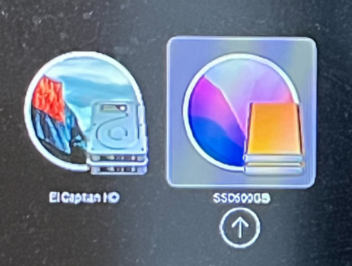

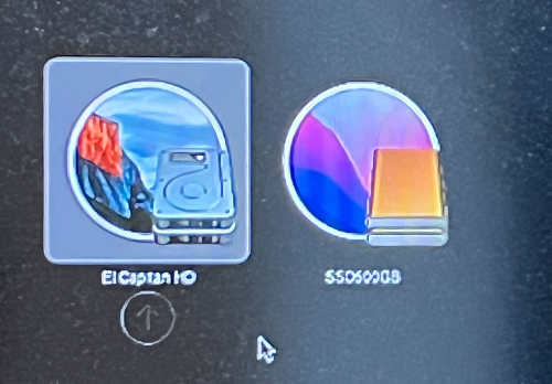

Today I want to upgrade 4G to 8G memory for my mac mini Late 2009, but not successful. I restore original 4G memory and boot again, I found the boot not from external SSD where I installed Monterey by OCLP, even I reinstall OCLP to interal HDD and external SSD again, the boot is still from internal HDD.
The boot is from external SSD before I upgrade, do I have to install Monterey to external SSD by OCLP again?
Press the option key at boot to get to the Apple Startup Manager. Use the arrow keys to select OCLP. Hold the control-key so that the up arrow turns into a circular arrow and press return to select OCLP as the default boot option and to begin booting OCLP.

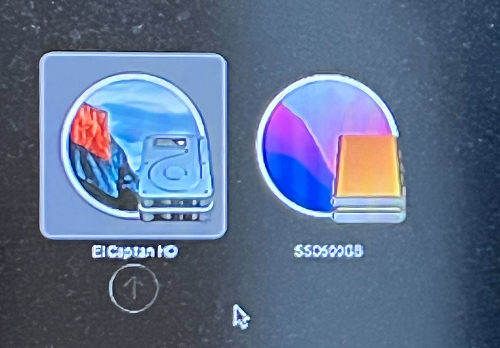

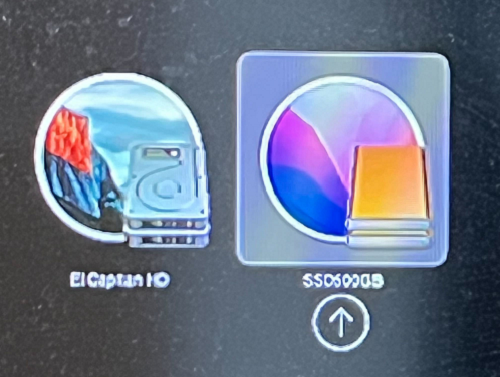

When I boot, there is two icons, one is internal with El Capitan and one is external with Monterey by OCLP.
Even if I press Control key to select external icon to boot, it still show the same, default on internal icon.
I tried several times, all in the same results, what can I do next?
Is this the Apple Startup Manager or OCLP? You should show the entire screen.
Does pressing the Control key change the up arrow to a circular arrow?
Is OCLP stored on an EFI partition or not? Why does it say SSD600GB?
I am not sure if it is Apple Startup manager or OCLP, but even if I don't press Option key, the screen is still show, do I have to reset PRAM when boot?
Apple Startup Manager should not appear unless you hold option key.
The OCLP boot picker looks different than Apple Startup Manager which is why I asked for a picture of the entire screen.
The OCLP boot picker has a release version in the bottom right corner and it may have a shutdown and restart button at the bottom middle of the screen.
Seems like OCLP works but Monterey won't boot. If you select Monterey it just reboots back into OCLP?
Maybe zap the PRAM so you can get into Apple Startup Manager. What do you see in Apple Startup Manager? Do you have more than one OCLP? Maybe one of them works.
There have a shutdown and restart button at the bottom middle of the screen, so this should be OCLP.
I named external SSD to SSD500GB, only one OCLP on SSD500GB, when I pressed Ctrl key and select Monterey (SSD500GB), the Monterey will be boot, it still select Internal HDD default when I reboot again.
I think taht I know the reason, I also installed OCLP to my internal HDD, do I have to remove it and only keep OCLP to my external SSD?

I named SSD as "SSD500GB" when I format my SSD, then I installed Monterey by OCLP, now the "SSD500GB" as lable show on boot picker even if I modified name to "Monterey SSD", how can I change this to "Monterey SSD"?
