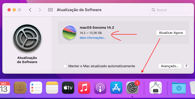

Help me! (Monterey 12.7.2 - OCLP 0.5.0) MacBookPro9,1
How do I remove this? (update notification)
