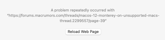

macOS Monterey Beta 3 & Safari 15.0 (17612.1.22.1.4) issue
In "macOS Monterey Beta 3" sometimes Safari try to restart a page several times and then stops with a white page and notice that cannot load.
Initially I solved instantly from the menu:
Develop -> Disable JavaScript.
Once this done, the page has been opened without problems and now it is reopened even if I reactivated JavaScript.
Attention, since the problem may have been solved after installing "Safari Developer Preview", but don't ask me why... Maybe "Safari Developer Preview" introduced some packages in "Library" also needed for Safari?... I can't say it, but now Safari is always working, even if I open very complex pages.
In any case we could conclude that problems derive from poorly realized WEB pages or from Java version and/or that Apple will have to introduce some control so that Safari can open this pages also.
Note: the issue was reported privately and kindly by @Will350, thanking you
And... I forgot ... I add that Safari now it's very much much much much fast !!! ... Really impressive :)

Thank you very much Okonnel,
Javascript is the problem. I have disabled it and the pages load well without the error. When I activate the reload pages again, and I also have Safari Developer Preview installed...

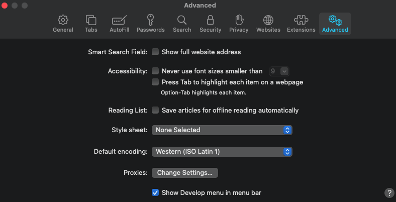

Wher can I get the Developer Preview from Safari? Or is it part of the normal DP3 from Monterey?
Reactions: OKonnel
Safari /Preferences/Advanced
Show developp menue
Reactions: Pinarek and OKonnel
Ok, I can confirm that the pages load if you rund the Technology Preview of Safari WITH enabled Java Script!
Reactions: OKonnel
Can confirm this safari bug only happens on the NVidea graphics - as mentioned on page 38 after my post - My iMac 13,2 has GeForce GTX 660 graphics where my MBP 2015 which has native support for Monterey has Intel Iris graphics.
Thank you to all those who found this bug - disabling Javascript works a treat as does running the safari technology preview.
No issues at all with the STP - writing this note on my iMac now without issues - this forum page wouldn't even load before...

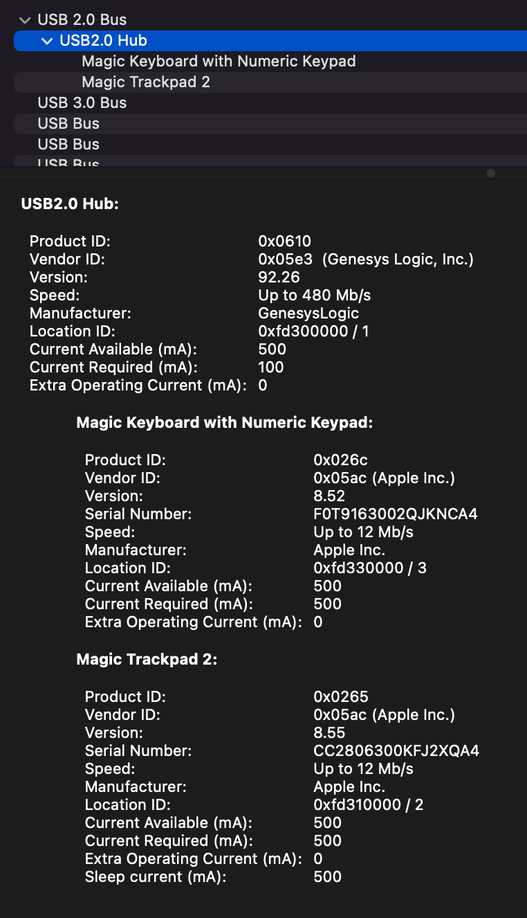

Problem: createinstallmedia bootstick Monterey Beta 3 got stuck into asking for Bluetooth input devices. No Bluetooth available.
ok, I tested a bit further.
added a USB Hub, no cure (anyway, the Keyboard was thru the Apple Cinema Display Hub), got the gui for adding Bluetooth Mouse or Trackpad.
I have seen boot messages showing Keyboard and Apple Cinema USB Hardware.
I tried to hotplug USB stuff, add a USB Mouse and the cursor moved. wtf ?!... ok, maybe I had the USB Mouse in on 1st attempt. Used to have that USB Mouse plugged in before I used the Magic Trackpad 2 wired.
Booted again with USB Mouse in and got the createmediainstall bootstick working with USB in the MP3,1
Latebloom showed its delay messages, too btw (100/10/1 settings).
Must call it a day, will try to install Monterey Beta 3 when I get spare time.
But the main problem is solved. The reason was I assumed wired Magic Trackpad 2 is working as a pointing device in every situation (what it usually does).

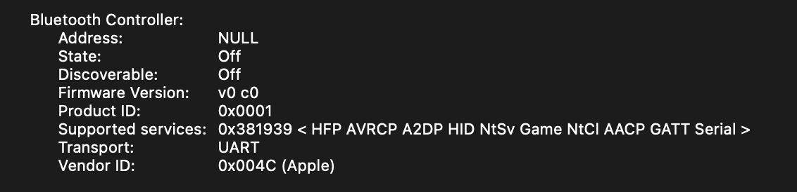

Have you tried BlueToolFixup.kext yet?
Reactions: avz
My bluetooth card is internal Broadcom 20702 which should work. I've seen it working sparingly on B2 and B3. I am going to install B1 and see if it works there. Tried BlueToothFixup.kext but didn't seem to work.
Something is off. This did work a few times, but might have been dumb luck. Going to install Monterey Beta 1 to see if it works there.
I have an ASUS BlueTooth 5 LE dongle ordered for 19.99 to see if it works.
