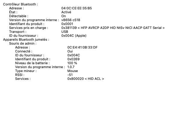

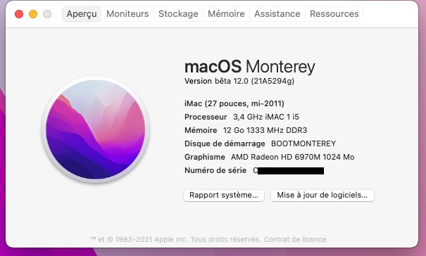

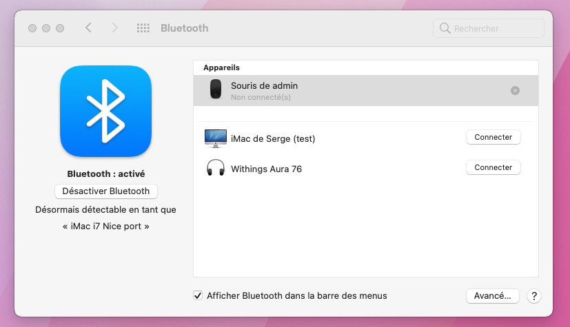

with the latest nightly build of OCLP, Bluetooth work on my test iMac 27" mi 2011 Monterey beta12 with stock Bluetooth (I haven't changed the graphics card yet, it is planned :) ) , thank very much @khronokernel and to everyone who works on it

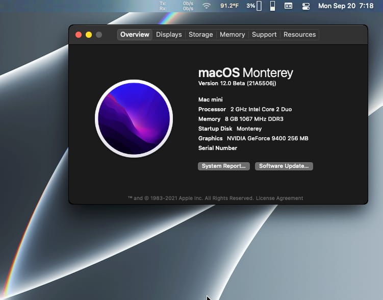

Does anyone here know if the OCLP v0.2.5 Nightly Build REALLY works on a 5,1 2012 cMP with ORIGINAL wifi card in it?
The patch seems to do something but no wifi...
Thanks

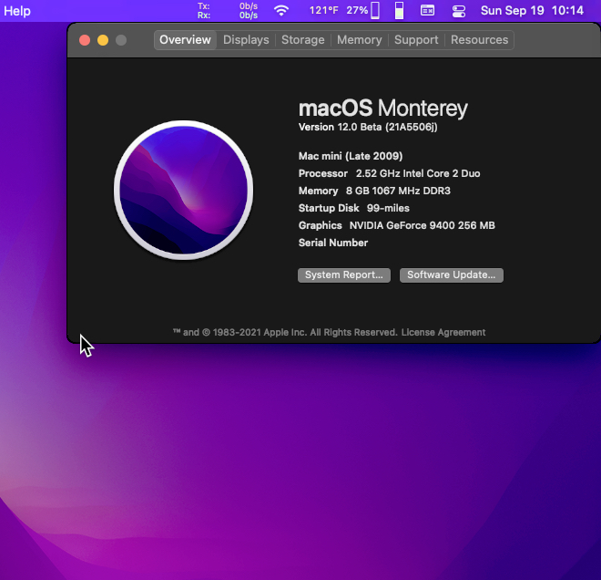

First of all, I'd take this opportunity to sincerely thank all the OCLP developers for their excellent work of supporting the old Macs so that a lot of people will continue enjoy their perfectly working hardware, and not being ended up in landfill.
Just updated to the latest OCLP v0.2.5 Nightly release for my late-2009 21.5" iMac C2D Nvidia 9400 running Monterey B6. The Bluetooth works perfectly now. But the WiFi is still not working even though the release note states the Atheros legacy wifi is supported now. The system recognises the wifi device now but can't find any SSID.
P.S. The default Photos app always crashes and not sure if it's expected. The default Apple Maps won't display any map now.
Other than that, the system seems working well.

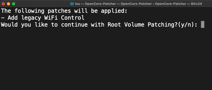

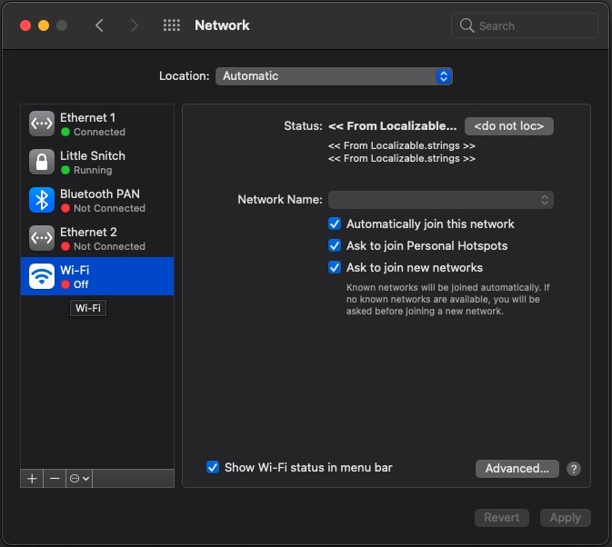

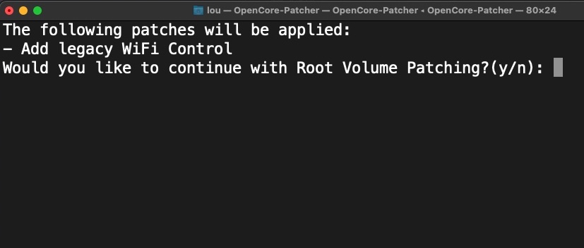

OCLP v0.2.5 Nightly Build.

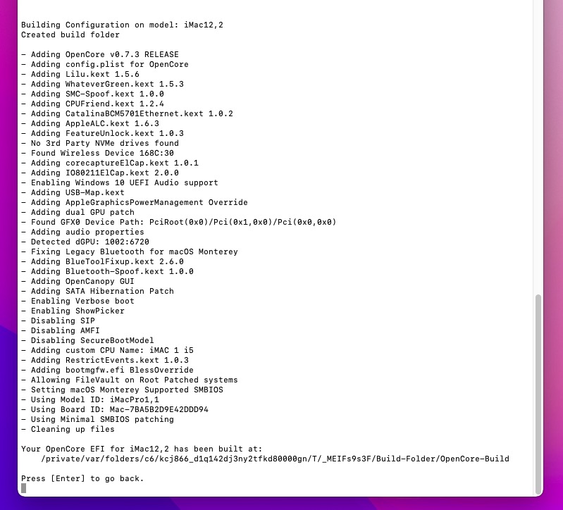

I get this after patching WIFI:
Any chance of getting the original wifi card working on my cMP 2012 5,1 in Monterey Beta6?
That's unfortunate, did you rebuild and install a new OC Build? The kext were updated to work with Monterey's new root patches. You can verify you have the new kexts by running this:
Code:
kextstat | grep "IO80211ElCap\|corecaptureElCap"
If these return nothing, make sure to update OpenCore as well from OCLP
Code:
OMGGG!!!!!!!! It works!!!!!
YOU are right! I needed to simply build a OCLP for my Monterey drive!. I was using the BS 11.6 OCLPdrive to boot from before.
Thanks you guys sooooooooooooo much!!!!!
You guys rule!!!!!!!!!!!!!
