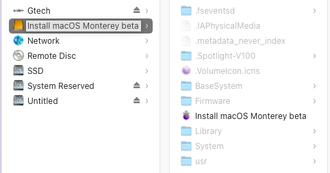

Pretty sure Software Update doesn't work because SharedSupport.dmg is not copied to the Update disk, that's the reason it fails, as with clicking on the Full installer, it creates the Installer without the SharedSupport.dmg inside the App.
I now created the Installer, see below.
Edit: Installer boots but.... It does not work.

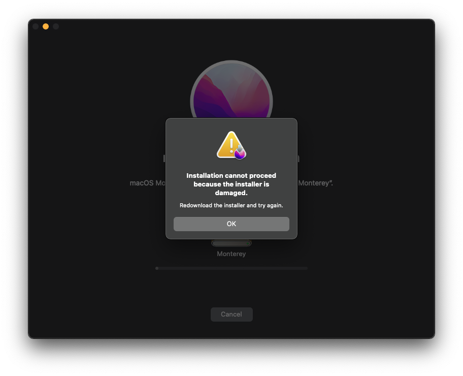

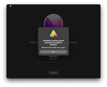

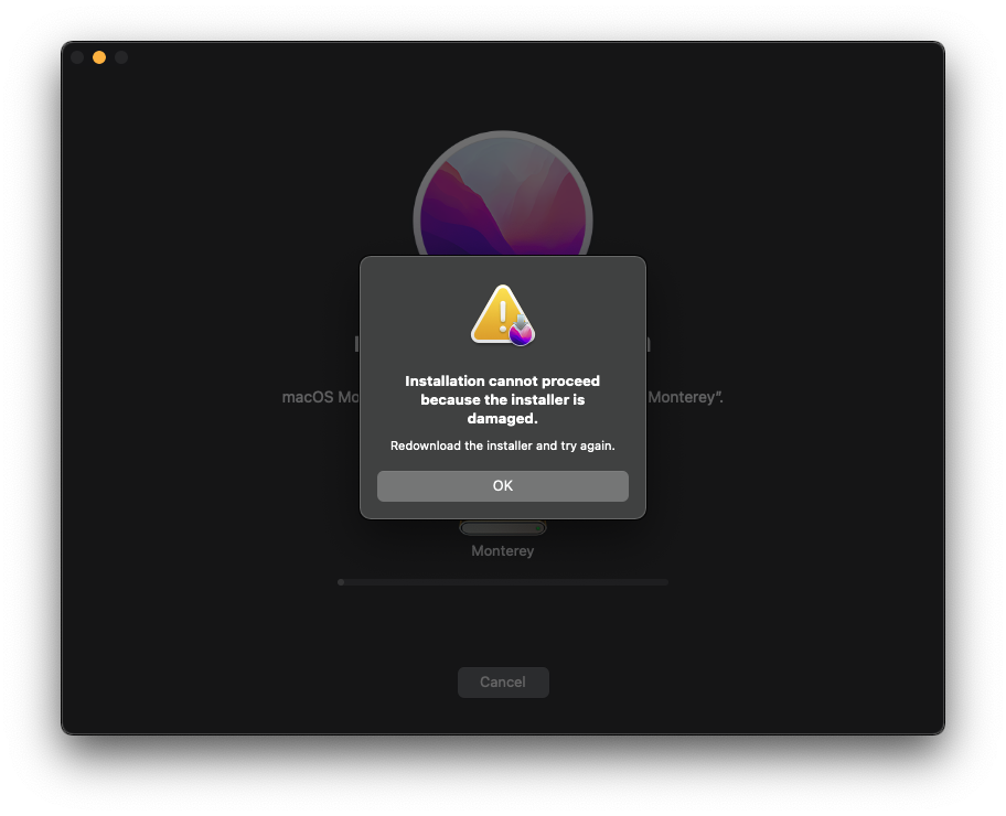

Tried to install B7 after fixing the Installer by adding SharedSupport.dmg but when I choose what drive to install on it says the Installer is damaged, Anyone else having this issue with the full installer?

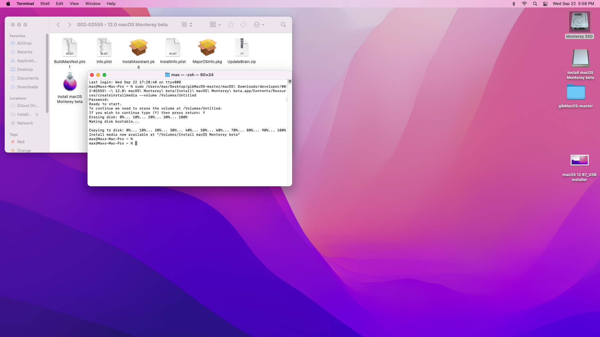

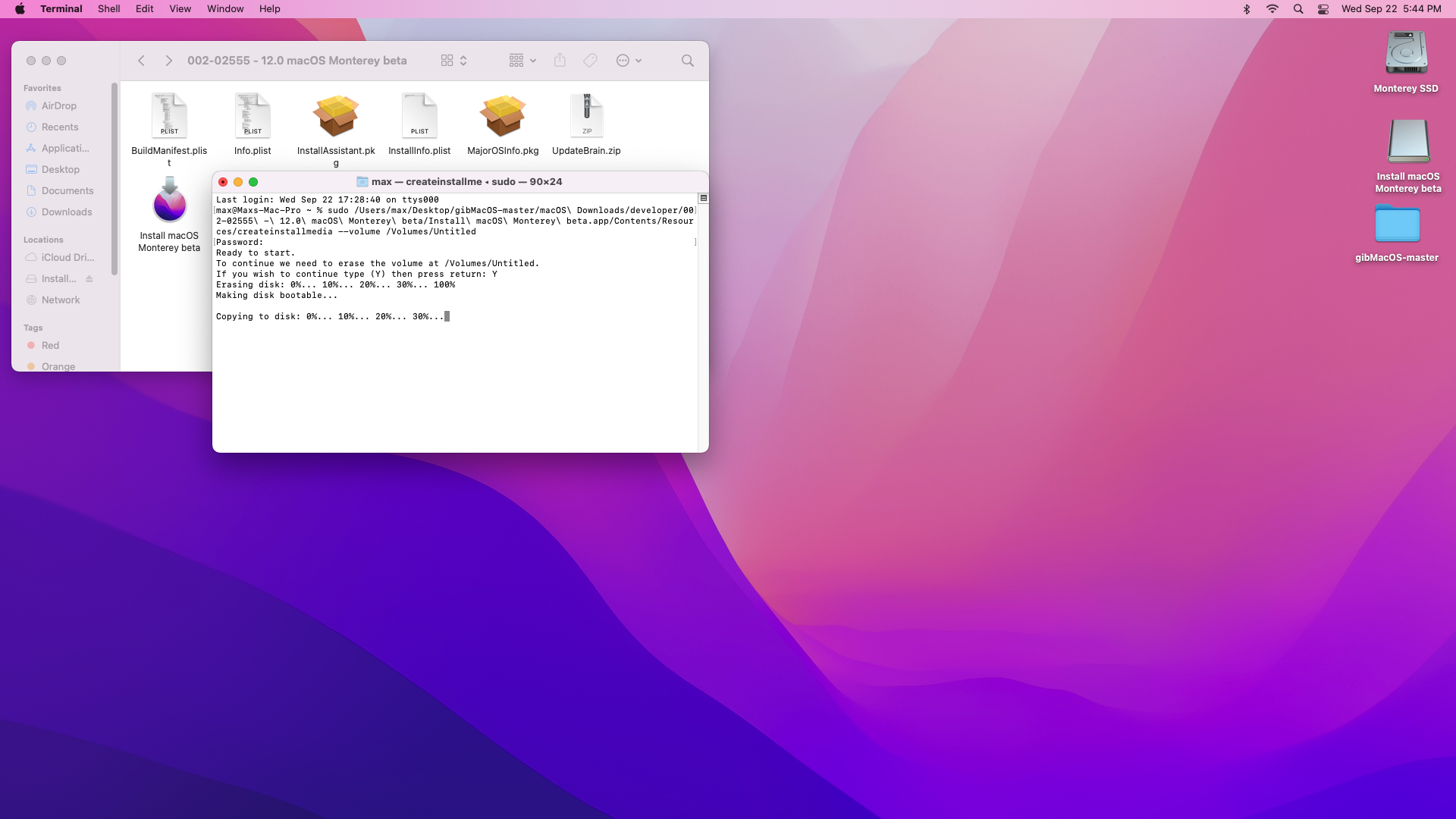

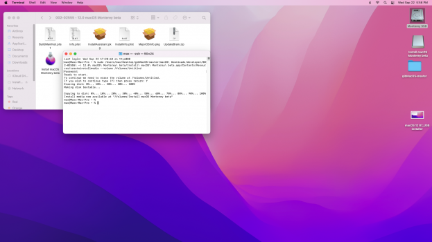

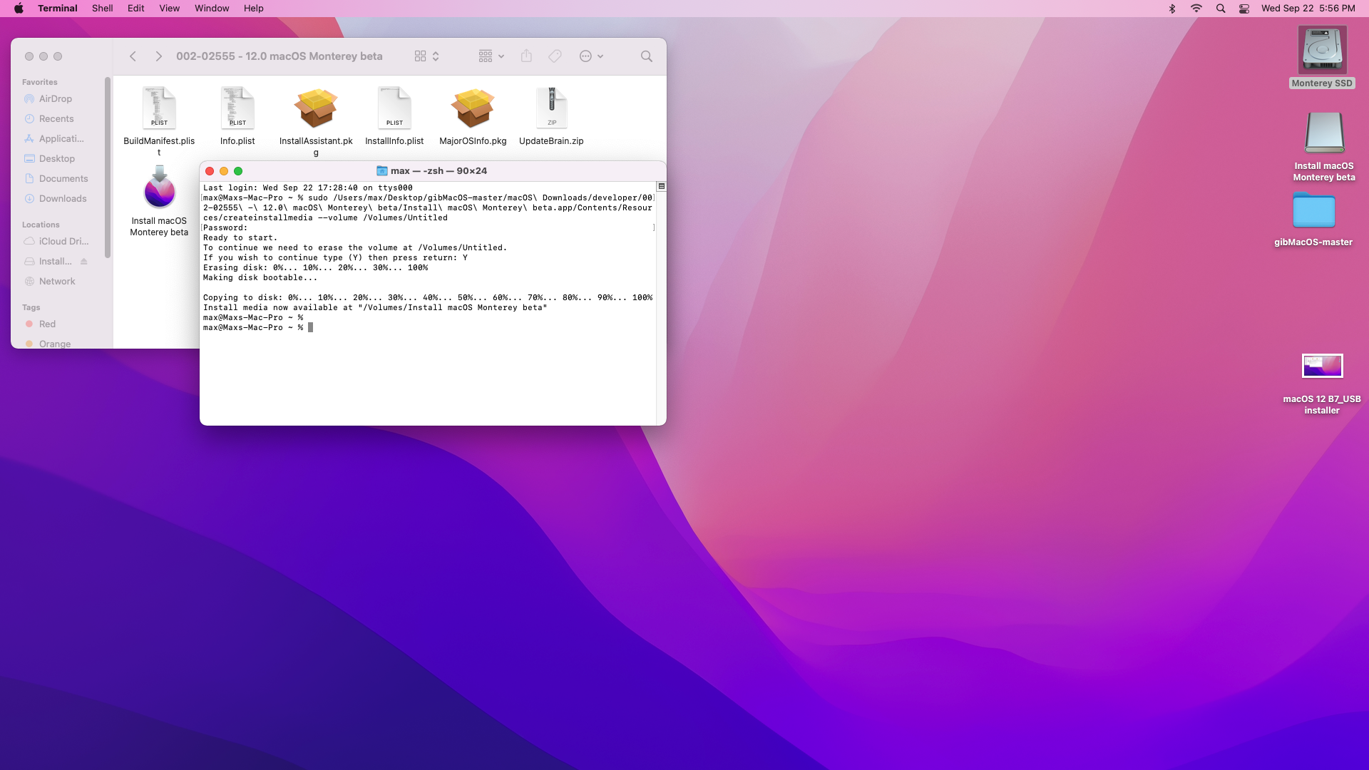

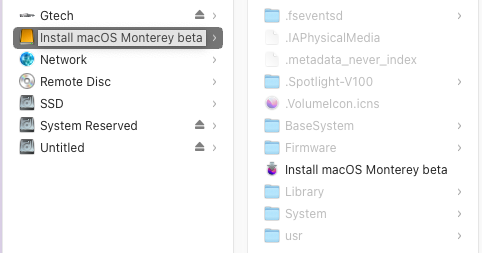

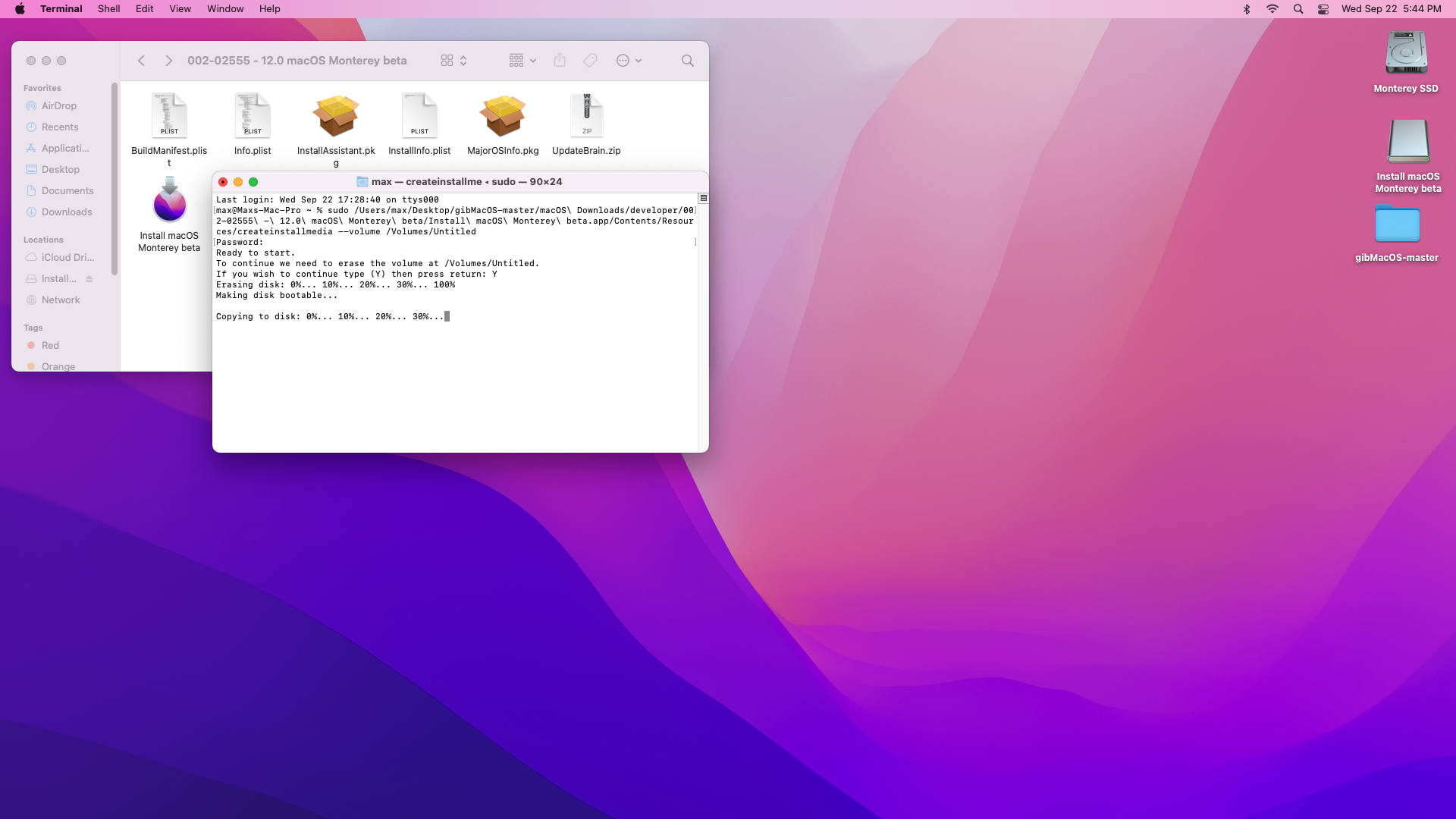

Here how to create USB installer for Monterey Beta 7.
1. Download package and installed.
2. Copy "Install macOS Monterey beta" from Application to desktop.
3. Use The Unarchiver to unzip the SharedSupport.dmg from "InstallAssistant.pkg"
4. Create folder "SharedSupport" add "InstallAssistant.pkg" in "Install macOS Monterey beta".
Now you able to create the USB Installer, see the pictures attached.
Hope this help.

So, now, after much-needed sleep, I booted again into the installer, I deleted both the Installer package and the App to have sufficient space on my SSD, I then booted back into the Installer, it booted, but as with others, it said the Installer is damaged.
Might be that the SharedSupport.dmg is in the wrong position, sadly I didn't check the old installer before I installed the new one, big sure was on it, if I knew I would have looked at the File/Folder structure.

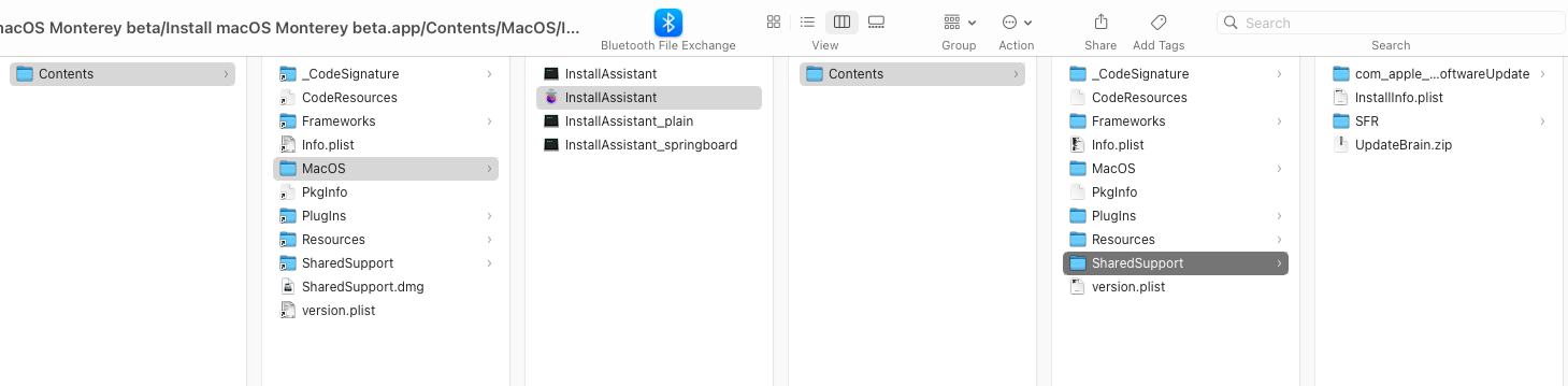

Excuse me, Pacifist is easy to use, just open the package, go to the Resources tab, you'll find the SharedSupport there.
Click on the SharedSupport.dmg, then extract to button, Top left.
This is the place where it is currently located.
Contents/Sharedsupport is a symlink to the one you see on the right.

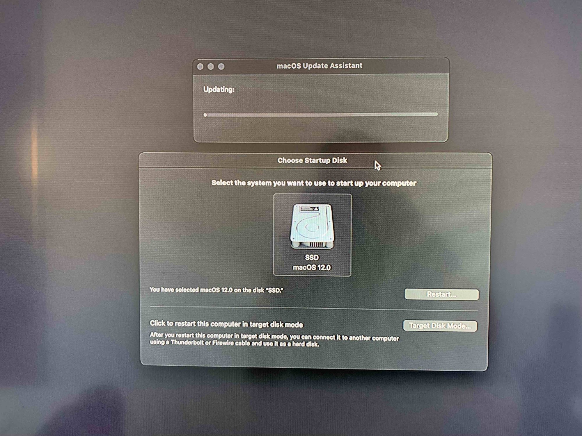

NOT, After a restart it showed a pop-up with a warning that the disk can't be verified or something like that, now I have another window, asks me to start up from which disk.
So, it failed...again.

@justperry and anyone who encountered this createinstallmedia issue, probably there is a bug on that apple package even if they enforced some firmware or packages verification, but since beta 1 I used another method, that is through any previous already made "Install macOS Monterey beta" replace only the SharedSupport.dmg , it even worked with beta 7 and recently ASentientBot found a method to copy very quickly the SharedSupport.dmg that consists of renaming the InstallAssistant.pkg to SharedSupport.dmg, they exactly match without unpacking and without occupying extra disk space, you can simply check the validity double clicking the renamed InstallAssistant to dmg.
If you have an USB Monterey installer, just keeping the stock label for the installer and on Downloads folder the current InstallAssistant.pkg , I made a simple script for that: MontereySharedSupportfix
