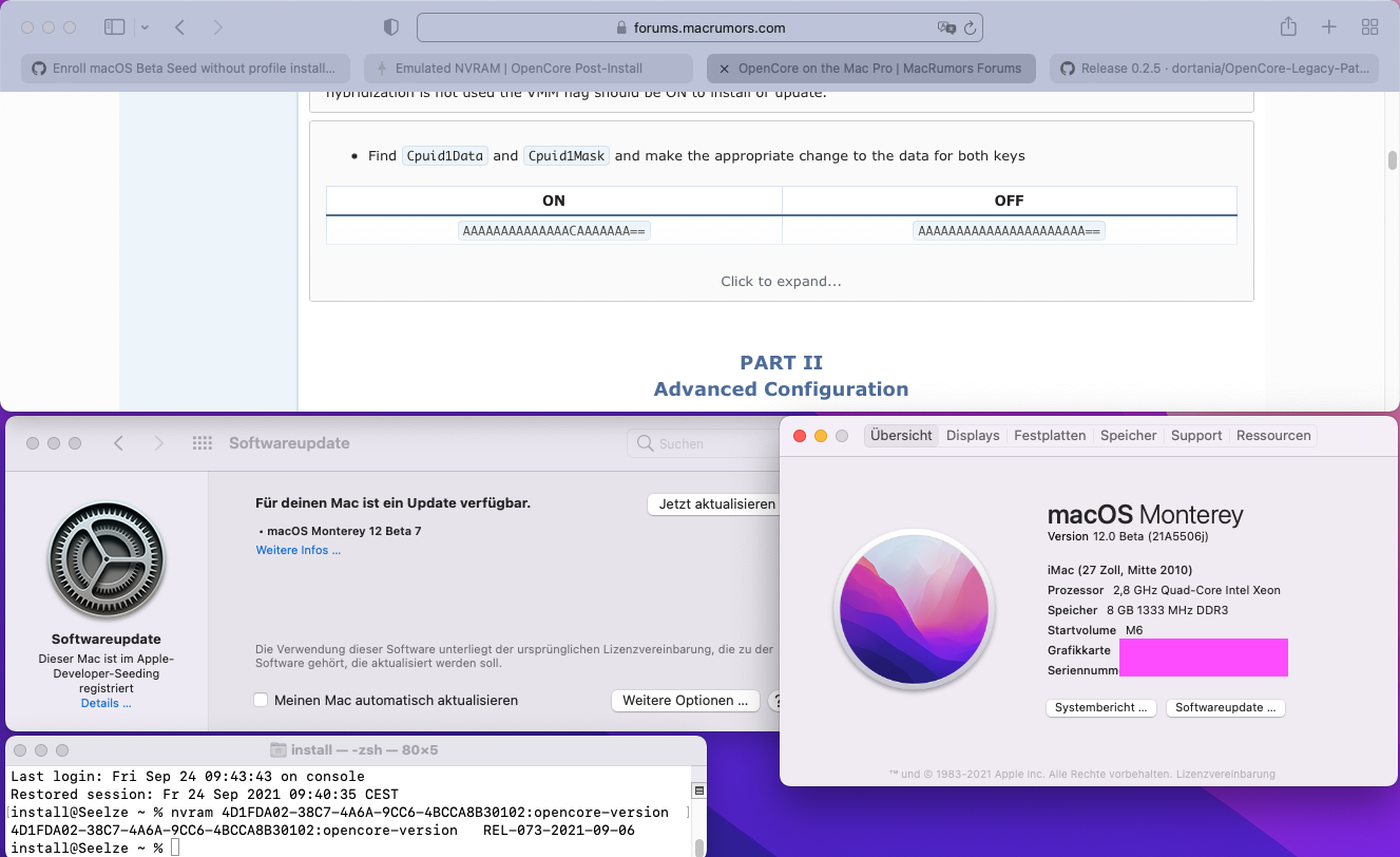

Even using the latest OCLP 0.2.5 my iMac11,2 and iMac11,3 still cannot see the OTA to B7 when starting from an older version or Monterey. It will not be offered by software update at all.
Only by setting the Cpuid1Mask and Cpuid1Data the update becomes available. The newly added FirmwareFeature settings do not harm, but do not help either (checked to both ways with or without those).
Cannot tell you right now if this is an iMac11,x specific problem, did not test the iMac12,x family. Waiting for other users to report their experiences.
EDIT:
  1. MacPro5,1 users were able to update to Beta7 using the iMacPro1,1 SMBIOS and the VMware flag in the same way. So this confirms my observation.​
  2. OCLP iMac 2012-2013 users with the iMac17,1 SMBIOS can obviously update directly (but the EFI/APPLE is filled with SMC and Firmware update files, you man safely delete these). Unfortunately not all Mac owners can simply change the SMBIOS to iMac17,1, it works for (some) iMacs.​

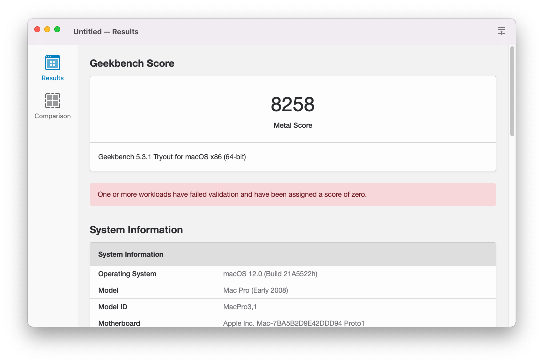

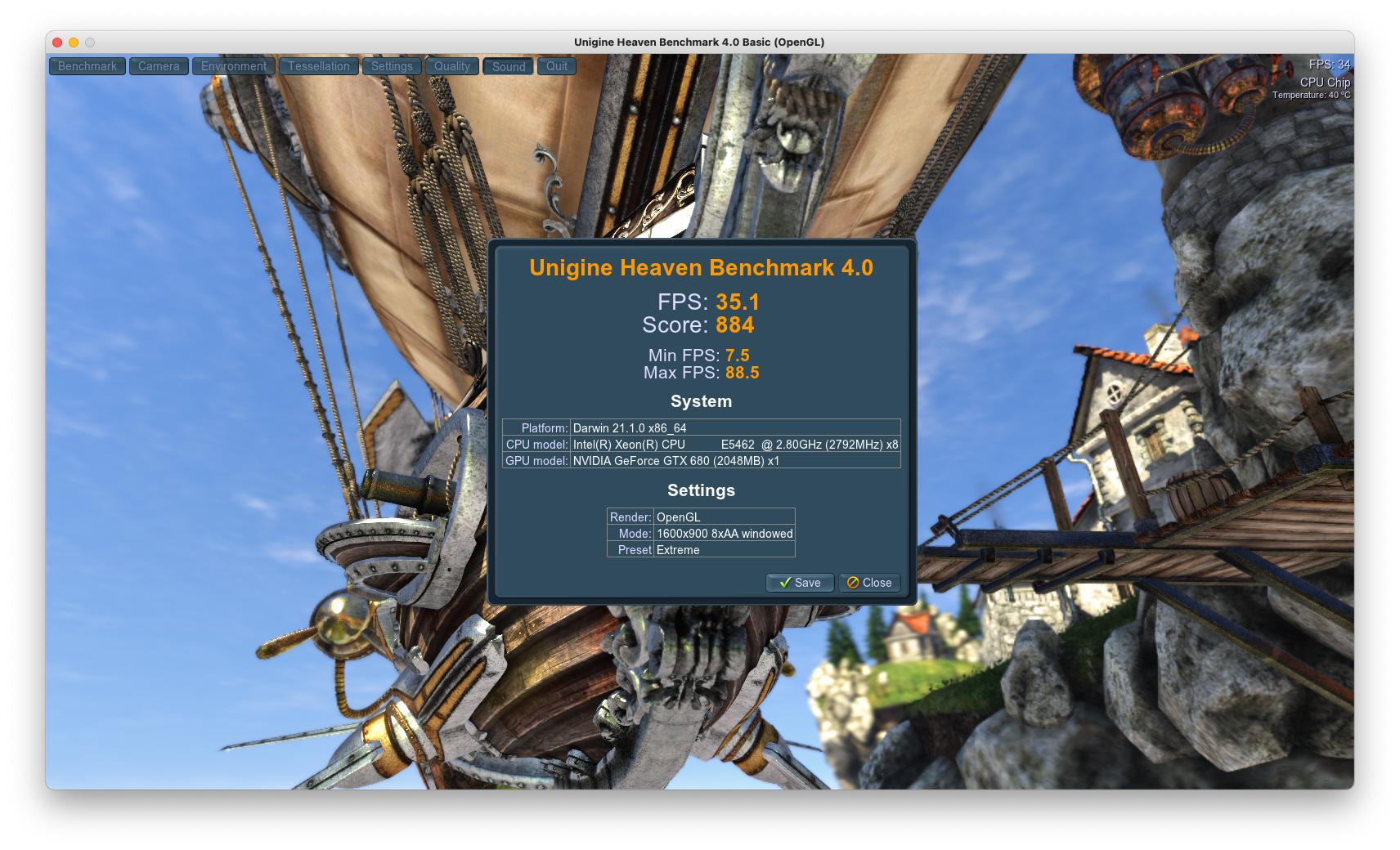

Hi to All again!

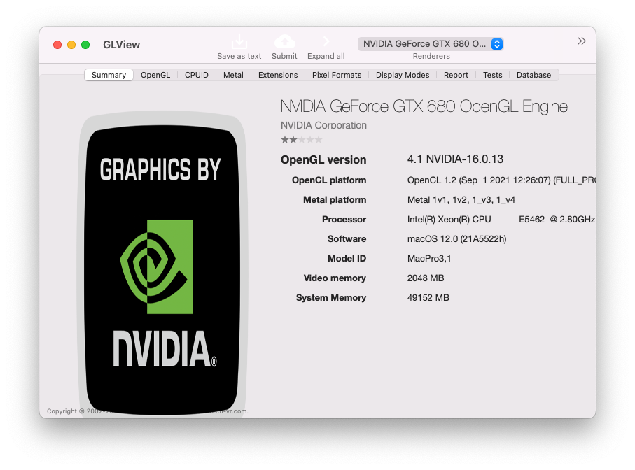

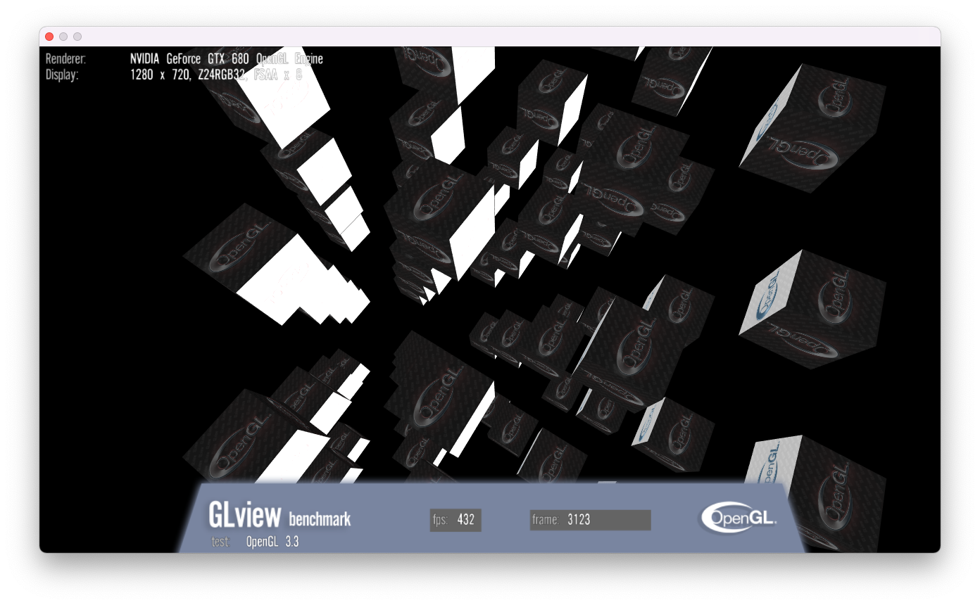

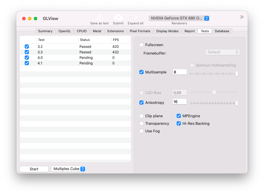

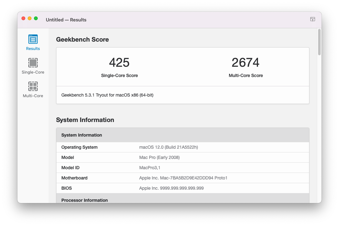

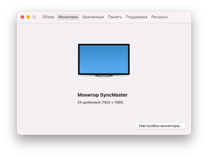

Updated my old fart CMP 3.1 from MacOS 12.0 Beta6 o MacOS 12.0 Beta7 by OTA update from Regular Update Channel. Applyed system volume patch to System Volume for keppler GPU.
OCLP 0.3.0NB
Issues - it's damn slow! =)
Update process in attached video (RU, ENG titles will later)

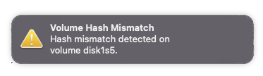

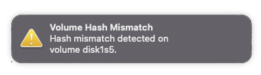

Has anyone ever received this message?
I use Monterey Beta, which is patched with OCLP. (MacBookPro11,1)
It works comfortably for four or five hours without any problems, but that message begins to appear a few hours later.
And some apps (especially safari) go out of order, and the os becomes unstable. (Control center, date area disappears, or some settings cannot be accessed from the Preference app, etc.) This problem is completely resolved by restarting mac and repeats the message appearing few hours later.
I wonder if this is the issue of Monterey Beta itself or the issue of Monterey Beta patched with OCLP. Is there anyone who is experiencing this problem or who knows it well? (+ Is this likely to be resolved with a future OCLP patch update?) Thanks for developing a good patch :D
(Google Translate, please understand)
Reactions: Ausdauersportler
Yes , happened to me , even with Big Sur. It just work if it is a clean installation and you use it before creating any account., before entering in the OS for the first time.
Yes, it was just as you said ******* also in my case.
I‘m using clean installs very infrequently, wasn‘t necessary for Monterey which could be installed over a complete (including migration) Big Sur.

I had this and had to start over to make it right.
Sorry I couldn't help more
Reactions: qlita42

Try a different browser for a day, see if it persists.
There's a page for this subject on Apple's website, there are no real answers there, just the suggestion to use another browser.
EDIT: The post below has a "fix"
Methinks though it is hardware-related, or the index is messed up due to hardware failure.
Test the disk with a different app than apple's provided one, for instance,
Smart Utility.
Reactions: qlita42

Yes, we saw this with Big Sur, too. Unfortunately the core development team of OCLP did never experienced this and so no one was able to debug it.
EDIT:
The only cure is using sudo purge in terminal app when things start to go wrong. You might even use ssh to enter the command when you cannot start new apps any longer like the terminal app.
