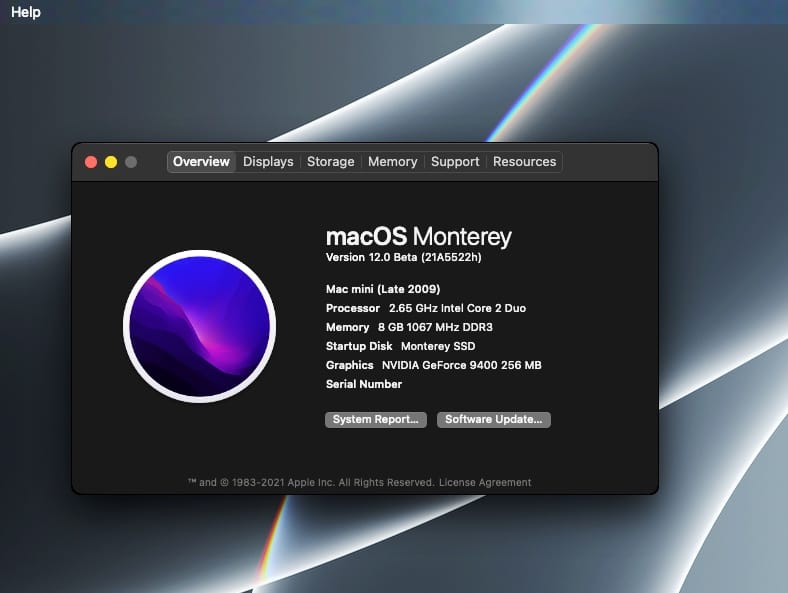

Made perfect installer USB on the first attempt! This script is impressive work.
The result booted with the lastest OCLP Nightly onto this primitive Mini3,1, as it was intended. 😉

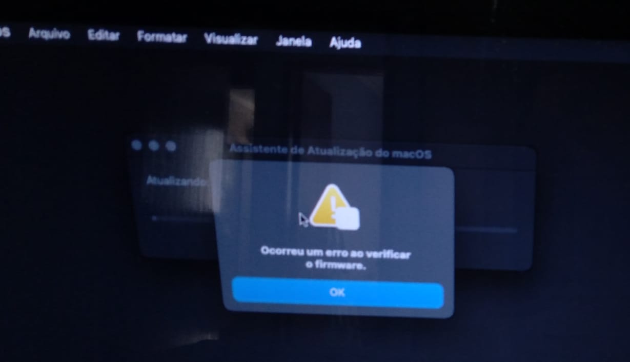

have problems installing monterey beta 7 always a error while verifying firmware
Same thing here.
OCLP 0.2.5/0.3.0 - Macbook Pro 13'' 2010
"There was an error checking the firmware"

we’re you updating thru software update or USB installer? I had that same error with OCLP 0.2.4 but 0.2.5/0.3.0 fixed it.

None of my legacy machines (see signature) can be updated with the USB stick (ofc with the contents of SharedSupport added). For all, the error is the same as reported by @PDias. Tried with 0.2.4, 0.2.5, older and latest 0.3.0 nightly.

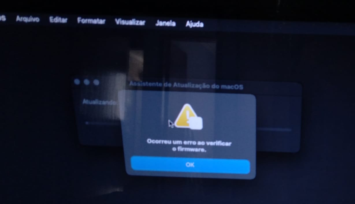

Same thing here.
I tried via USB installer and also using the installer created by installassistant.pkg and still the same error occurs.
Same here. Got "Error checking the firmware" in 2nd reboot. Also checked with OCLP 0.2.5.

I was successfull updating from B6 to B7 using the self prepared installer app from the desktop and from USB pen drive using the iMac17,1 SMBIOS (the others did not show the update available). After that update I had a bunch of firmware and SMC update files within the EFI/APPLE folder. It is unknown to me why the iMac17,1 SMBIOS was the one showing the B7 updates without other OC hacks.
After that I installed B6 again and succeeded with iMacPro1,1 SMBIOS and the VMWare trick, again. This time without the firmware files left in the EFI partition.
EDIT:
The B6 OTA update was difficult, I had to use the iMac19,1 SMBIOS to get it done. I am waiting for B8 to be published and will not waste or spend any more time into exploring what other install options might be possible.
After that I installed B6 again and succeeded with the VMWare trick, again. This time without the firmware files left in the EFI partition.
Exactly, I also earlier noticed on cdf OpenCore thread that method, only limit of Virtual machine spoofing is that requires a cpu mask that supports the VMM hypervisor, hence not supported by any Core2Duo Penryn (and probably Arrandale too) but surely as you mentioned there are other methods to update to beta 7 , I also found another one but not sure yet to advise it, stage2 installer will continue but I need to test it on beta 8 to make sure that no firmware smc attempts are issued, because as you wrote, I don't know the behaviour of firmware files scheduled on the EFI disk.

The only thing I would suggest is to update/Install OCLP to the startup disk, next shut down instead of a restart, hold the Option key when you start up (No restart) again, choose the EFI disk, next chose the Installer, this resolved it for me, the standard startup (Restart) without holding the Option key and let it automatically choose the disk did not work for me.
I could not get USB method to work, what did work for me was adding the SharedSupport to the /Applications/Install Monterey.../... path (not USB), shutting down (not restart), holding Option key to select EFI (OCLP, ver 0.2.5) and letting the install do its thing. I did not redo the Option key way on subsequent reboots throughout the installation process.
