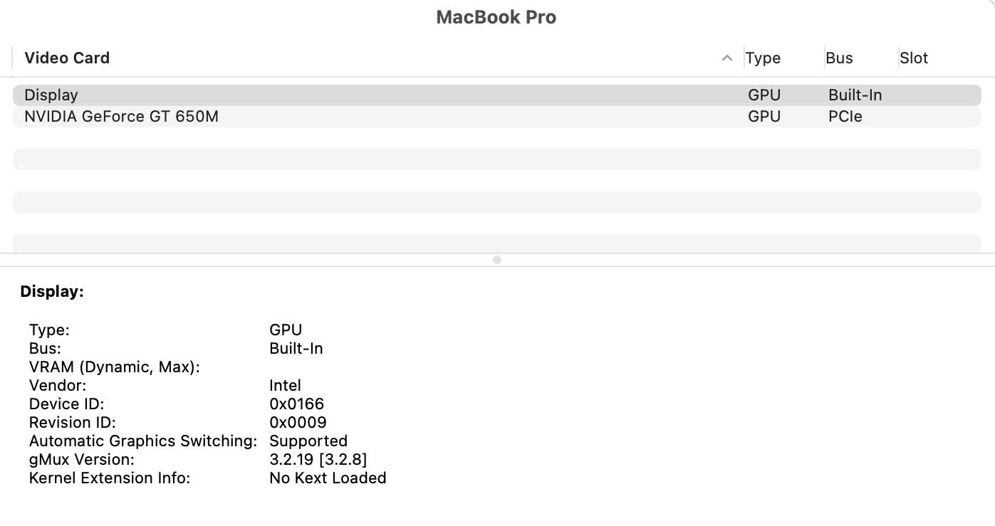

Does dynamic switching of GPUs work with or without disabling displaypolicyd?
Haven't tried it. I have not noticed any change in this function from Big Sur. System report shows both GPU's:

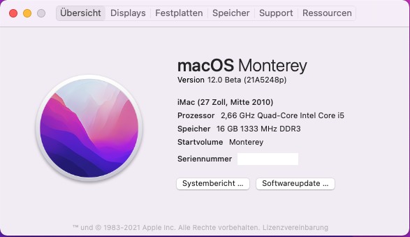

iMac Early 2009 ✅

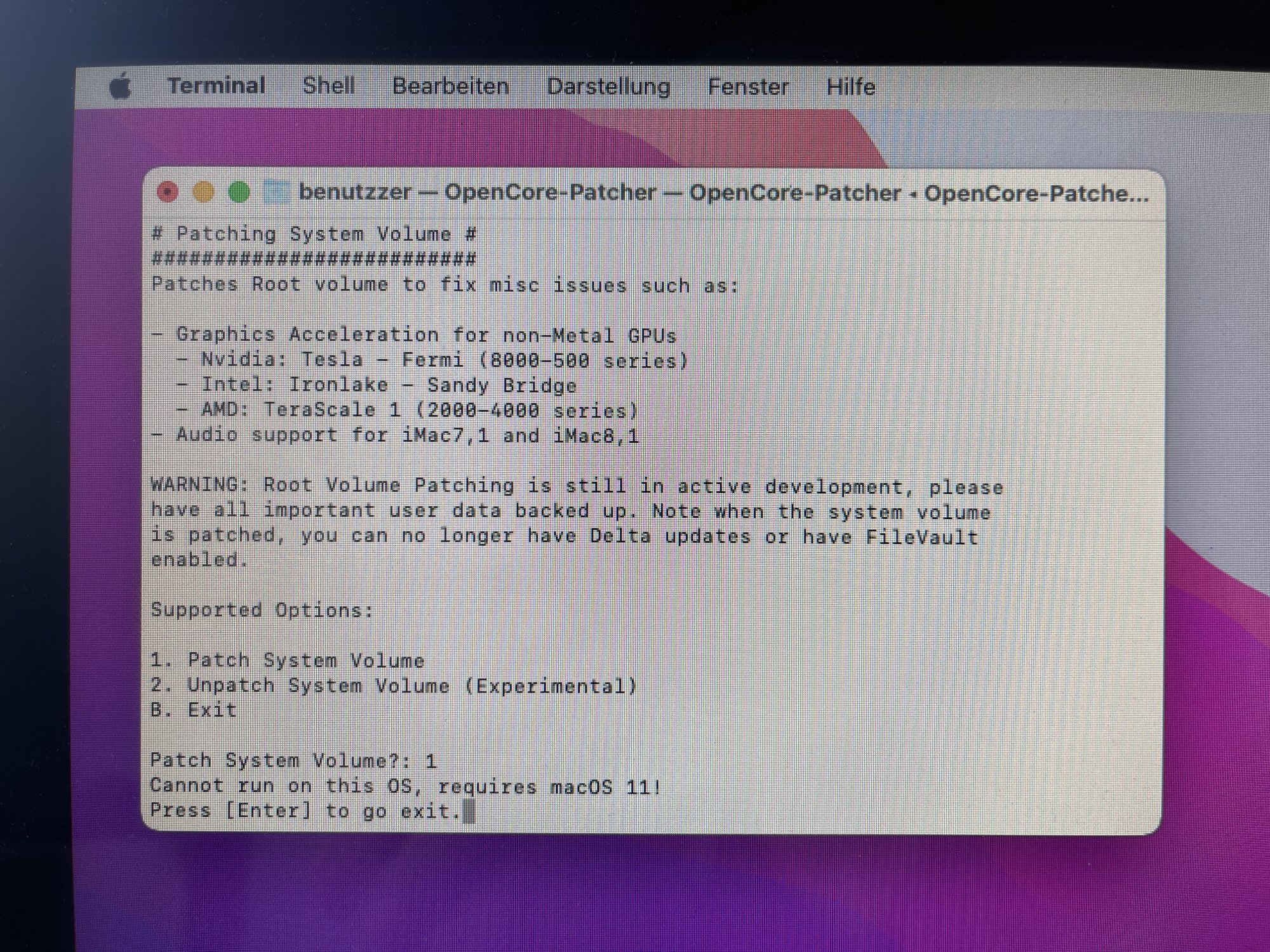

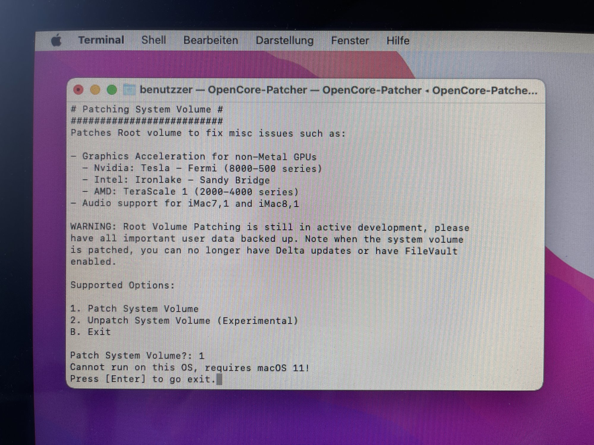

Only Need patches. OCLP says „Only in macOS11“. Has any1 an Solution ?
This is a minor cosmetic issues. Until yesterday the complete tool has only been used with Big Sur, but it turns out it can be used in the same way for Monterey.
More important will be if patching works. Just give it a go! (EDIT: patching may fail)
