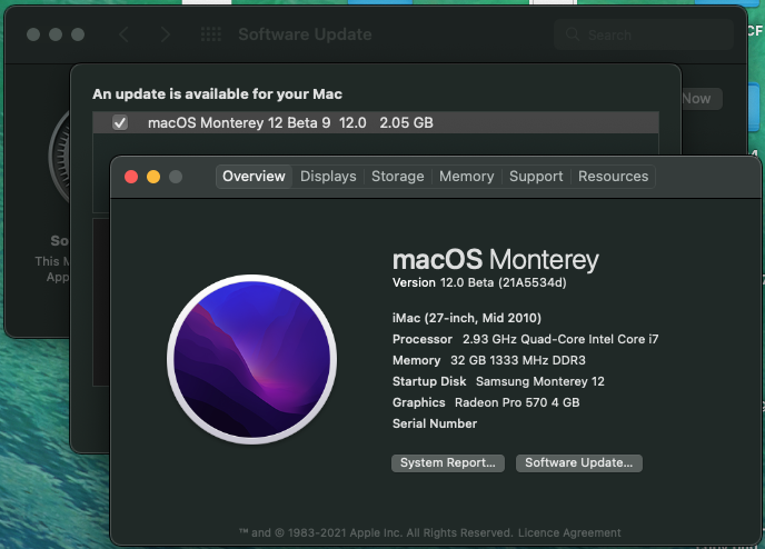

Apple released beta 9 to developers today. I wonder if it helps with performance at all

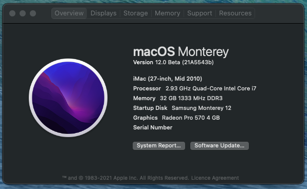

Beta9 OTA succeeded using the VMM flags manually added to OCLP 0.2.5
Update is found at my System Preferences, but it's full 11 Gb, not Delta one. It happened for the first time since Monterey on OCLP. Yes, I remember that it's normal on patched system volume but... during update to Beta 8 I was offered with Delta, though volume was already patched.

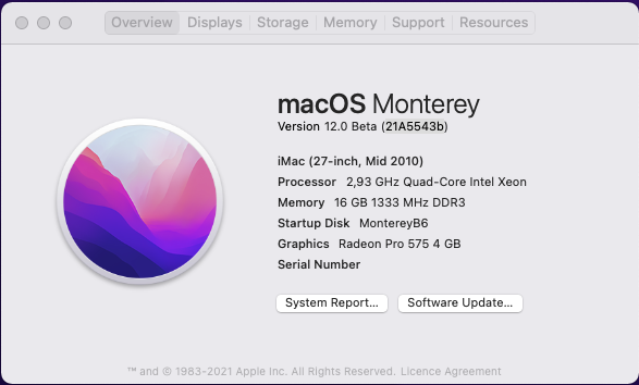

I´m gonna try Beta 9 in my Mac Pro 5,1. Beta 8 was imposible to install, video problems.

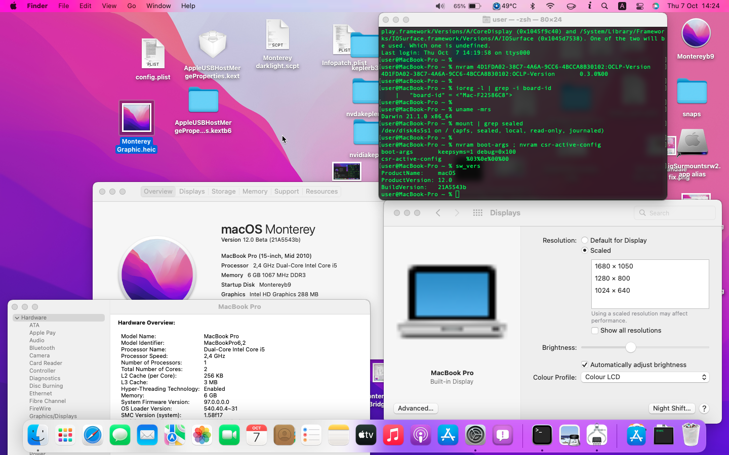

Updated MacBookPro6,2 correctly using OCLP VMM edition (hence without spoofing firmware and smc versions) from beta 8 to beta 9 , since it's a non metal acceleration Mac the panel prompted the full OTA 11,01 GB , here are the phases I encountered (downloading time excluded):
- Preparing OTA update (directly from desktop) estimated time 35 minutes but took instead twice
- Auto reboot OTA stage1 SU x86_64 ramdisk took about 15 minutes
- OTA stage2 not shown minutes remaining but took about 30 minutes
stuck on stage2 with full loading bar then forced power off and reboot with CMD+V this showed that stage2 correctly proceeded with mainly these verbose:
patchd Checkpoint begin macos_install_recovery
Ramrod_display_set_granular_progress_forced : from 23.000000 a 100.000000
- auto reboot weirdly to the Recovery BaseSystem which completed a loading bar showing only the apple logo and mouse cursor
- auto reboot outside to the BaseSystem with direct boot to desktop
- first login after update took about 10 minutes
anyway everything worked as expected, so I guess the new OCLP VMM is a reliable and advisable method to update and install Monterey.
I add that apple recompiled all core system files on first October and as some already reported with this beta 9 (build 21A5543b) they also added 8 dynamic wallpaper pictures for the vectorial Monterey (attached with reduced quality as example), so maybe this time they might not add a dynamic landscape photo as default desktop.
