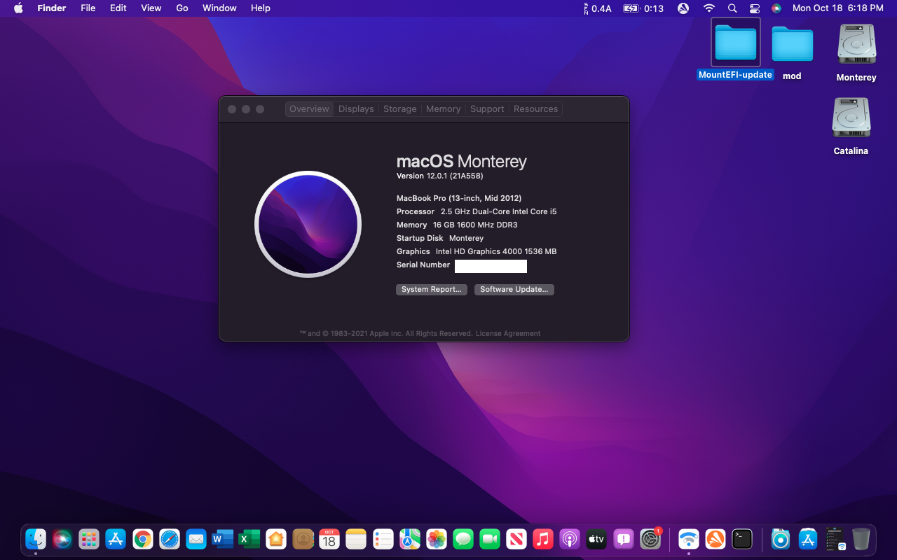

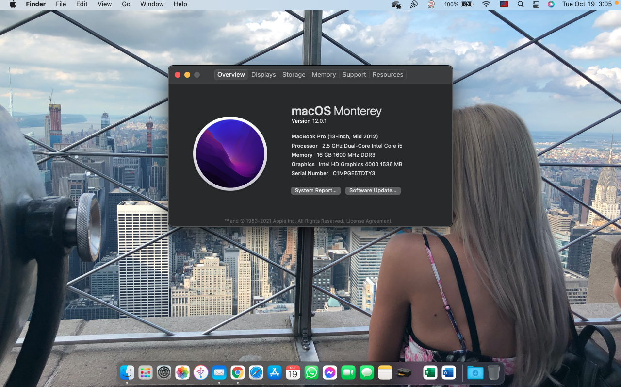

Hi guys, just finished installing on my MBP 9,2 mid 2012 non-retina the new macOS Monterey 12.0.1 using OCLP 0.2.5 from OTA and besides getting stuck, after numerous reboots, at apple logo half way for a long time, forcing me to do a hard reboot, after which all went ok (two more reboots and a smooth restart). Installed the HD4000 patch and all working perfect! Smooth and fast! Thanks everyone for the support. By the way, proud to say that I have placed my order of the new MacBook Pro, 14", with M1Max, 32 Cores, 64 GB and 1TB SSD in silver! It says it will be delivered in about a week. Can't wait!

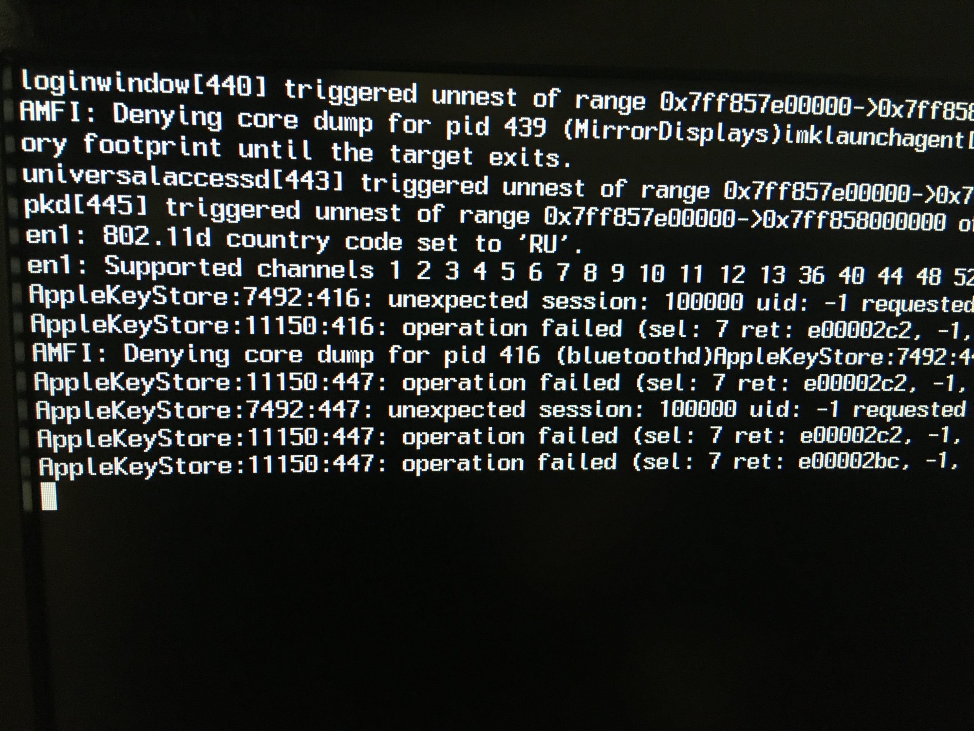

I confirm, system volume patch - fatally breaked successfully apdated MacOS 12.0.1 (OCLP 0.3.0NB). On my MacMini 3.1 (late 2009)
System breaks on loginwindow

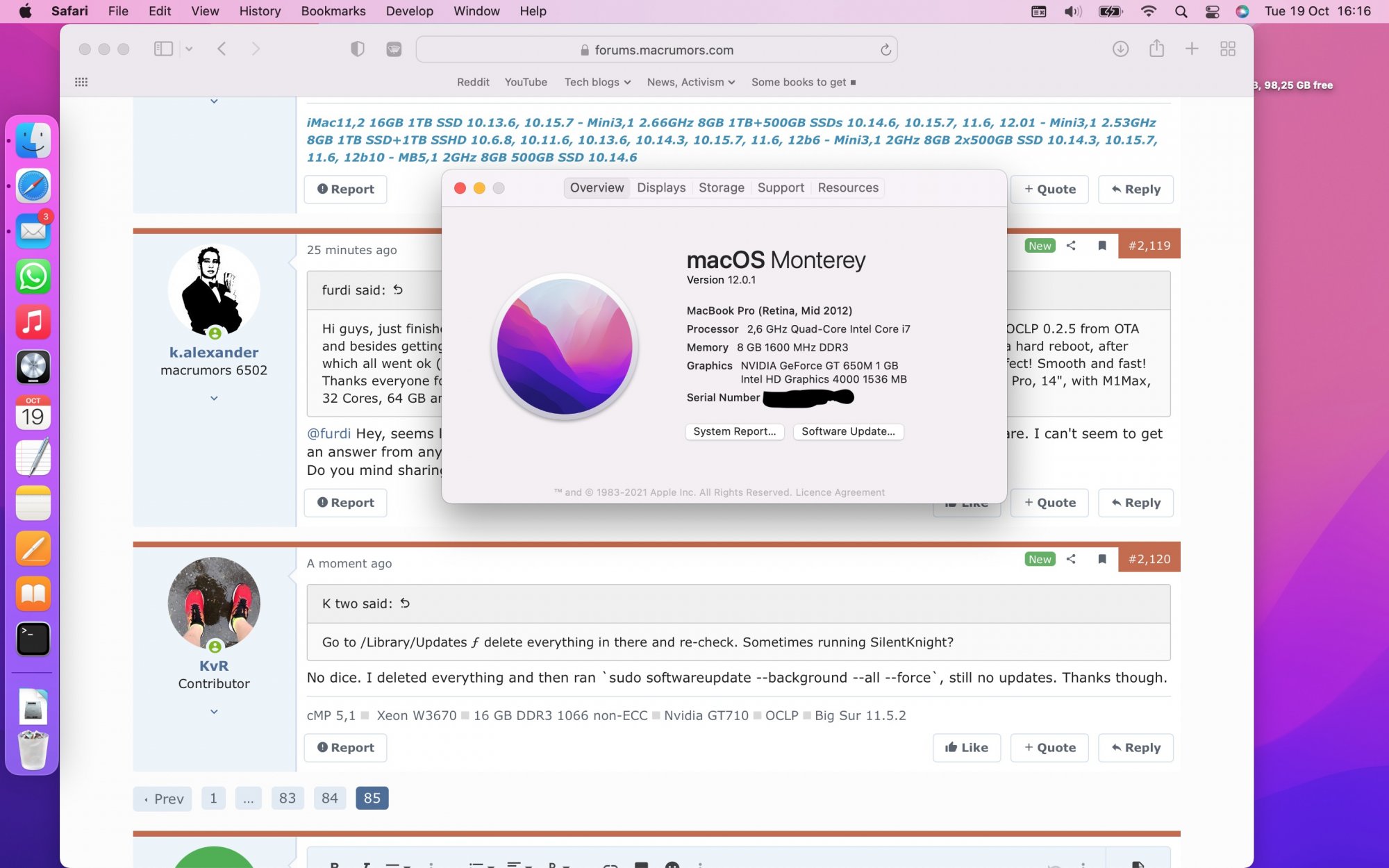

Even my officially supported MBP only found it on the fourth check, lost it on the fifth, found it again on the sixth.
Installing 12.0.1 on the MBP12,1, the MP5,1 still isn't seeing it (even with VMM flag on). I'll give it time.

Updated to rc and running perfectly I hoped to get 10 years out of my MacBook Pro 2014 and I it’s still running great thanks to everyone that supports these updates. Out of interest does anyone know if the same patching method would work on M1 macs when they become unsupported? Thanks again.
The same patching method definitely won't work on M1 macs, unfortunately. OpenCore (and so OpenCore Legacy Patcher, which is built on OpenCore) is based on UEFI which M1 macs do not have.
