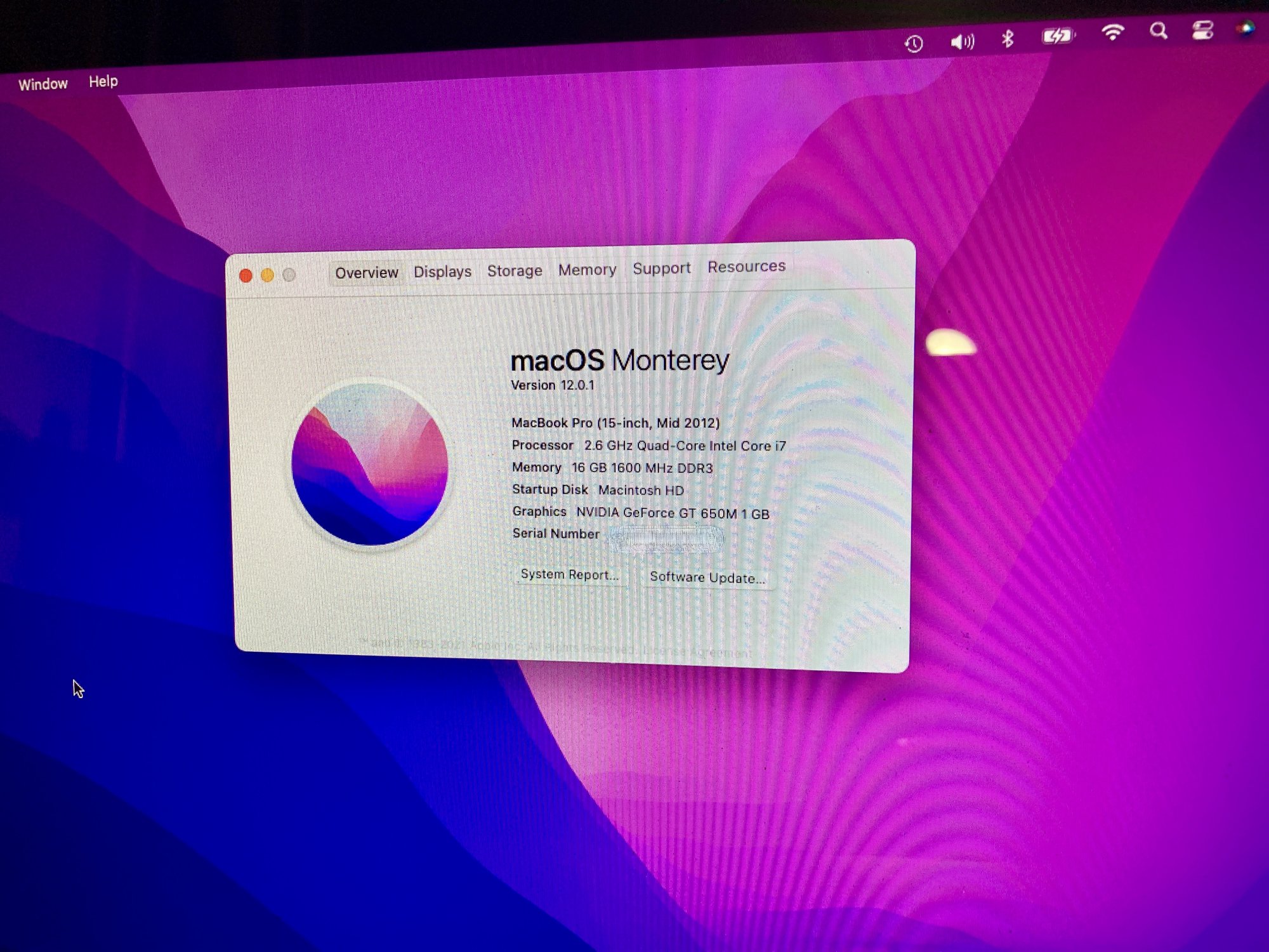

Well, the installation has been successful on my 2012 15" unibody MacBook Pro!
I even configured the system using the OpenCore patcher to boot without need of the thumb drive and to automatically go right into my Monterey install! Now to update iMovie, GarageBand and the Pro Apps...

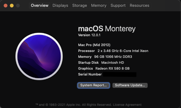

I should report on how my Monterey 12 upgrade went with my Mac Pro 5,1. (You can see my specs in my signature block and attachment below--2012 Westmere Dual processor system--LOVE this thing!)
Initially had a micropatcher install of Big Sur 11.2.3 (no OC), as it was just easier to boot directly from the macOS screen. I physically took the WiFi and Bluetooth modules out of my Mac Pro, as I wasn't using either and upgraded to a Broadcom Bluetooth 4.0 USB dongle which worked just fine. (I use Ethernet for Internet connectivity.) I was able to install 11.4 without Latebloom (don't know how), but eventually the infamous racing issue started off and on once trying to upgrade to 11.6. (I had to disconnect external devices during boot just to get it to work--worked 80% of the time.)
Because of this, I decided to create a new installation for Big Sur 11.6 using Opencore 0.7.4 along with the SurPlus fix for the infamous racing issue. I nuked two hard drives clean for the install and followed the instructions to a T. It installed without a hitch on my system, and Big Sur 11.6 launched everything as expected... OC is a lifesaver and is buttery smooth! Can't believe I didn't do this sooner. Then decided to take the Monterey 12.0.1 plunge with Software Update.
Everything installed as expected, and my system booted up within an hour after a few standard restarts. Comes up like a charm! I didn't run into any random restart issues or hangs, but also, I did the upgrade on a clean install of macOS Big Sur... might be worth considering.
Personal Note: If you have a separate hard drive: Consider moving your user folder to that drive. 10x easier to move your stuff, AND your settings stay intact.
