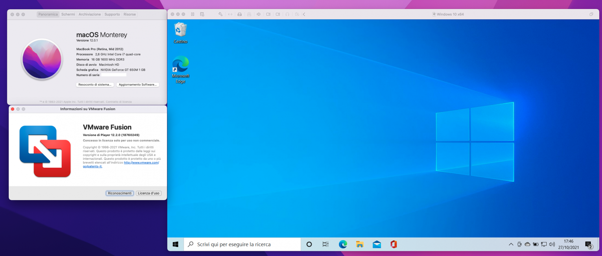

I try vmware fusion 12.2, it's can't open any vm. my model is macbookpro 10,1
Hey,
on my MBP 10,1 I'm able to run a Win10 virtual machine using WMware.
When I started it for the first time after macOS update, I was asked whether the vm was copied or moved. I didn't do anything, I assume that installing Monterey on Big Sur made it look like it was changed somehow. So, I clicked "copied" as suggested.

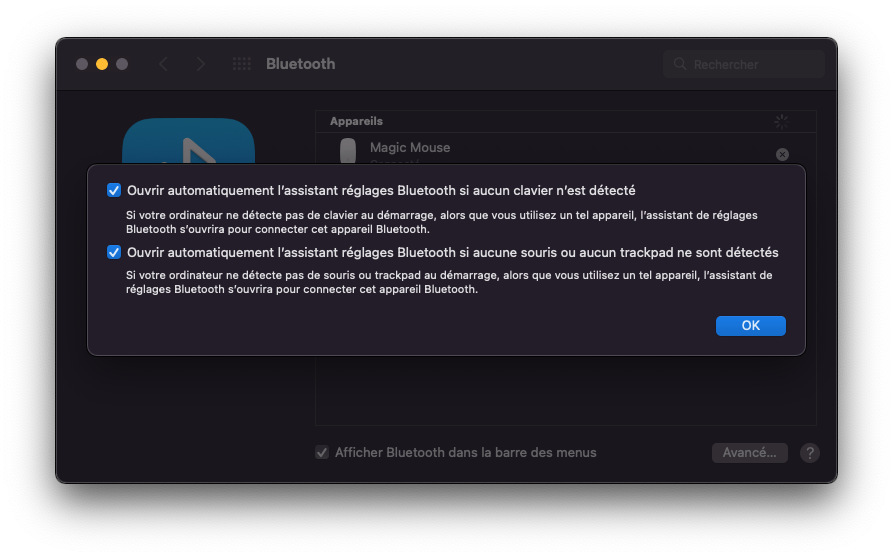

Monterey 12.0.1 successfully installed in cMP5,1 with OCLP 0.3.0 and running fine except for one thing, am I the only one who doesn't have the "Allow Bluetooth devices to wake this computer" option in Advanced Bluetooth Preferences (like in Big Sur and others before)?
I didn't have this option in all the Beta versions and I thought it would be there in the final version but no.
So I can't put cMP to sleep anymore because my cat likes to walk on the keyboard and mouse at night... and I find cMP awake almost every morning.
Does anyone know a Terminal command to disable this missing option?
Or a key to set to false in Library/Preferences/com.apple.Bluetooth.plist?
I've done a lot of research on the net on this subject but I haven't found anything useful.
