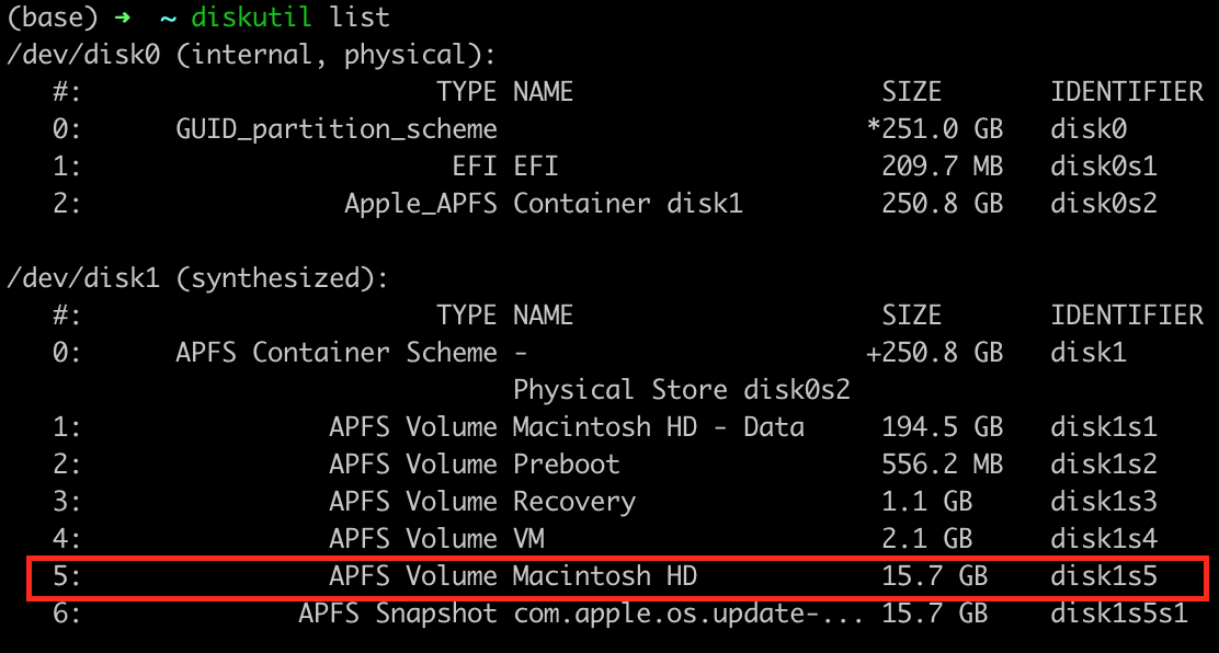

Hi all,
I successfully installed 12.0.1 on MacBook Pro 11,1 - Retina (Late 2013), Intel i5 with iris Graphics and 8GB RAM.
The steps on OpenCore were extremely clear. Thank you for such a wonderful tool.
Live text, airplay, etc work perfectly fine.
However I just got the following error:
Hash mismatch detected on volume disk1s5. MacOS might need to be reinstalled on this volume.
is there a fix for this?
If there isn't, would downgrading to Big Sur result in dataloss? (would want to avoid downgrading because Monterey seems surprisingly faster than Big Sur)

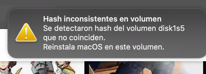

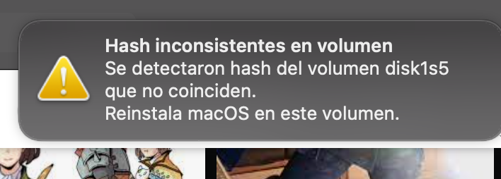

Macbook pro 2014 13 inch in Monterey beta 10 and open core 0.2.5 works fine until the notification "inconsistent hash in the volume: There has been detected hash in the volume disk1s5 that does not coincide. Reinstall macOS in this volume", then the brightness of the screen and keyboard becomes almost irresponsible
(Sorry for the screenshot in Spanish)
Hi! Same problem here, It seemed that everything worked fine but after one day I get this. Any solution? Macbook air early 2014. OPCL version 0.3.1
Thanks

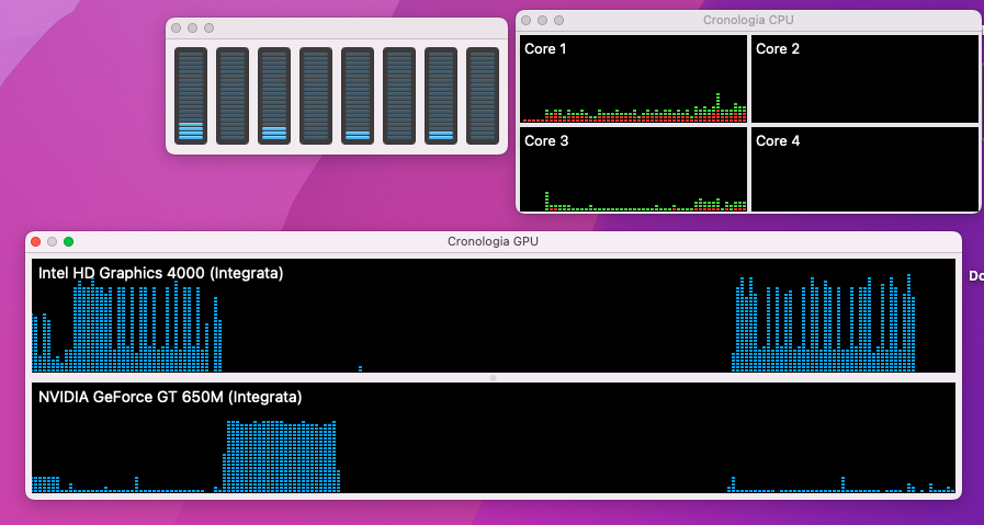

Since upgrading my mid 2012 MBP from Big Sur to Monterey using OCLP and running the post install patches, I've noticed a near doubling of my CPU temps. They now sit consistently between 55c - 60c even under light cpu load. Has anyone else with similar hardware noticed anything similar ?
Yesterday mine ran with the fans going for most of the day. It has now stopped, no fans today. I put it down to post-upgrade activity. Open the case and clean the fans, if necessary.
BTW, how do you know the temperatures? Are you running a utility?
Hi all,
I had this message with Monterey RC1, build A558, but it disappeared when I ran the delta update to the current public release of A559, on this same exact machine but with equipped with a Samsung SSD.
Maybe try to run the full installer again?
Same behaviour of my MBP 10,1. I guess it's because of a background process, that runs only when the computer is idle: fans run slower when I'm using the computer. I kept Utility Monitor opened and noticed that, despite having the lid closed and the external monitor turned off, there was an intense activity of the GPUs (both discrete and integrated, but not at the same time). I'm a noob, so I'm not able to be more specific about it.
Edit: attached picture

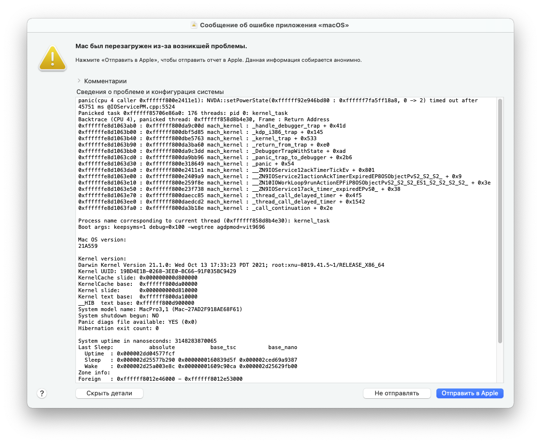

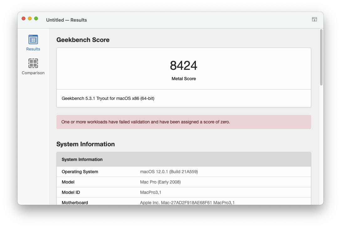

Hi All!
I successfuly updated my CMP 3.1 (early 2008) from MacOS Monterey 12.0 Beta 10 to final release 12.0.1.
System volume patched for keppler GPU support
Issues - no issues on installation via full installer, but kernel panic on wakeup from NVDA (report on screenshot)
OCLP - 0.3.1
Thanks for contributors!
Reactions: yezza
