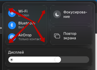

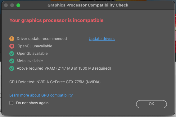

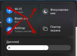

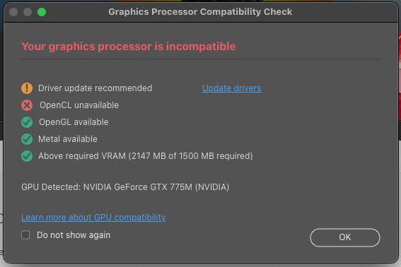

Hello everyone, please tell me. I installed macOS Monterey on my iMac 27 (late 2013) using the Open-Core Patcher method. Then I installed Patch System Volume. Everything started working well, but Photoshop gives an OpenCL unavailable error before launching. I also saw small artifacts in the system interface. Does anyone know a solution to this problem?

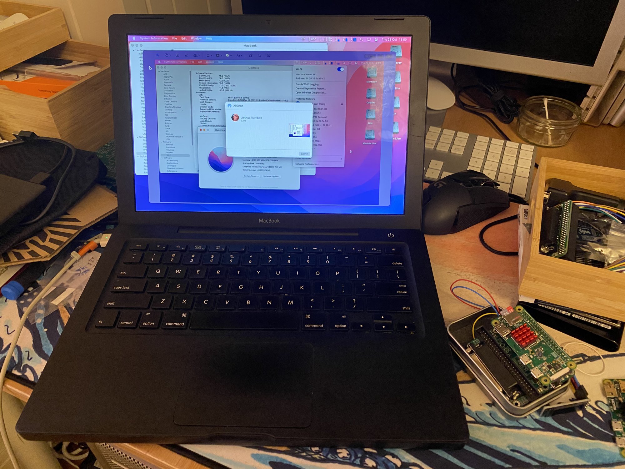

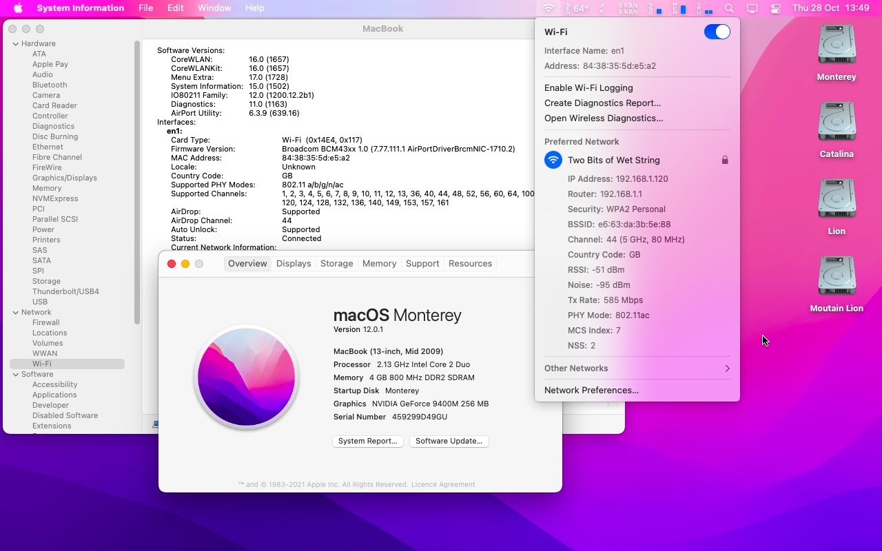

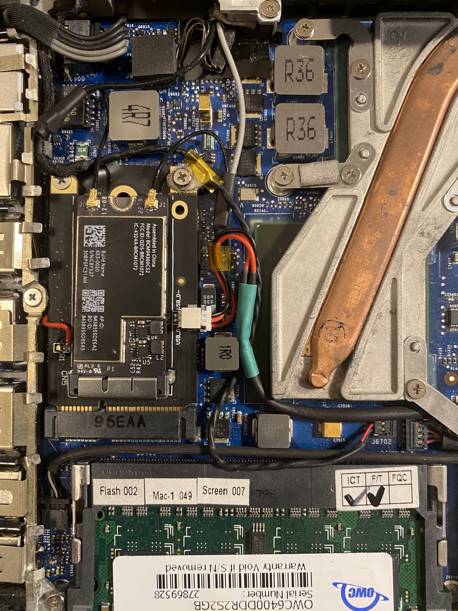

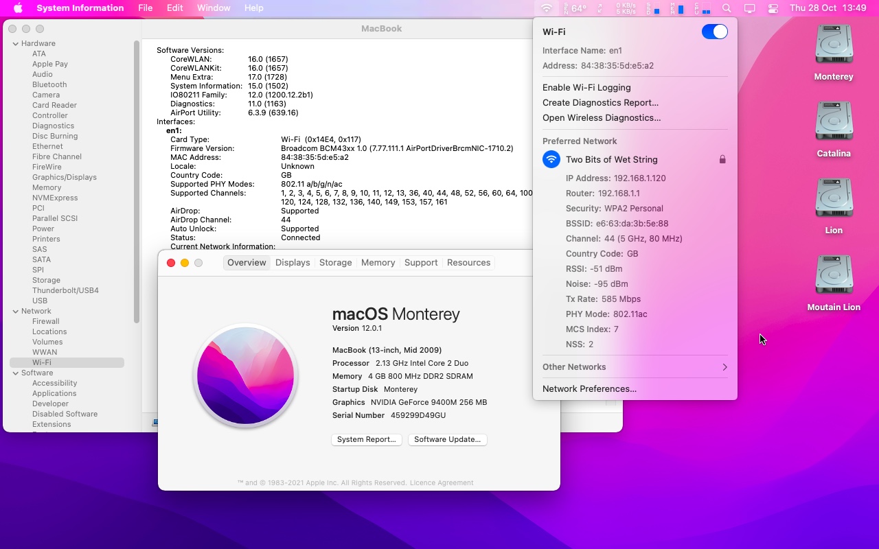

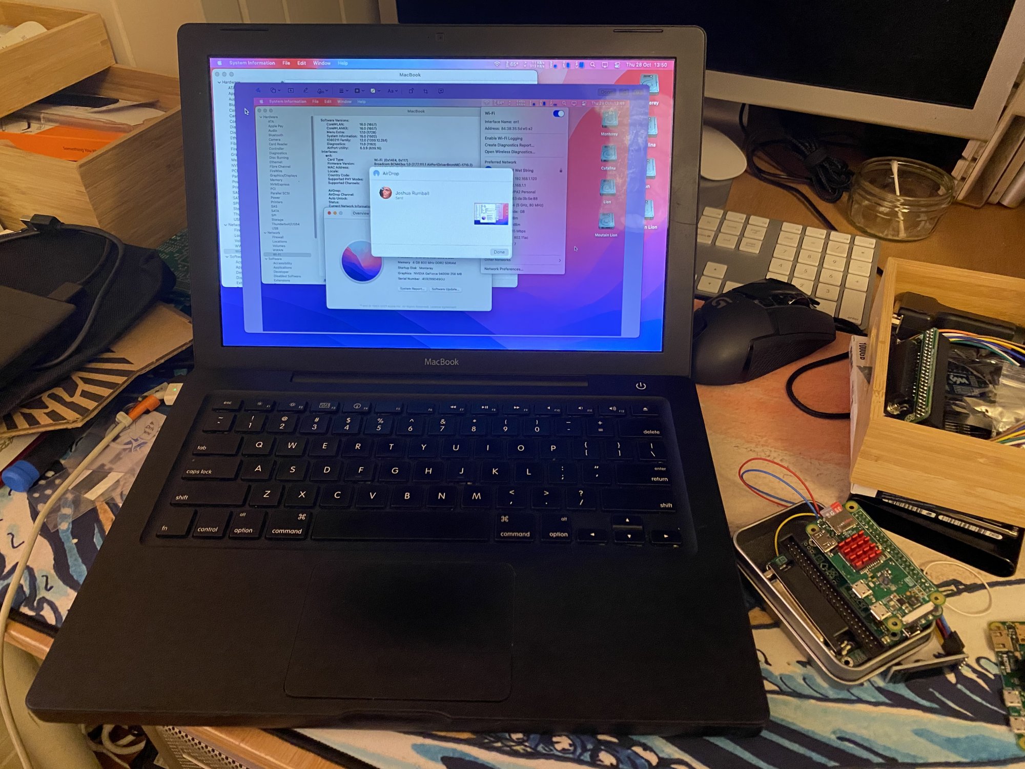

The Black A1181 Frankenbook Lives again....
A Sucsesfull OCLP install to a A1181 5.2 MacBook
I really do have better things to be doing, but it is now running Monterey with a MacBook 5.2 2.13Ghz logicboard and a ac WiFi and BT 4.0 from a BCM94360CS2 WiFi upgrade along with an SSD.
It froze 3 times on the progress bar each time I waited an hr then rebooted and it finally installed !
Actually surprisingly usable will quite happily play a YouTube video or browse the web, and idles with not a lot of fan noise !
Not working is right clicking but I know there's a Prefpane to fix that somewhere no backlight control and the function keys don’t work with their shortcuts…. everything else including airdrop etc works great.
So much for Apples planned obsolescence, a perfectly capable machine for simple necessities….. and they look so much better in black.
