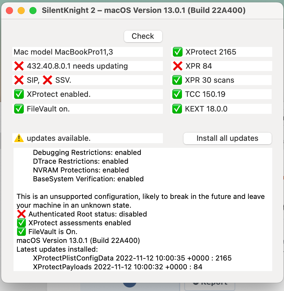

Quick question - have OLCP 0.5.2 on MacBookPro11,3. Working well. When I check the firmware using SilientKnight, it tells me it's out of date. Should I update? Would that break OLCP, or should I update and then re-apply OLCP?

No. Since firmware updating runs only after direct boot into last supported OS, bypassing OCLP EFI, so they don't interfere.
But you'll need a partition or a volume with Big Sur installed. Once you update Big Sur (directly after resetting PRAM/NVRAM), the firmware updated is being installed.

But you'll need a partition or a volume with Big Sur installed, installed the newest update their (directly after resetting PRAM/NVRAM).
Yes, that’s the way to go: install a basic macOS Big Sur 11.7.1+ natively on an external disk (or internal partition or volume), and then keep it updated; every time the OS update includes a firmware update, it will be applied to the Mac: the current firmware version for the MBP11,3 is 474.0.0.0.0; and more info here, for example:

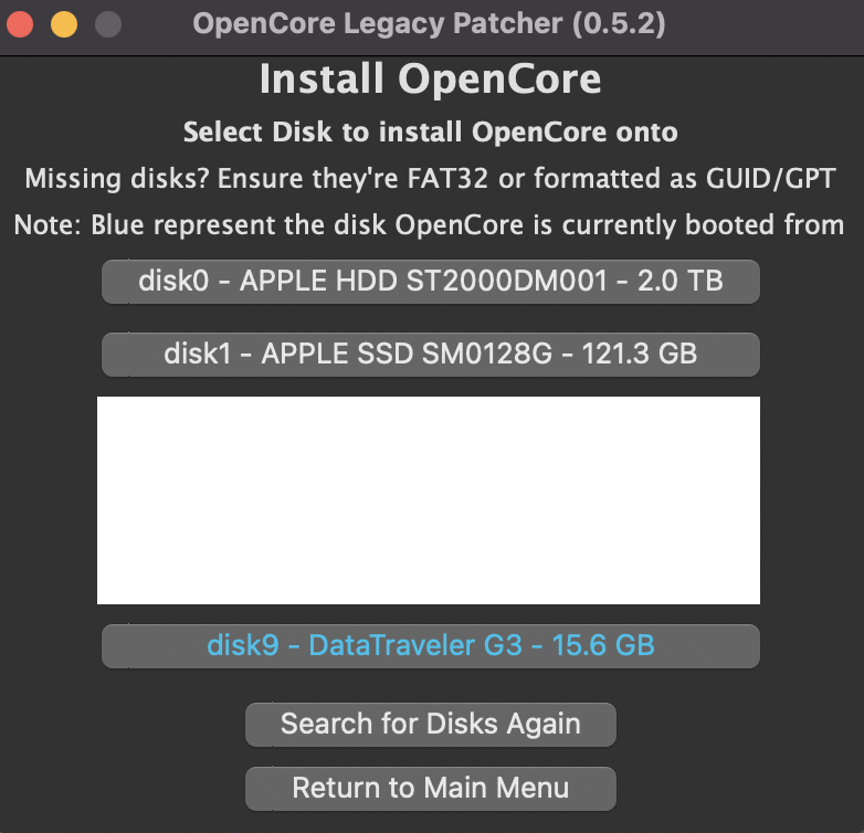

Just finished updating my late 2015 iMac (with fusion drive) to Ventura and so far it's running smoothly.
Just two quick questions:
When wanting to install Opencore to the internal drive, it's giving me two choices since it's a fusion drive. Should I put it on the SSD or HDD portion of the Fusion drive?
When running SilentKnight says the firmware is old, should I bother trying to update it using a bootable drive of Monterey or don't bother?
Thanks for all your help!

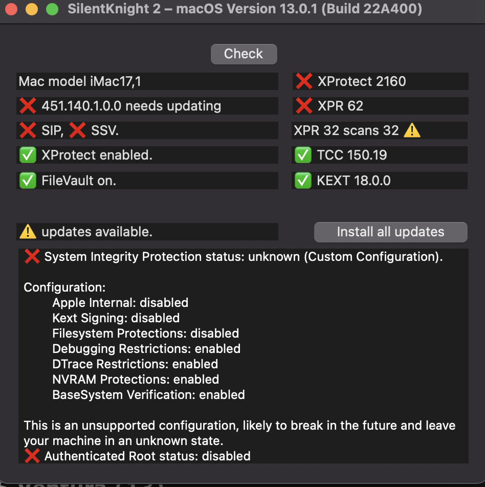

I have the same issue with firmware being out of date. However, given that I'm running 13.0.1 with no problems, I've decided to leave it as is.
Tried two times to update to 13.0.1 with my mac mini 2014, stuck at 5 min and 20 min left. Guess I've no luck with Ventura!
Cool thank you, appreciate it.
If your Mac also has a fusion drive, which portion of it did you install Opencore to? Or it doesn't matter?

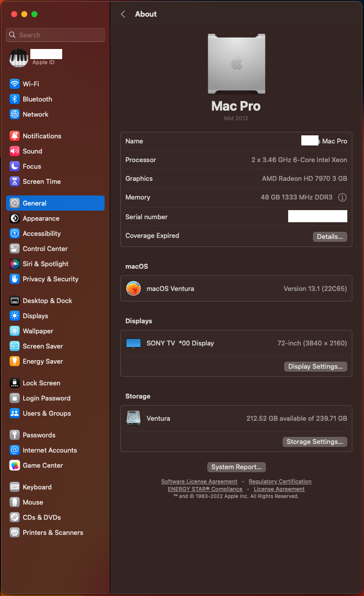

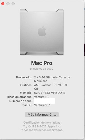

Everything works like a charm, except the bluetooth, of course.

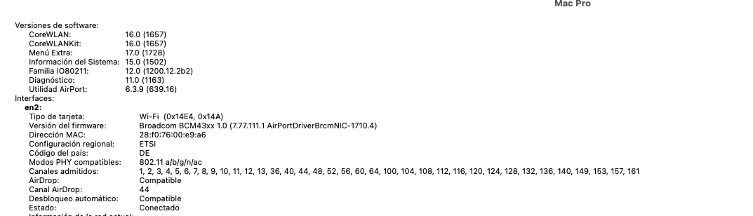

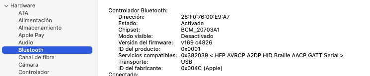

You mean everything works except the legacy wifi and bluetooth? hehe;)
Nop. It´s a modern wifi/bluetooth module. Wifi works so great. I think it´s because it takes the power from the old legacy bluetooth port. Will try with an external cable later.
