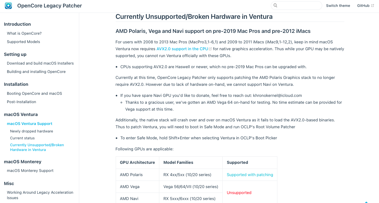

hey guys just curious. I have a 2010 Mac Pro with radeon 5770 running Monterey and has acceleration with legacy graphics patch through open core 0.5.2 is this acceleration also supported under Ventura?
Reactions: NataliaC
Short answer - no.
There is a specific page in the guide covering this.
Reactions: olad
