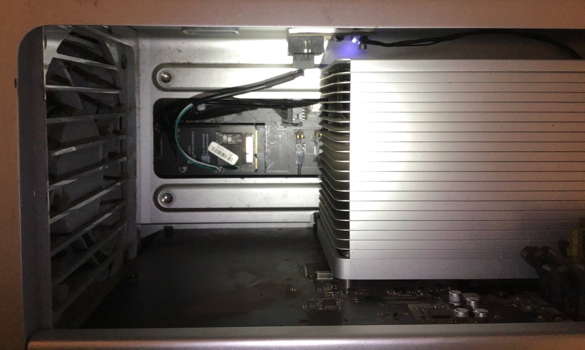

To all cMP4,1 and 5,1 owners who miss BT on Ventura 13.x (even when using upgraded BRCM combo module like the BCM94360CD):
The question came up a few posts earlier here if re-connecting the USB data lines from Broadcom combo wifi/BT module might re-enable it for correct driver usage in Ventura.
I tried it today and yes, successfully have all the functionality back like Airdrop and connection of wireless keyboard / trackpad etc. - see screenshot.
What I did as a preliminary solution: I cut a standard USB cable (A to B style) and connected the green wire of the A-side to the BRCM module´s USB+ and the white wire to USB- that before (as a working solution up to Monterey) went to the old 4pin BT connector on the MP4,1/5,1 mainboard. I then plugged in the type A connector of the cable into a 2.0 hub to one of the external USB jacks.
Next step is to try to strap the USB hub to the internal conn. on the mainboard to see if that would also work (making a more permanent routing of cables internal-only then possible).
Update: It is also working with the internal USB+ and USB- data signals from the 4pin socket on the mainboard!
Seems to be an appropriate Xmas project to do some miniature piggy-back PCB with a USB hub chip and additional 3.3V to 5V converter for external port usage. The idea is to provide 2 extra USB 2.0 ports for wired keyboards and mice for i.e. boot selection and other purposes... Stay tuned for results!

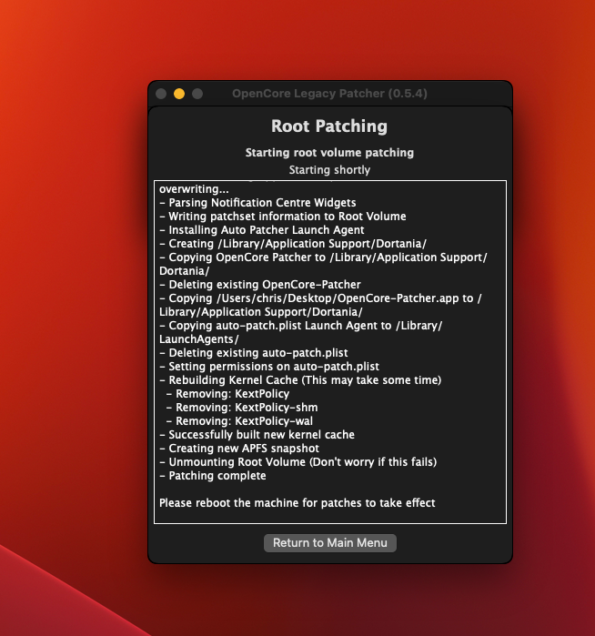

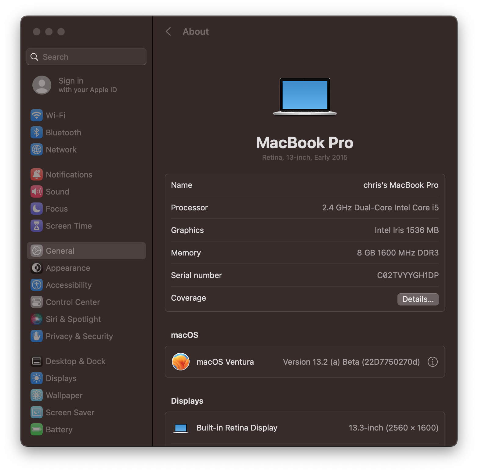

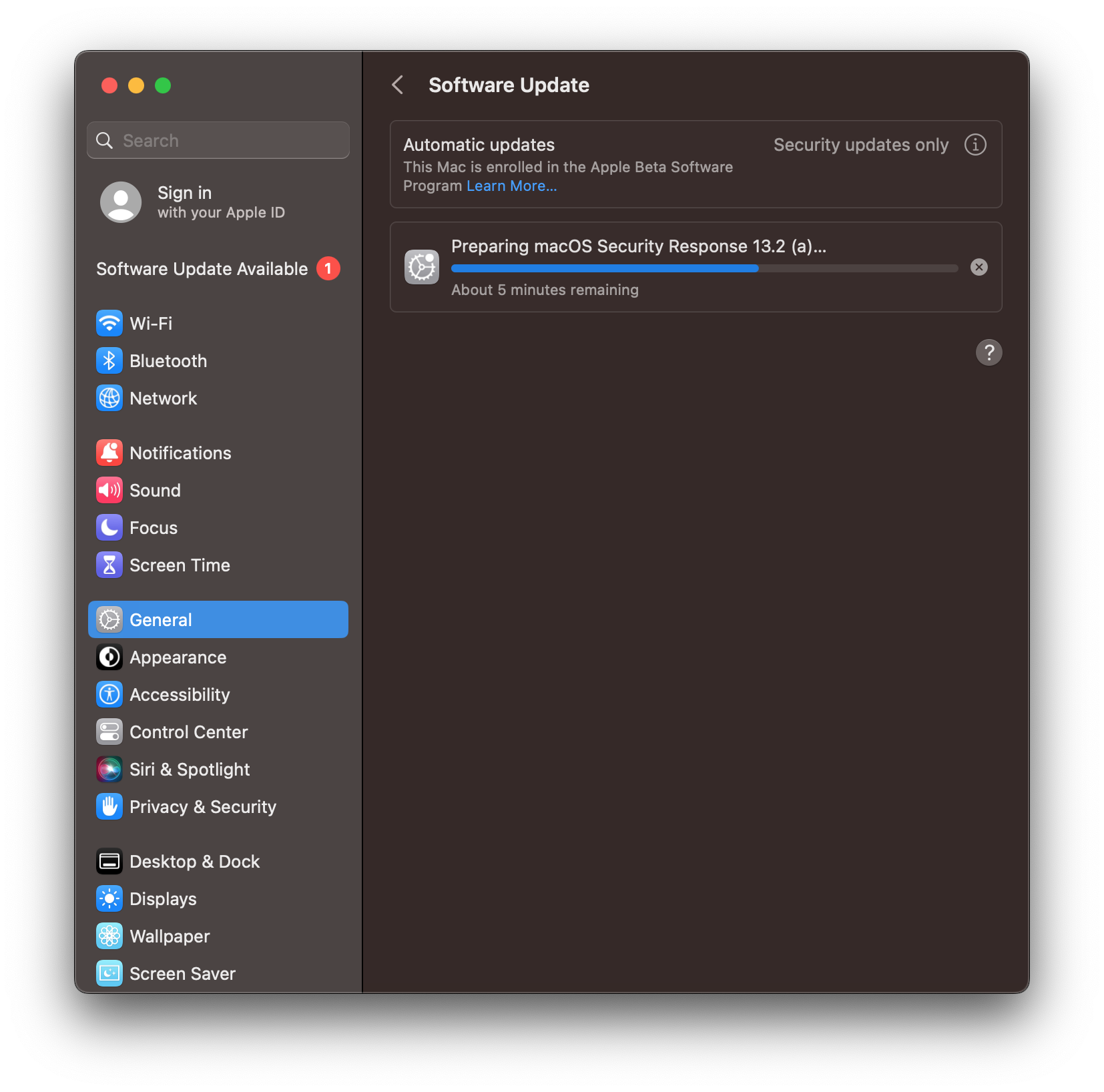

Sharing experiance Beta13.2 here on MacBookPro-retina-late-2013
I have Update to 13.2 then install Security response. 13.2 (a) before root patch
Reboot then install OCLP 0.5.4 root patch
Reboot Evertnings good
Your approach of installing the Security Update before the post install root patches was interesting. I reverted the root patches and shut down the iMac. Unfortunately, the Security Update still generated an error. The root patches are now being reinstalled. As suggested by Tockman in post 2681, it appears that the problem may be machine-dependent.
it seems to be indeed machine-dependant : if your Mac is Pre-Haswell, Rapid Security Response cannot be installed.
