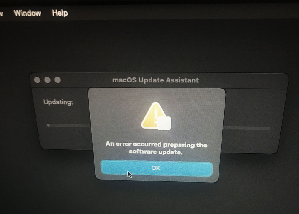

My notebook is mba2012. I created the ventura13.1 installation USB disk under mojave and installed oclp-0.5.3 to it.
then reboot and hold option, select EFI to start the installation,it took about 10 minutes.
After the first auto restart, the installation continues,it took about 30 minutes.
After the second auto restart, The system reported an error,
I have installed it twice but failed to install it.

Have you ever installed Catalina on your device and therefore received the most recent firmware for your device?
I think that you need to do that before installing OCLP.
yes,I have installed catalina and monterey with oclp0.5.1.
I've tried to install ventura 3times,all failed. it's awful.

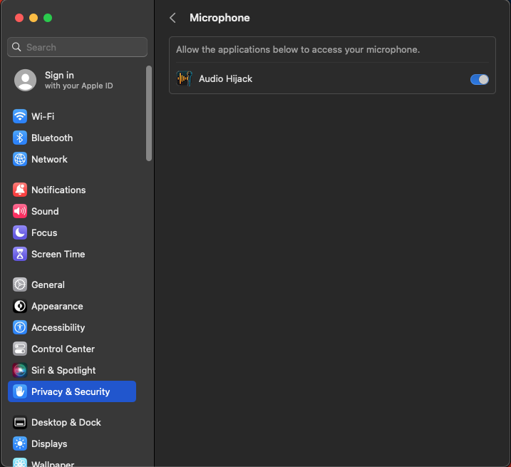

Just wanted to update on this issue with a Fix.
It did turn out to be a permission issue... Just like in Monterey in the begining, some apps need a permission fix.
Run the command below in Terminal:
sudo sqlite3 ~/Library/Application\ Support/com.apple.TCC/TCC.db "INSERT or REPLACE INTO access VALUES('kTCCServiceMicrophone','com.rogueamoeba.audiohijack',0,2,0,1,NULL,NULL,NULL,'UNUSED',NULL,0,1541440109);"
(This fix is for Audio Hijack ONLY!)
Here's a pic of the finished product below:

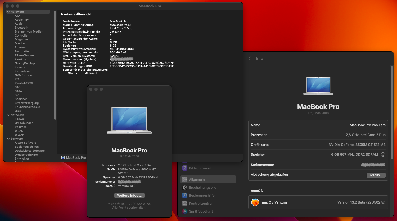

MacBook Pro 4,1 Ventura summary:
First successfully booted a "transplanted" patched version from MB5,1 (2008 13").
ExpressCard USB 3.0 was removed at that point, just to make sure and to not run into "prioritized" USB 3 usage through OCLP 0.5.4n
After that, confidently installed Ventura 13.2beta1 on internal SSD (atop of existing Monterey 12.6.1).
All well, internal trackpad and keyboard working after USB 1.1 patch to root drive.
Also working: Facetime camera, keyboard backlight, BT and Wifi. Great job, devs! A huge THX to all of the involved!
Note: Inserting USB 3.0 card after booting does not show card, but neither crashes system.
Will try booting with it next...
edit: no luck with inserted USB3 card, as expected - it crashes on boot despite I am quite sure I use the "prefer 3.0" OCLP nightly
Also sleep does not seem to work correctly, system wakes up, makes CD/DVD mechanical noises as usual but screen stays black (no backlight) and after short while, system freezes completely (no caps/lock LED toggle possible any more)
Is It possible that this happens due to max USB exisisting was 2.0 when MPB 4.1 released?
Other systems are affected as well (see cMP3,1 to 5,1).
Ventura originally lacks USB1.1 support and as the OCLP devs stated, having both USB3.x and USB1.1 (patched) running, it crashes the kernel. So atm 3.0 (when detected) is used instead of USB1.1.
So we'll have to wait and see if some degree of reverse-engineering of older stack versions may make parallel use possible.
