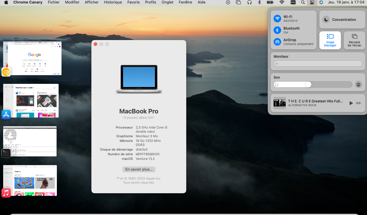

OTA works between 13.2 b and 13.2 ( failed between 13.1 and 13.2b) on MacBookPro8,1
Introduced the "stage manager"
In 13.2.b "stage manager" works without applying acceleration patching, not after applying the OCLP 0.5.4n root patching
Let's see now on 13.2 :) still issues on BT pairing with an Iphone, and ATV not seen on devices of xcode
Good Job devs :)
