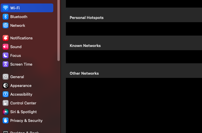

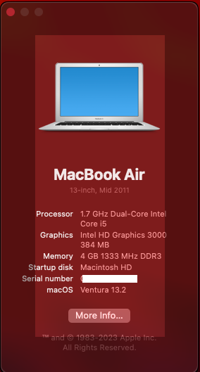

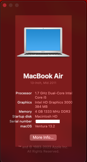

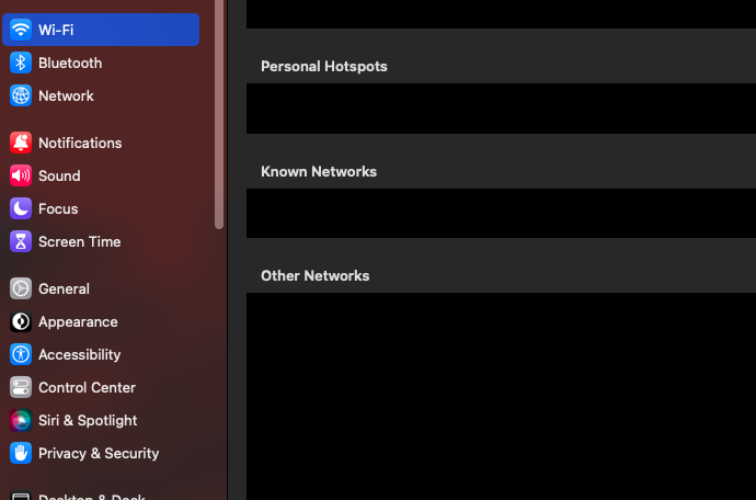

I was finally able to upgrade my Mac Book Air 4,2 to Ventura.
However, not able to select anything on settings . Only get black windows as above. Any clue anyone

Have you tried a clean install? I would also try with/without the Post Install patches through the Open Core Patcher app.
Yes I tried a clean install but with post install root patches. If I try without root patch will not get graphic acceleration. Howabout you as you have same MacBook Air as me. are you able to select all options in settings
Interesting! I was able to see the settings just fine without those black boxes with/without the post install patches. I have no idea what might be causing that.
Yep this is a known issue with hd3000 graphics. I have exactly the same issue on Mac mini 5,1. We just have to wait for a fix. OCLP 0.6.2 change log states there is a fix for this but I've tried it and it doesn't work.
I too hope the fix comes out soon. Meanwhile I reverted the root patches and it works like it is supposed to but is laggy as no graphic acceleration. If I use the post install patch I will get same black windows in settings and cannot select any options.

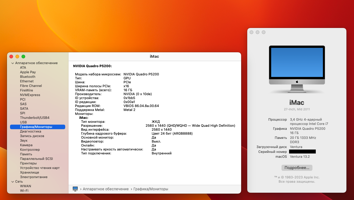

After installing opencore 0.6.1, the quadro p5200m video card accelerator works in the Vntura 13.2 system without metal.
If I turn on metal, the accelerator also works. But, when I open any application, the finder blinks or disappears for 5 seconds ... It's sad ...

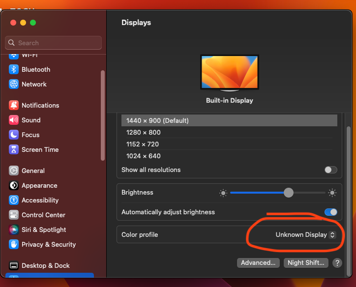

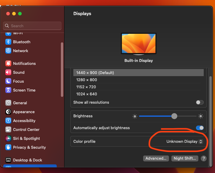

Further to my message above, I finally did the following and all is working great.
1. I re installed post root patches.
2. got back graphics acceleration & transparency.
3. The 'system settings pane' again showed all text missing and black blocks.
4. I selected display and on right side 3rd black box clicked my mouse & got the color profile pane.
5. Selected unknown display in lieu of color Lcd.
And viola ! all text came back and everything working perfect. ✌️
3. The system settings again showed all text missing and black blocks.

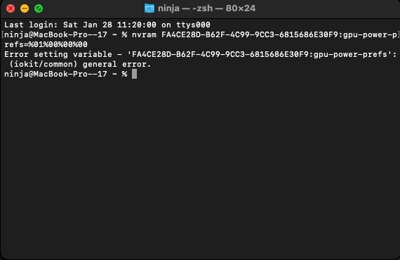

Hello. I have a problem executing a command in the terminal. Gives an error message. maybe you know what is the problem?
