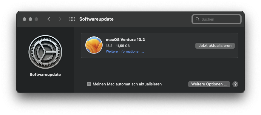

But I have good news. Because my USB installer didn't work (always an installer error dialog at some point of the installation progress – explained in an earlier post ...) I had the idea to simply go from Monterey to Ventura via Software Update.
Believe it or not, it worked! :cool:

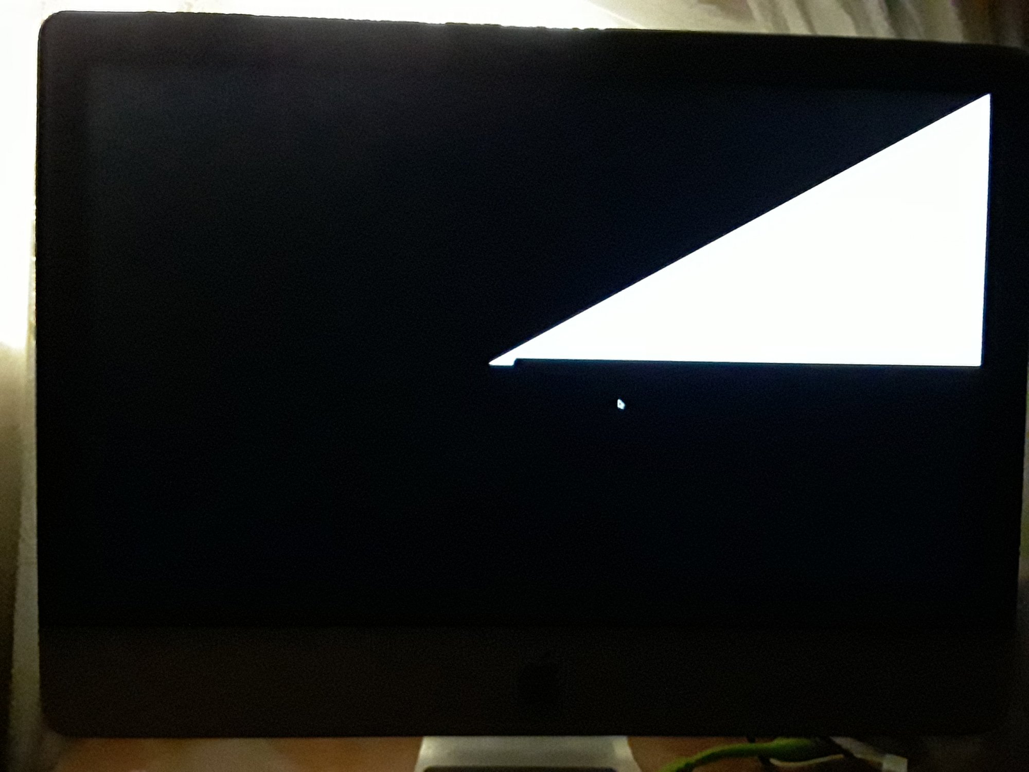

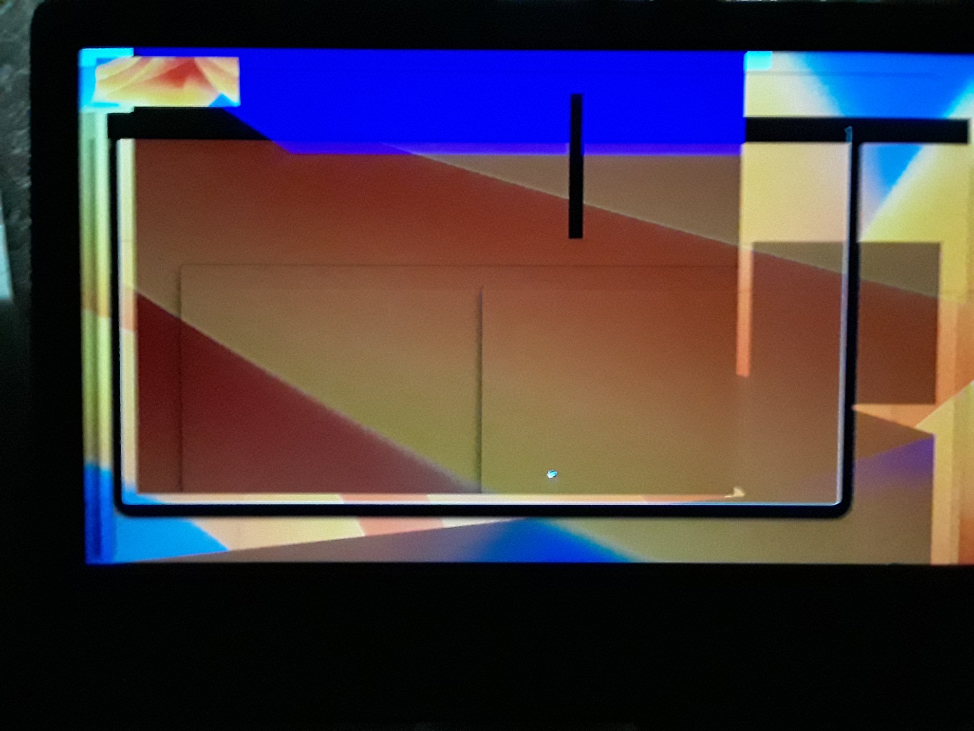

It looks like the "broken screen" issue in the attached screenshots still haven't been resolved (imac 13.1). Anyone know if the devs are working on a fix? Its a pretty major glitch as it requires a hard reboot to fix (via the power button). Curious to see how older imacs are performing given this issue.

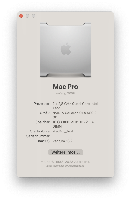

I just did the same thing with a similar configuration:
Mac Pro 3,1 2x3.0 Ghz
Nvidia GeForece GTX 680
28 GB of RAM
I used a second boot SSD I have for testing which already had Monterey on it. The update from software update went surprisingly well, especially since I wasn't counting on this machine ever running Ventura. So now I have to determine if I want to do the same thing for my primary boot drive since this is my main personal machine (still). My primary work machine next to it is a M1 MacBook Pro 14" and it laughs at this antique next to it. :)

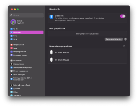

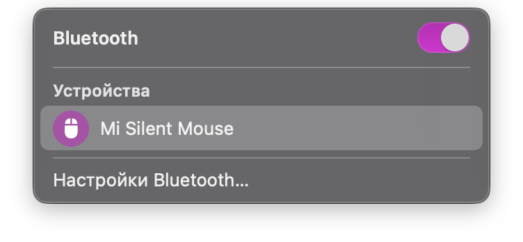

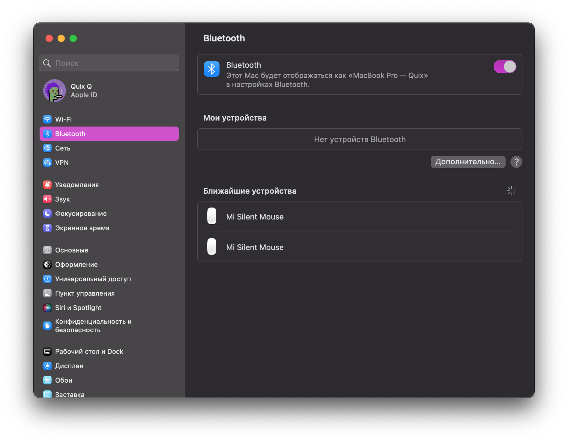

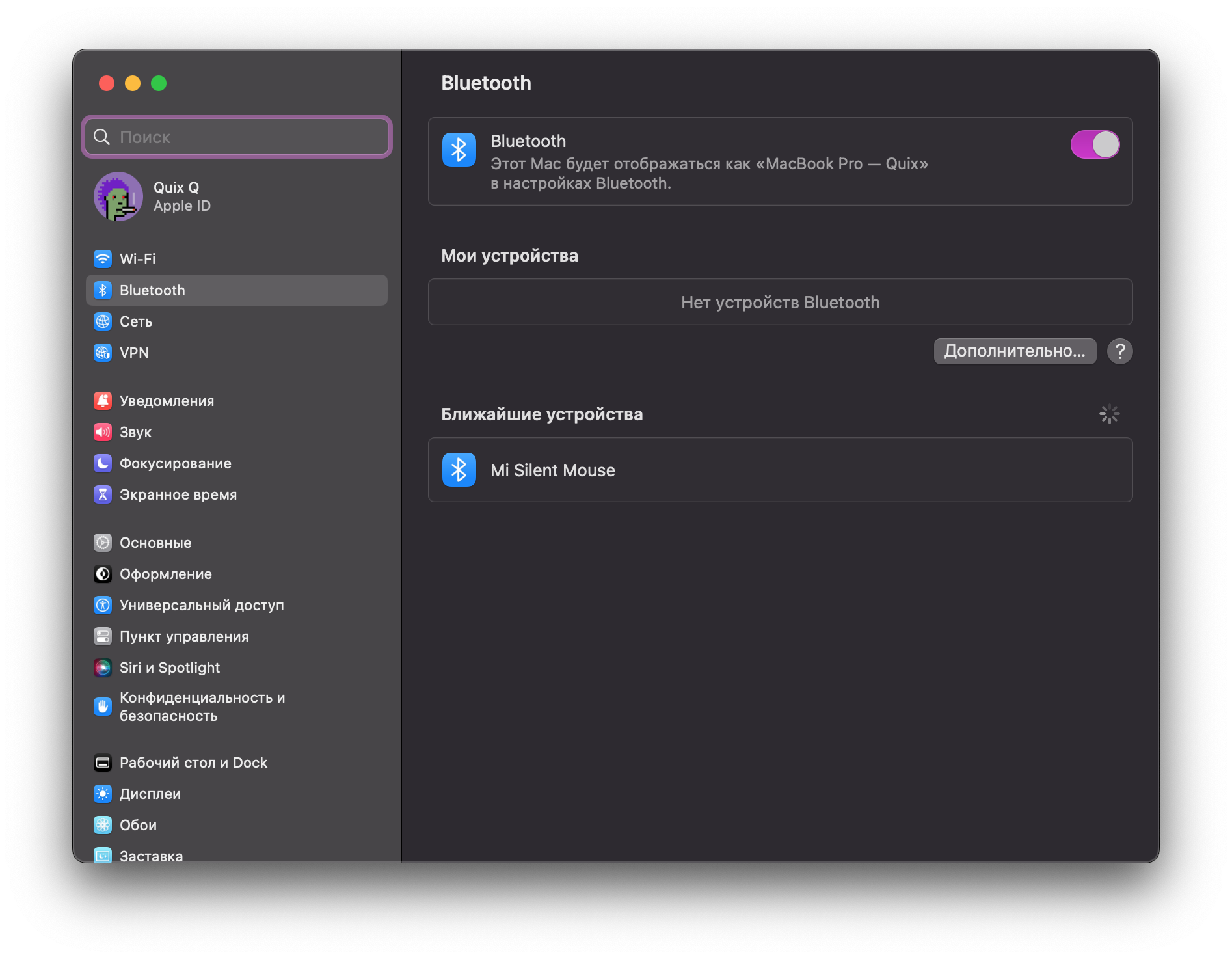

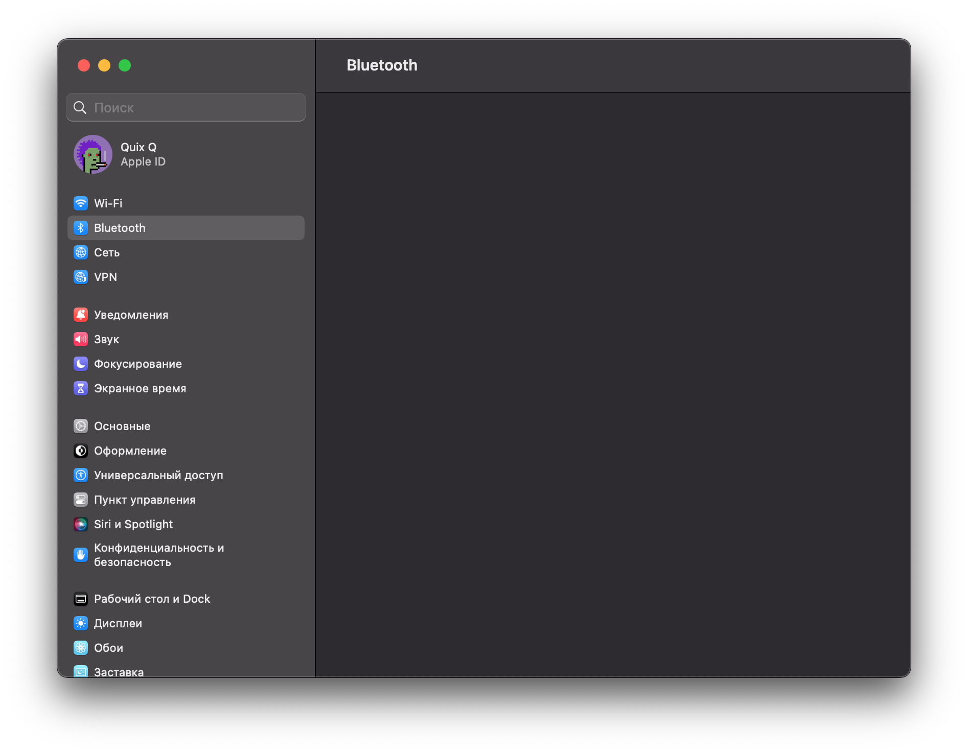

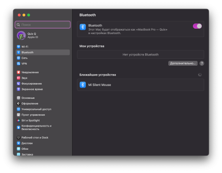

Deleted, rebooted. It does not work, it finds a mouse on BT, I press the connection - it thinks - it's connected, but the mouse does not work.

Uh, how exactly did you do that... how did you get the upgrade dialog to show?
The Ventura upgrade was offered conventionally via Monterey's Software Update in Preferences here.View attachment 2148769
If it doesn't show up, try to press command-r several times ...

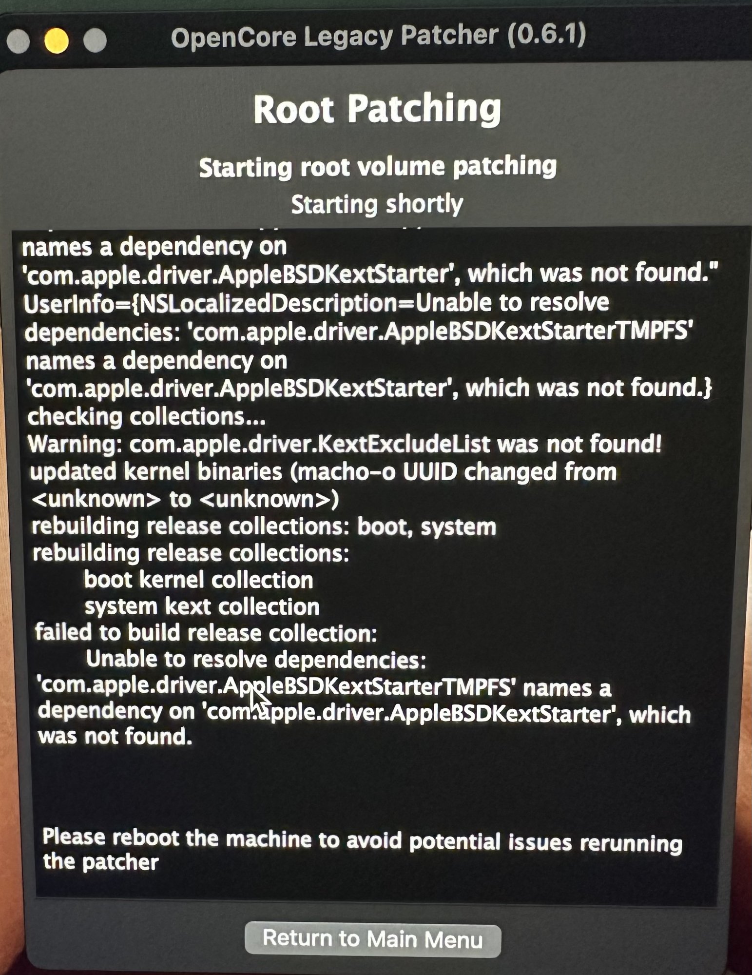

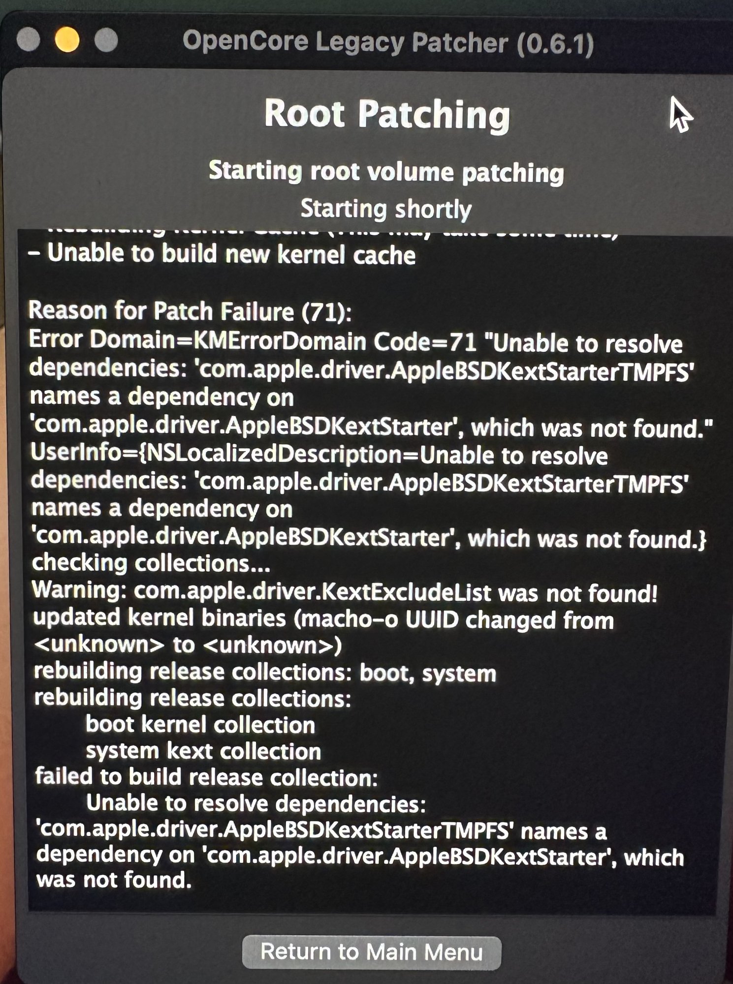

iMac 15,1 2014…. Upgraded OCLP to 0.6.1 and did 13.2 update inside macOS. Installed fine but failing to install root patches. Get the attached error. I have manually downloaded and installed the 13.2 KDK. HELP!!
I have the same iMac. I went through that situation several times. I think you should delete the contents of the EFI partition - everything - with the MountEFI utility (search on Github), do a PRAM reset, install OCLP 0.6.2, latest version, followed by the Root Patch again to get the system running correctly! If that works, keep your hands off, leave it alone and hope it stays alive and well.;) (quoted from my previous post)
Reactions: roronl
Haha cheers! I actually resolved it by deleting the KDK that I'd manually installed, and then the root patcher downloaded it and all the patching worked. Must do something different when it downloads it itself. So, all working fine now. Will just install OCLP 0.6.2 and will leave well alone!!
28 GB of RAM

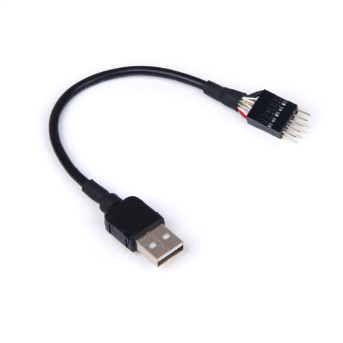

I use a fenvi FV-T919 WiFi and Bluetooth PCIe card in a MacPro 3,1 and it works great with Ventura. The power for the Bluetooth module comes from another USB 3 PCIe card's internal port ...

Just wanted to throw this out there.... For Ventura & Bluetooth if you are going to do the BCM94360CD upgrade, you could get one of these and connect it to the USB 2.0 "hub" adapter...

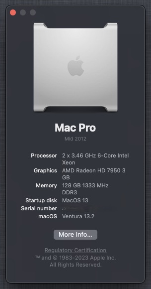

Hello all, Running very smoothly on installed OTA Ventura 13.2 update with Opencore v.0.6.1. All major apps (MS Office, Adobe Acrobat, Photoshop, InDesign, Parallels Desktop 18.1.0, etc.) System functions (BT, WiFI, Airdrop, etc. opening and working efficiently without a glitch. Overall this Ventura update "feels" very responsive. Dortania & Co. are the Da Vinci of the MacOS for us of the unsupported Mac World.
Could you please describe exactly how you wired the Fenvi card. It would be awesome if you could send some photos as well. I also have a 802.11AC Fenvi T919 PCIe card BCM94360CD. As it was required when I bought it, the Fenvi T919 PCIe card is connected to the USB D+ and D- on the backplane board where the original bluetooth card was. Everything worked fine in Monterey. Now in Ventura there is no bluetooth (Wifi works). I have a USB 3 card installed as well. If I should connect it there, where exactly?
Reactions: BDP008
A black cable is included with the fenvi card. I connected the small white connector on one side to the fenvi card and connected the USB-A plug on the other side to the internal USB port of this PCIe card:
That's all! :)
@xlw108 Edit: I forgot, that you need another cable to get to the internal USB port, sorry!
Something like this:
