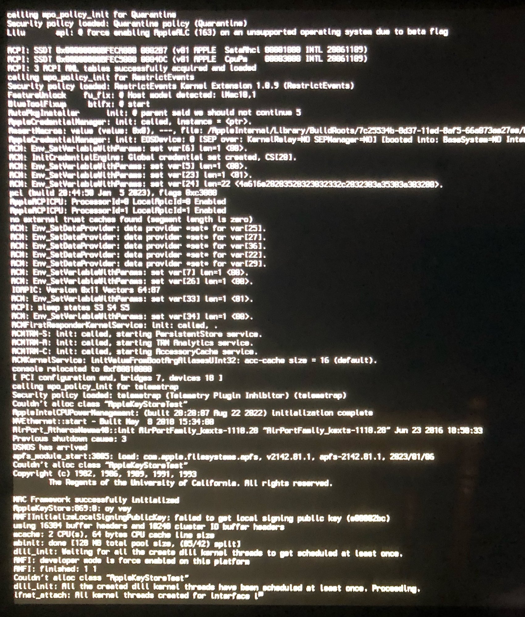

Further info though, booted the iMac in verbose mode and here is the output
It just sits there forever ??? Really annoying as so close but no cigar.

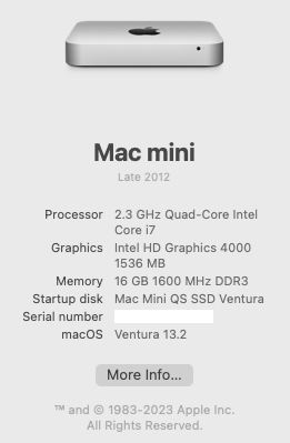

I decided to try the OCLP on my 2012 Mac Mini to see how it would work even though I'm fine with Catalina but concerned about future security updates etc. First results look fine and no major problems with the process. I installed to an external Samsung T7 USB SSD using a USB flash drive installer plugged directly into the Mini as I didn't want to change any of my other USB drives or internal drives. I first cloned my Catalina startup partition using CCC to the Samsung and upgraded to Ventura 13.2 that way using OCLP.
Issues I've noticed so far is that accessing information on hard drives with many folders is a bit slow such as iTunes folders with thousands of tracks. This is for internal and external drives. My firewire drives are recognized. I have two USB high speed hubs so that may be one problem but previously was not. I like to use iTunes 10.7 CoverFlow installed with Retroactive and it still works but when going to change something like a genre before importing a CD, clicking OK causes iTunes to quit while pressing Enter to select the choice works fine. Some preferences like disabling the iTunes store cause the app to quit but are set when launching again but these are minor issues. I'm glad to see that my AIFF files now show the art thumbnail in the Finder instead of a generic icon like in Catalina.

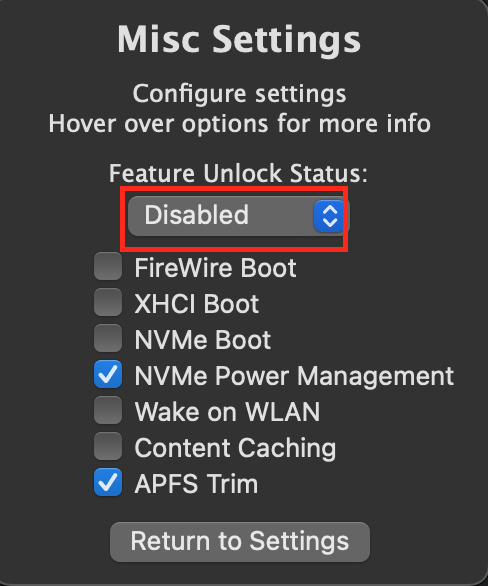

For as long as I have been running macOS on my unsupported MBP6,2, I have been using boot-arg amfi_get_out_of_my_way=1. I noticed that Open Core Legacy Patcher is using boot-arg amfi=0x80 to partially disable AMFI for my rig. Does anyone know where I can find documentation on the amfi=0x80 boot-arg? Thank you.

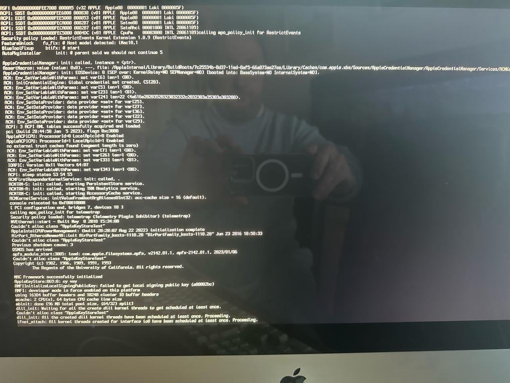

Interesting find re the usb ports, I’m having the exact ssme issue on my 10,1 2009 iMac after installing root patches.
In fact I can’t seem to get past this point now know matter what I try.
After completing install, just sticks at loading screen, Ive posted the verbose screenshot earlier, but here it is again incase it can shed some light

Update: Had a look of my verbose output and it failed at the same spot as yours.
