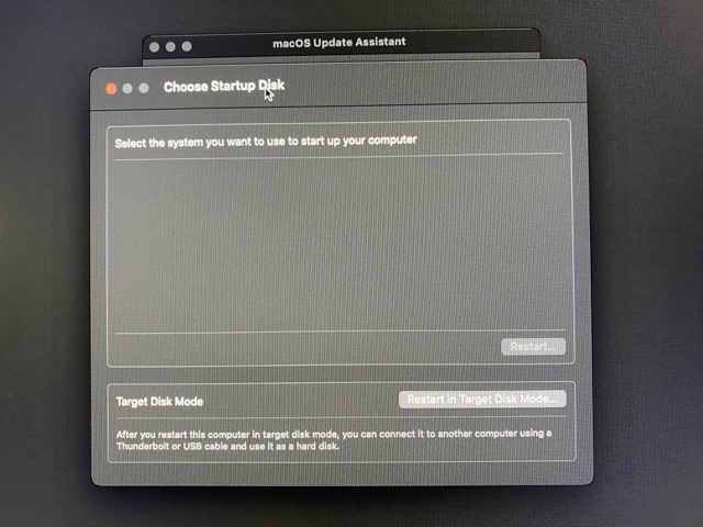

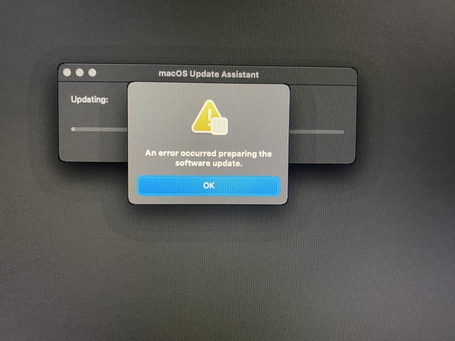

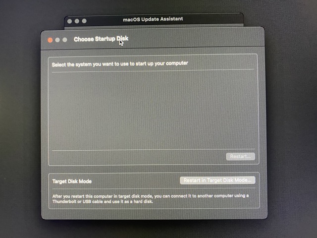

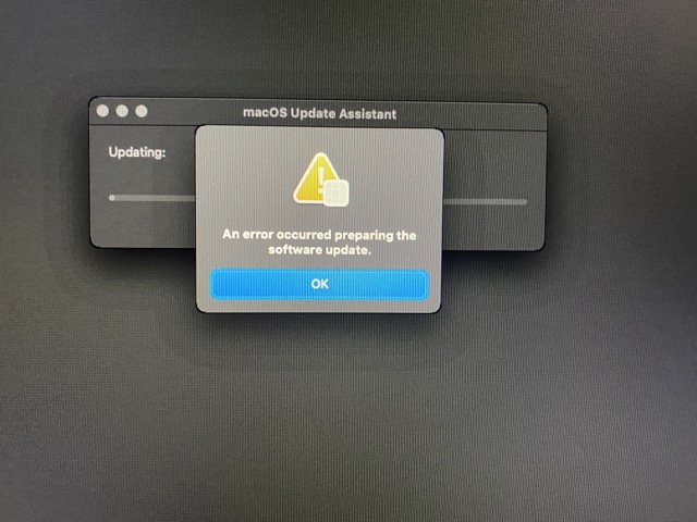

Using OCLP 0.6.1 to install Ventura 13.2 on a Mac Mini 2012.. I had the same issue as Newfylox and others.. “An error occurred preparing the software update” at about the twenty minute mark.
Then when you hit "Ok," this pops up:
The method described above by houser fixed the issue and the install completed successfully.. So, for recap.. to get out of the above window, select Restart at the upper left while holding down the Option key. Select EFI Boot, then Install MacOS Ventura, select Disk Utility, then "View - Show all devices." Next, open container and select the APFS volume and delete it using control-click. Finally, select the disk you are installing Ventura on to and press Erase (for SSD: APFS, GUID partition map). Quit Disk Utility, then back at the installer, select "Install MacOS Ventura." .. I've never used the control-click (NOT right-click) feature of Disk Utility to delete an APFS volume before, so thanks houser for the tip!

I had the same isue on MM 2012 with Ventura 13.1 and 13.2, first time instalation worked after the 4th restart. Seccond time it worked after i have restarted the instalation procces without erasing the hard disk.
Reactions: makra
If you select Mac Journled while erasing the ssd in lieu of APS this error wont come up.

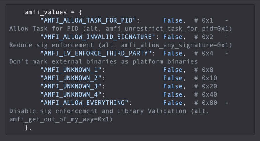

For as long as I have been running macOS on my unsupported MBP6,2, I have been using boot-arg amfi_get_out_of_my_way=1. I noticed that Open Core Legacy Patcher is using boot-arg amfi=0x80 to partially disable AMFI for my rig. Does anyone know where I can find documentation on the amfi=0x80 boot-arg? Thank you.
ASentientHedge answered this on Discord Server. amfi=0x80 (amfi=128) is the same as amfi_get_out_of_my_way=1. The boot-args are interchangeable.
EDIT: Contrary to my original question where I state "partially disable," amfi=0x80 fully disables AMFI (just like amfi_get_out_of_my_way=1).
EDIT: The OCLP code is well documented in the code. The amfi table above is available in OCLP 0.6.1 python source file data/amfi_data.py.

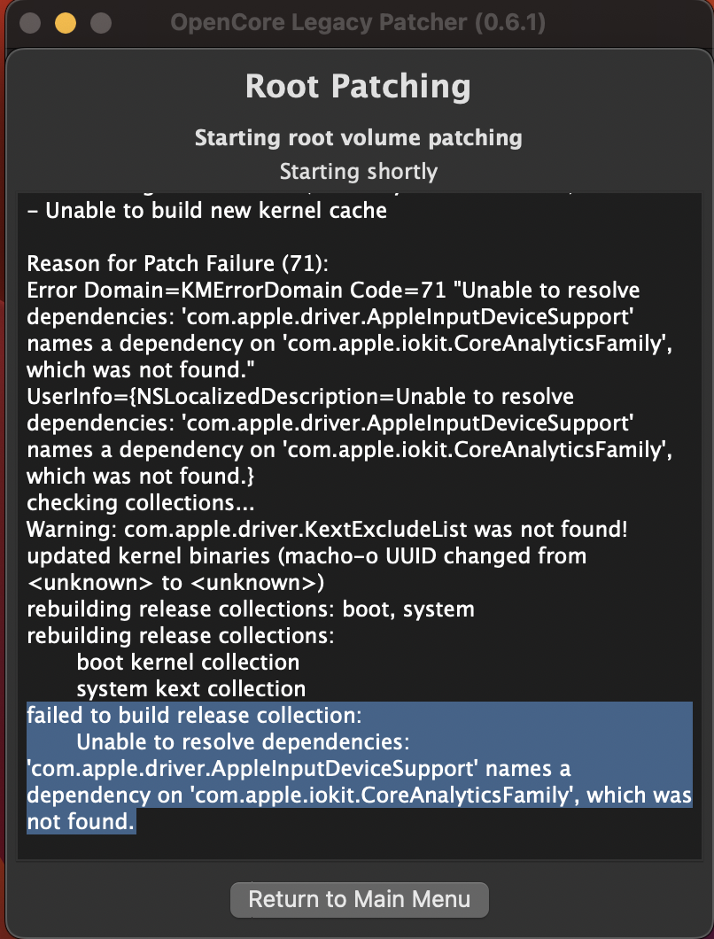

Ok, so I have opencorelegacy patcher running on a 2011 iMac (Ventura), 2012 MacMini (Ventura) and trying to get it working on my 2016 MacBook Pro but having issues. I am using v0.61 and get through the install of Ventura but the patcher is failing with an error code -71. It can't rebuild the cache and is complaining about a unresolved dependency and I cannot find any information what the problem is or how to get rid of or what the dependency is for: com.apple.driver.AppleInputDeviceSupport names a dependency which was not found 'com.apple.iokit.CoreAnalyticsFamily'
Is there any way around this?
