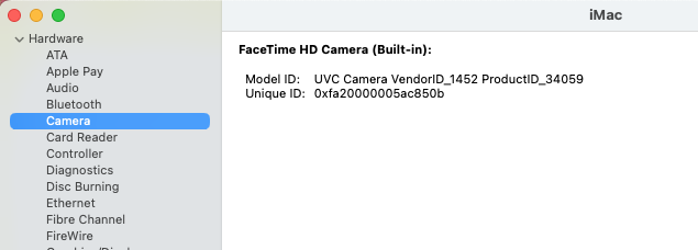

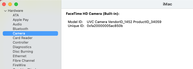

Anyone with Ventura 13.2 had any camera problems with their 2011 iMac? Mine appears to be working, its registered in System Information,
the green LED illuminates when I open an app that uses it, but it doesn't pass video: no image. eg. Photo Booth remains black. I can 'fix' it however with the FaceTime app. If I have Photo Booth open first and it is black, then I open FaceTime, FaceTime video works, and this makes the Photo Booth video work too. The other way around doesn't work, though. ie. If I open FaceTime first and it has video, then I open Photo Booth, Photo Booth cuts the video signal to both apps and they both go black.
I used Microsoft Teams earlier and there was no video signal in it, just checked and the 'FaceTime fix' works there as well. Again only a 1-way fix and Teams will break a working FaceTime video signal.
Facetime video surely works but photobooth will not work. The developers of OCLP has already listed the issues in the troubleshoot page

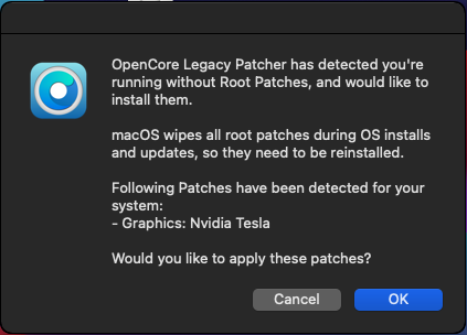

@dcaccount Yes - that is correct. After patching your unsupported Mac with OCLP, when software update runs, it will download and run the full OS installer, not the incremental update. After the software update is complete, apply OCLP post-install patches.
On my MacBookPro6,2 (patched with OCLP 0.6.1 and now running Ventura 13.2 [Release]), I apply updates just as though my MBP6,2 were a supported Mac. I follow the normal software update process (which downloads the full installer, not the incremental update) and then after the macOS update is complete, OCLP prompts me to install the post patches. This update process is the same, whether I use Setting->General->Software Update to trigger the update or whether I'm notified of an available update.
I thought this would be the same for everyone who patches their rig with OCLP, but maybe not? Given that there are clearly still a few issues with OCLP, it is possible that the intended behavior may still be different from the actual for some and that this behavior may vary from model to model (until the issues are resolved).

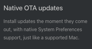

The intent of OCLP is to make the unsupported update experience virtually identical to that of the supported.
Note this from the OCLP Manual:
