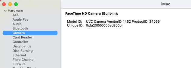

Anyone with Ventura 13.2 had any camera problems with their 2011 iMac? Mine appears to be working, its registered in System Information,
the green LED illuminates when I open an app that uses it, but it doesn't pass video: no image. eg. Photo Booth remains black. I can 'fix' it however with the FaceTime app. If I have Photo Booth open first and it is black, then I open FaceTime, FaceTime video works, and this makes the Photo Booth video work too. The other way around doesn't work, though. ie. If I open FaceTime first and it has video, then I open Photo Booth, Photo Booth cuts the video signal to both apps and they both go black.
I used Microsoft Teams earlier and there was no video signal in it, just checked and the 'FaceTime fix' works there as well. Again only a 1-way fix and Teams will break a working FaceTime video signal.
