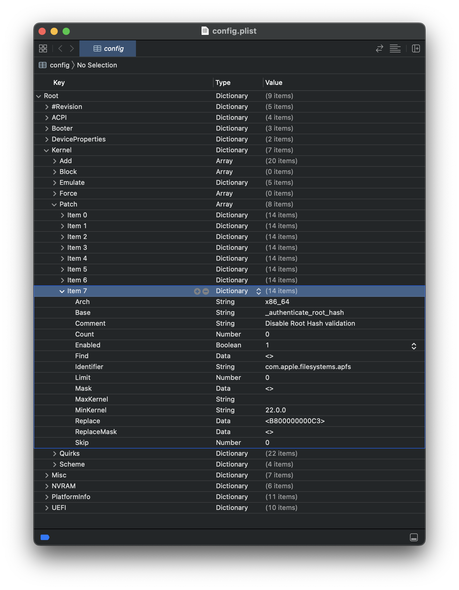

Could you verify the patch itself is enabled inside the config.plist under Kernel -> Patch? It should look similar to the one attached. Otherwise if that's still correct, I found _is_root_hash_authentication_required as another function you could try to patch to return zero (simply replace the Base with _is_root_hash_authentication_required)
Yes, that was exactly what I was missing - thanks! Got it up and running on several machines now. Had to add the Kernel/Patch entry manually in the config.plist file after generating it with various OCLP nightlies.

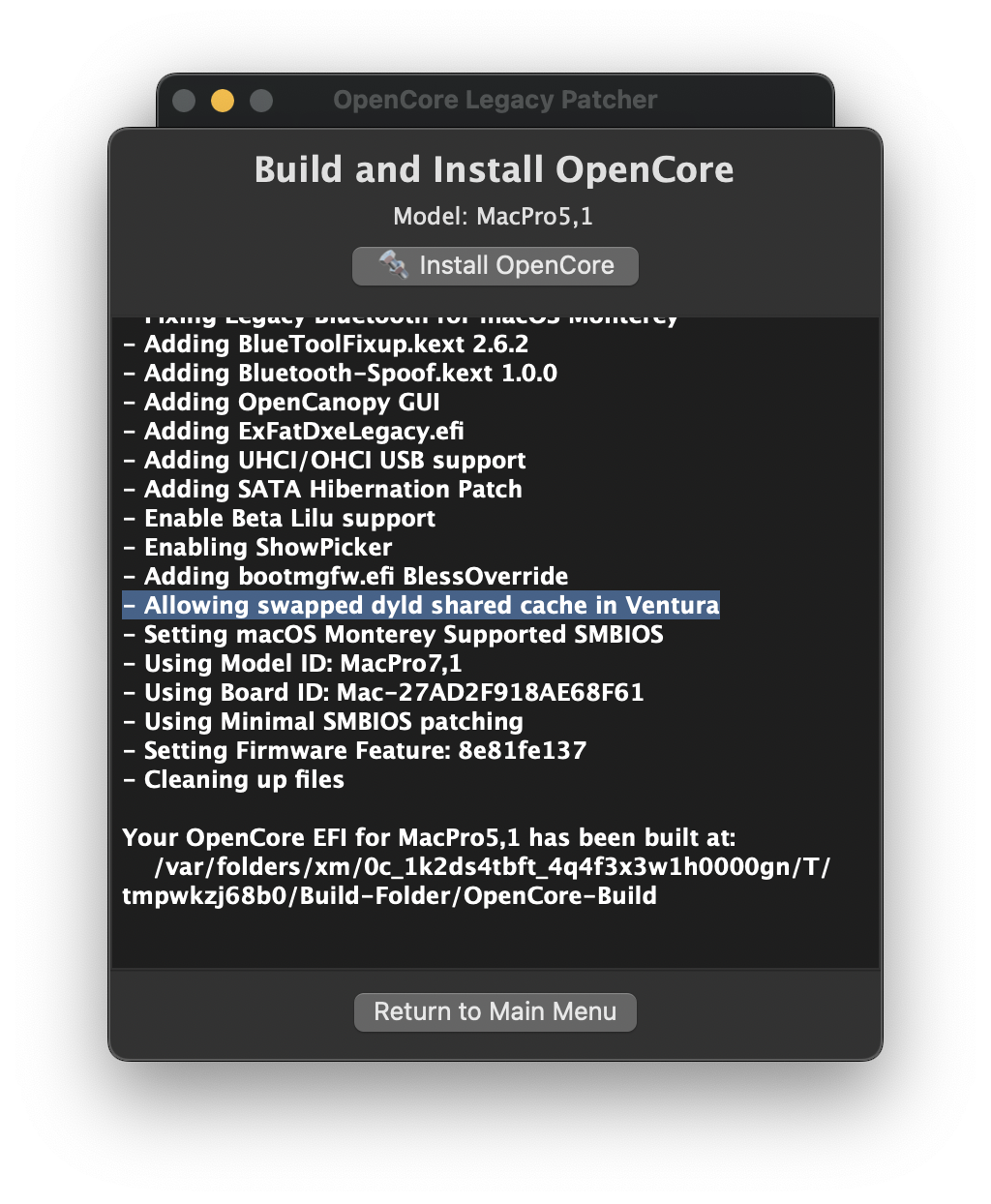

I might have phrased it a bit imprecise: I have not been able to use any of the Ventura alpha OCLP branch precompiled builds (TUI/GUI) to correctly set the _authenticate_root_hash patch in the OC plist. Had always to do it with OC config tool manually. Might be a usage error on my side or a faulty handling in the alpha release...
Are you certain you're using the right branch? The logic for enabling the patch is right here:
Python:
if smbios_data.smbios_dictionary[self.model]["CPU Generation"] <= cpu_data.cpu_data.ivy_bridge.value:
    print("- Allowing swapped dyld shared cache in Ventura")
    self.get_item_by_kv(self.config["Kernel"]["Patch"], "Comment", "Disable Root Hash validation")["Enabled"] = True
The CPU Generation value is defined in smbios_data.py and cpu_data.py.
I verified that the builds uploaded to Github actions are working as well. Maybe you're able to see the fault in my logic somewhere, I'm a bit stumped.

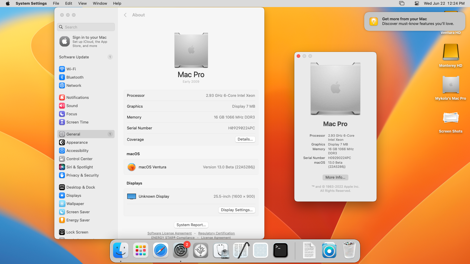

No video acceleration and more importantly no AVX2 emulation. Ventura beta 1 is currently full of such instructions and without a solution there will be definitively no Ventura on pre Haswell (pre Late 2013) Macs.
>no AVX2
Ouch. That’s bad. No way to recompile the kernel with that flag set huh?
Can confirm Beta 2 does still work with the dyld swapping technique, though still nothing to report graphics wise with the community. Legacy Metal is still quite a challenge, and the lack of a KDK yet is quite concerning from a patcher perspective (as we're at the whim of Apple to seed them to the public)
Hopefully we'll see it around when the InstallAssistant.pkg is seeded.
