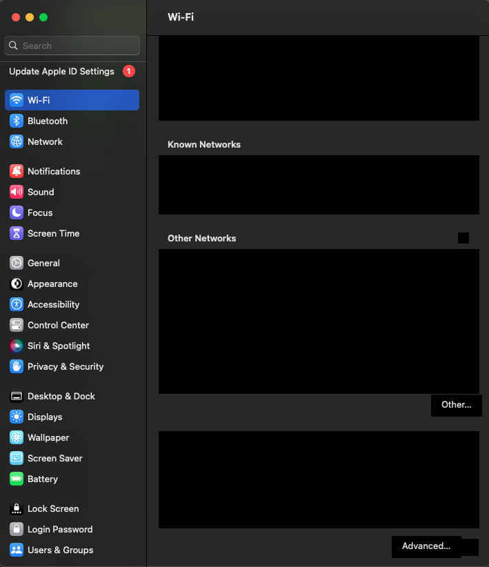

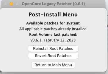

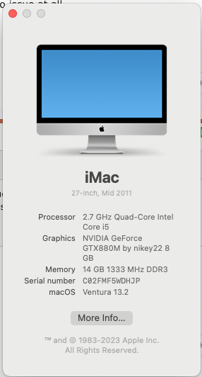

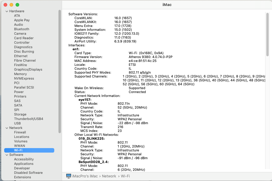

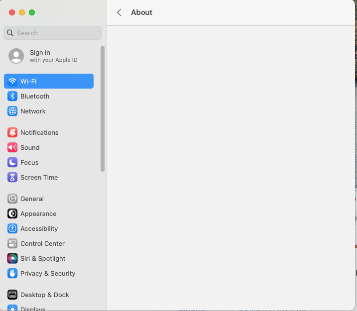

hi guys,
I installed OCLP 0.6.1 and Ventura 13.2 on 2011 27' iMac
everything works well after post install patch including the wifi however the wifi menu is completely missing....
Let me clarify the wifi is connected and the hardware is recognized just no menu and therefore no ability to add networks.
I am looking to have the GUI menu to display networks and have the on/off switch
Any suggestions?
While you said "everything works well after post install patch", if you don't see the WiFi menu, the patches were not fully implemented. Try a later version of OCLP.

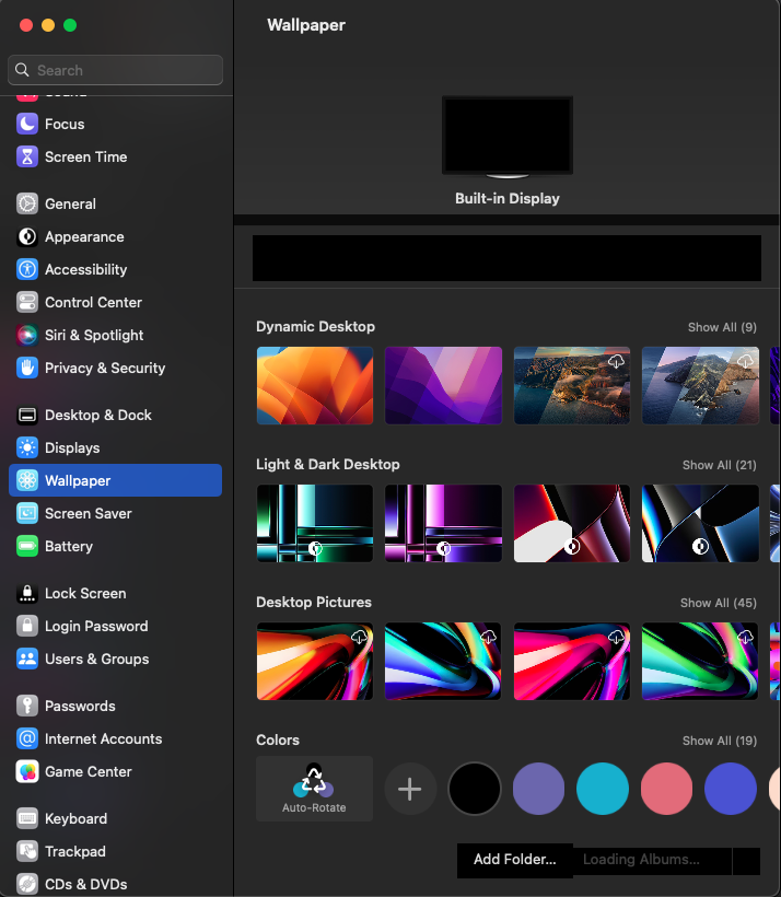

Just installed Ventura on my late 2011 Macbook Pro. It's working pretty well
except for two things:
1) The fan won't stop. It's annoying.
and . . .
2) This . . . the System Settings (formally Sys Prefs) don't display any options EXCEPT for the Screensaver and Wallpaper sections
As usual, any suggestions would be appreciated!

Fan:
Are you sure that indexing has been completed? Otherwise, let it run for a while and it might get back to normal (if indexing is currently hogging your CPU ressources).
System settings: Two possible solutions against the black boxed fields.
Either use the appropriate root volume patch (esp. for HD3000 based graphics) or set the color profile to another entry.
Both have been described multiple times in this thread. Search function suggested ;-)

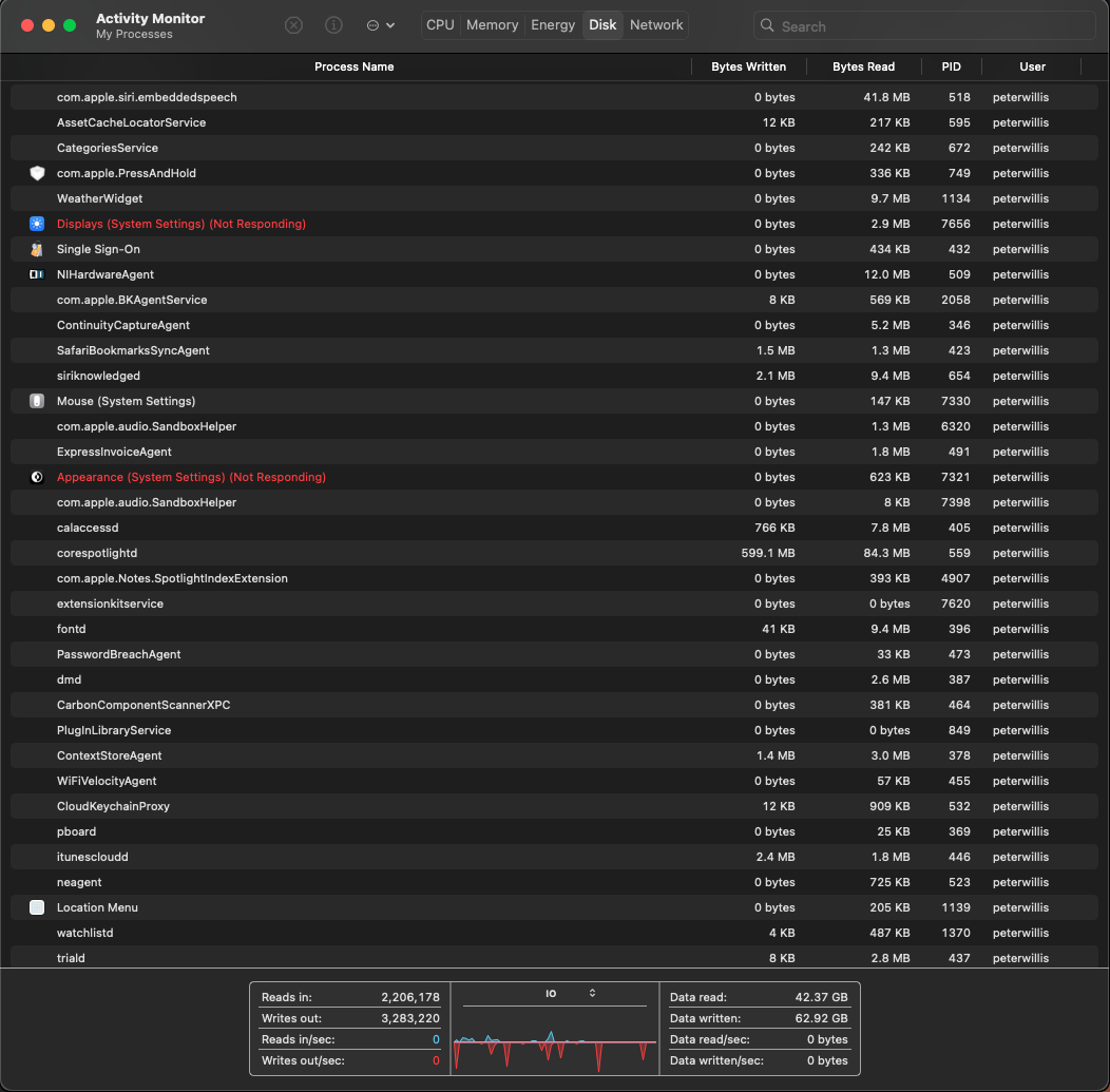

Also, I opened my Activity Monitor hoping to see if I could find out if there was indexing going on, and noticed red error messages only with items related to the System Settings.
I could only capture a couple of them but it's looking the same across the board.

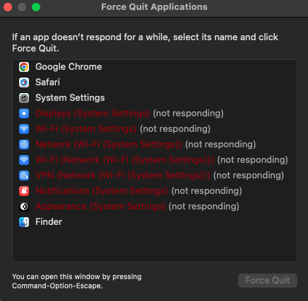

Also, I'm seeing this . . .
The more I look at things the more I realize that it's not working so well lol!

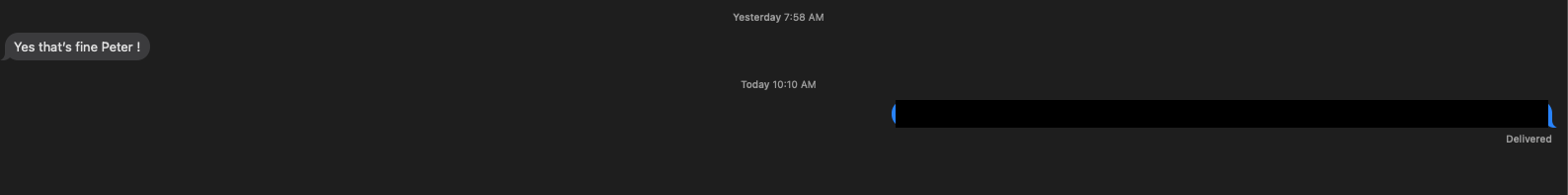

Now this, in Messages. The black message from me is the first message I've tried to send since the installation.

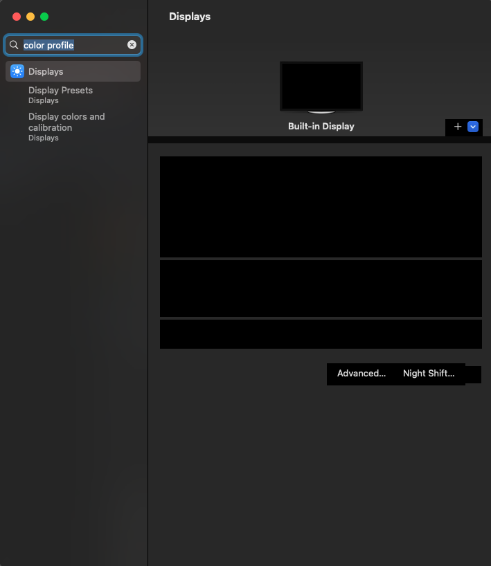

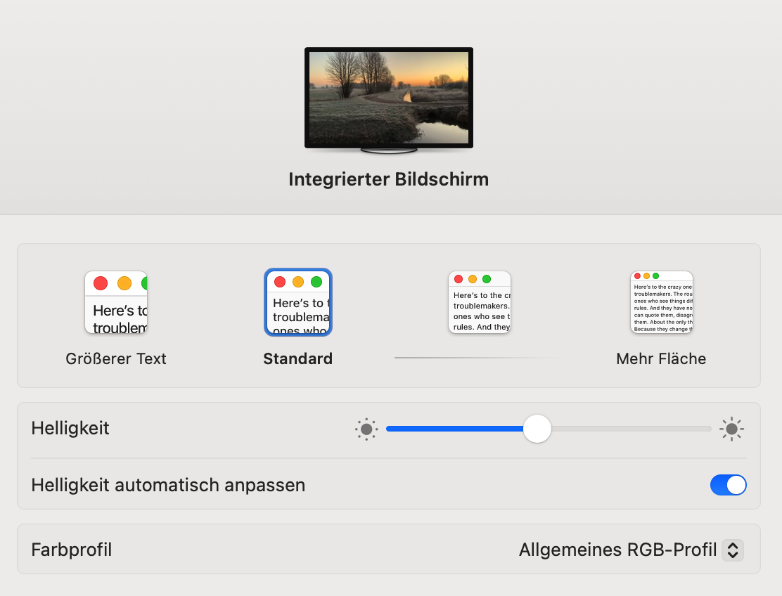

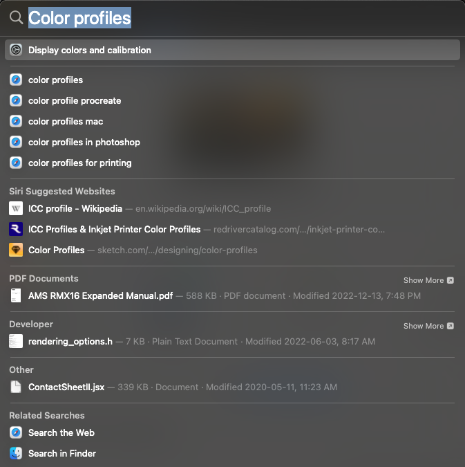

Try to use the search button - you'll find screenshots like this one:
Even if you German isn't fluent, you should be able to figure out, that Color Profile ist the fourth rectangle in the Displays panel. Try to hit at the right, so than the menu with all the profiles pops up. Has worked for me.

This is what I get when I search from within System Settings/displays
