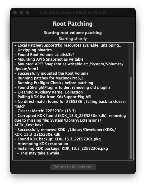

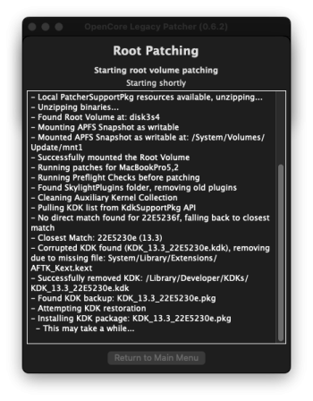

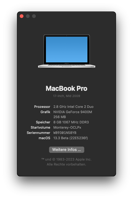

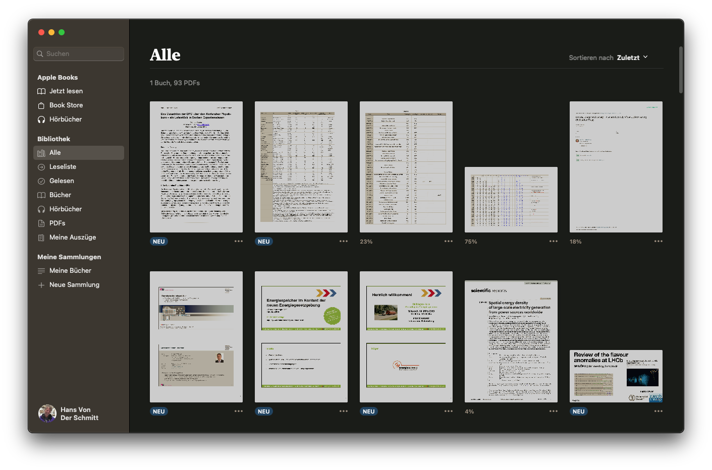

Thanks! On MBP5,2, installing 13.3b2 now over b1.
OTA update went unattended up to login screen.
Then as usual connected external keyboard/mouse via USB hub.
Applied post-install patches from latest OCLP 062n (10Feb), internal devices also work after that as usual.
13.3b2 works well enough as b1 did (ie Safari blank pages, Firefox as workaround).
This is NOT a recommendation to try 13.3b3
But just another test on non-metal MBP5,2 with 13.3 and OCLP nightly.
Installed OTA 13.3b3 over b2, using latest OCLP062n (today) which contains a new PatcherSupportPackage binary, to external SSD. KDK handling worked.
Went well. As before, Safari presents empty screen, using Firefox instead. Wifi works well, as before. Books cover images work now!

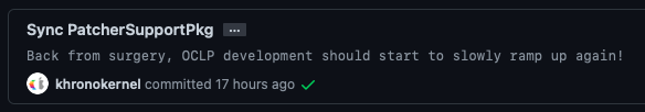

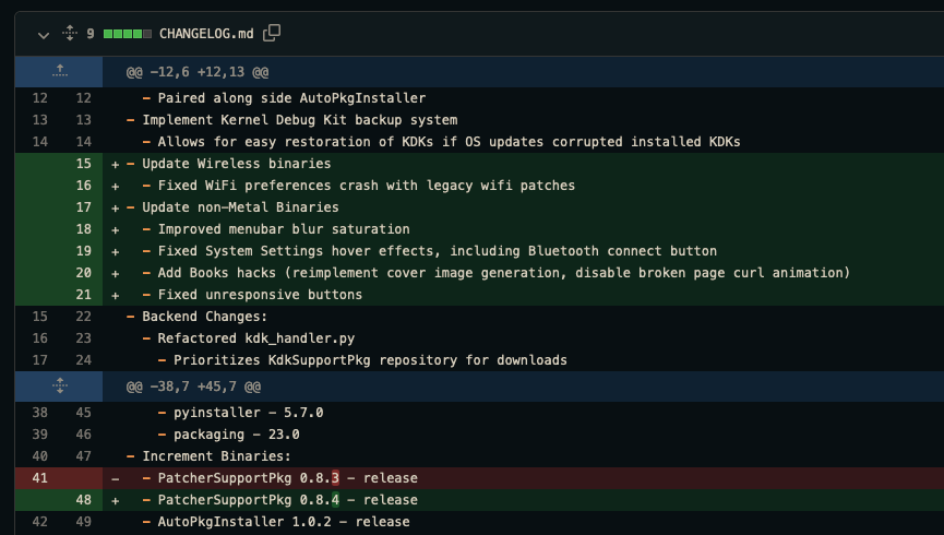

Khronokernel committed a new update to the OCLP github repo. First update in a few weeks. Very appreciative of all he does for us and looking forward to OCLP 0.6.2!
EDIT: I just realized I was late to the party. Thanks to @davidlv for first notifying us about the OCLP update here.
EDIT2: Saw this note in Khronokernel's latest commit. Glad you're back from surgery! Hope you have a speedy and full recovery!
