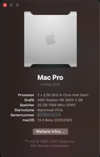

Currently, the KDK for build 22E5236f (13.3b3) seems to be corrupted (both on Apple developer DL and what OCLP tries to fetch). This leads to legacy metal unpatchability atm.
My workaround (fine for i.e. cMP with GCN 1 AMD R9 280X) is to rename the beta2 KDK sub-folder to ...236f.
OCLP then does its job without re-downloading the faulty KDK and 13.3b3 runs "as before."
edit: Mykola wrote he found the .dmg to be actually a .pkg and renaming seems to work. You might also try this instead of using the older renamed KDK.

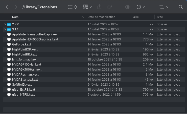

I have also some Nvidia kexts in /L/E (not all).
Reactions: deeveedee

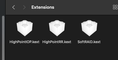

At the risk of asking a remedial question, does anyone understand why sinbad21 would have OCLP-injected legacy kexts in /Library/Extensions when running Ventura 13.2.1 and on my MBP6,2, I have no OCLP-injected kexts in /Library/Extensions nor in /System/Library/Extensions in Monterey 12.6.3 and Ventura 13.2.1? I used OCLP 0.6.1 to apply post-install patches in Monterey and Ventura. I didn't think that OCLP used /L/E or /S/L/E, but clearly I'm wrong. Thanks for any explanation.
My /L/E is as follows:

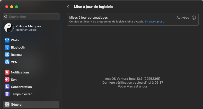

Several issues with, security patch (a) and (b) béta 2, not installing.
With 13.3 béta 3, OCLP post root patch issues with KDK download and installation with OCLP 0.6.2-nightly-version-before-latest.
Ventura 13.3 béta 3 installed and running on macbookpro8,1 with latest OCLP 0.6.2-n
Some issues on python3.11 building OCLP 0.6.2-n
