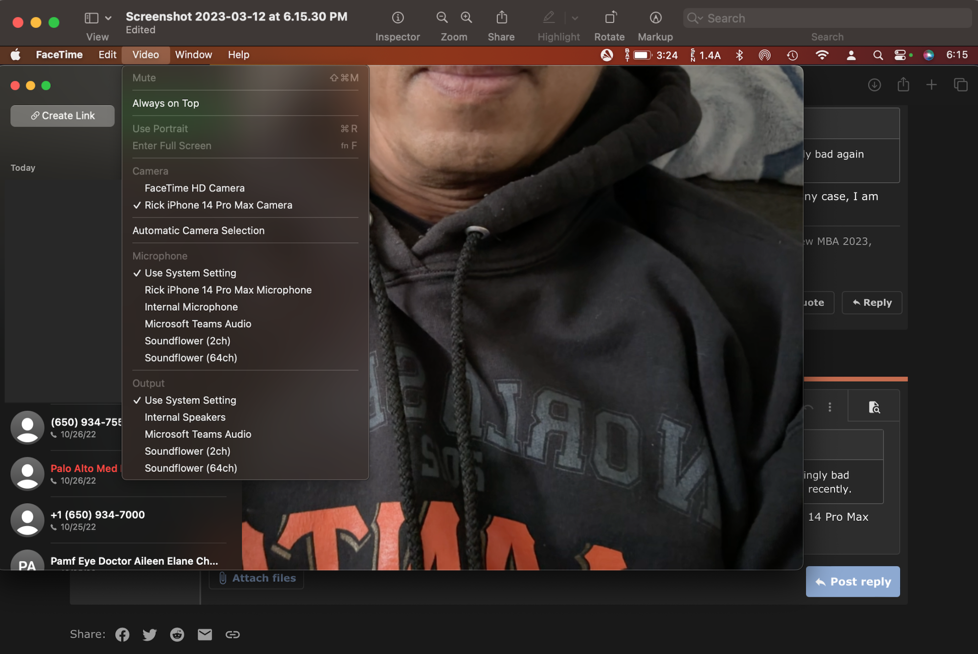

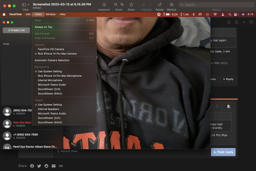

wow- latest self compiled build supports now…
  • Implement Continuity Camera Unlocking for pre-Kaby Lake CPUs
    • Applicable for all legacy Macs in macOS Ventura
  • but no notice about fix for 13.3 beta.
Works fine with my iPhone XR. Thanx to the developers for their hard work.

Continuity Camera Unlocking impressive OCLP devs got this working on macs where the webcam really is shockingly bad again amazing work to have pulled this off and the other massive amount of updates that have been committed recently.
thanks to all devs, i can confirmed its finally working latest OCLP 0.62n continuity Camera with my iPhone 14 Pro Max 12MP front facing camera paired with 2015 13" MBP (12,1) say goodbye to 720p MacBook pro camera.
