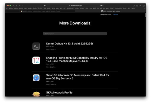

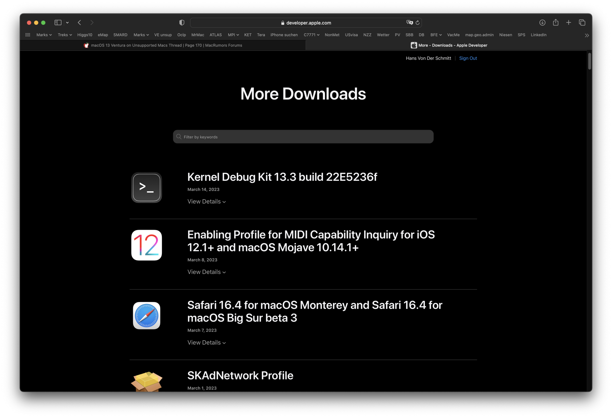

This is not correct. Apple fixed Kernel Debug Kit 13.3 build 22E5236f and offered a new one yesterday.
It is completely correct. In essence i said the same thing as "Apple fixed Kernel Debug Kit 13.3 build 22E5236f and offered a new one yesterday." I was referring to a prior post that said the Apple download was actually a pkg file, and not a dmg. When I downloaded it, as in that post you said was "not correct", I expected the KDK file was actually a pkg, but it wasn't. The OCLP 0.6.2n from 3-13-2023 actually worked after I installed the new KDK, but it tried to download the KDK and then the console said it didn't need that download and completed the root patch anyway.
The version released today fixed that entirely. That is why I said Bravo. Now do you get it?

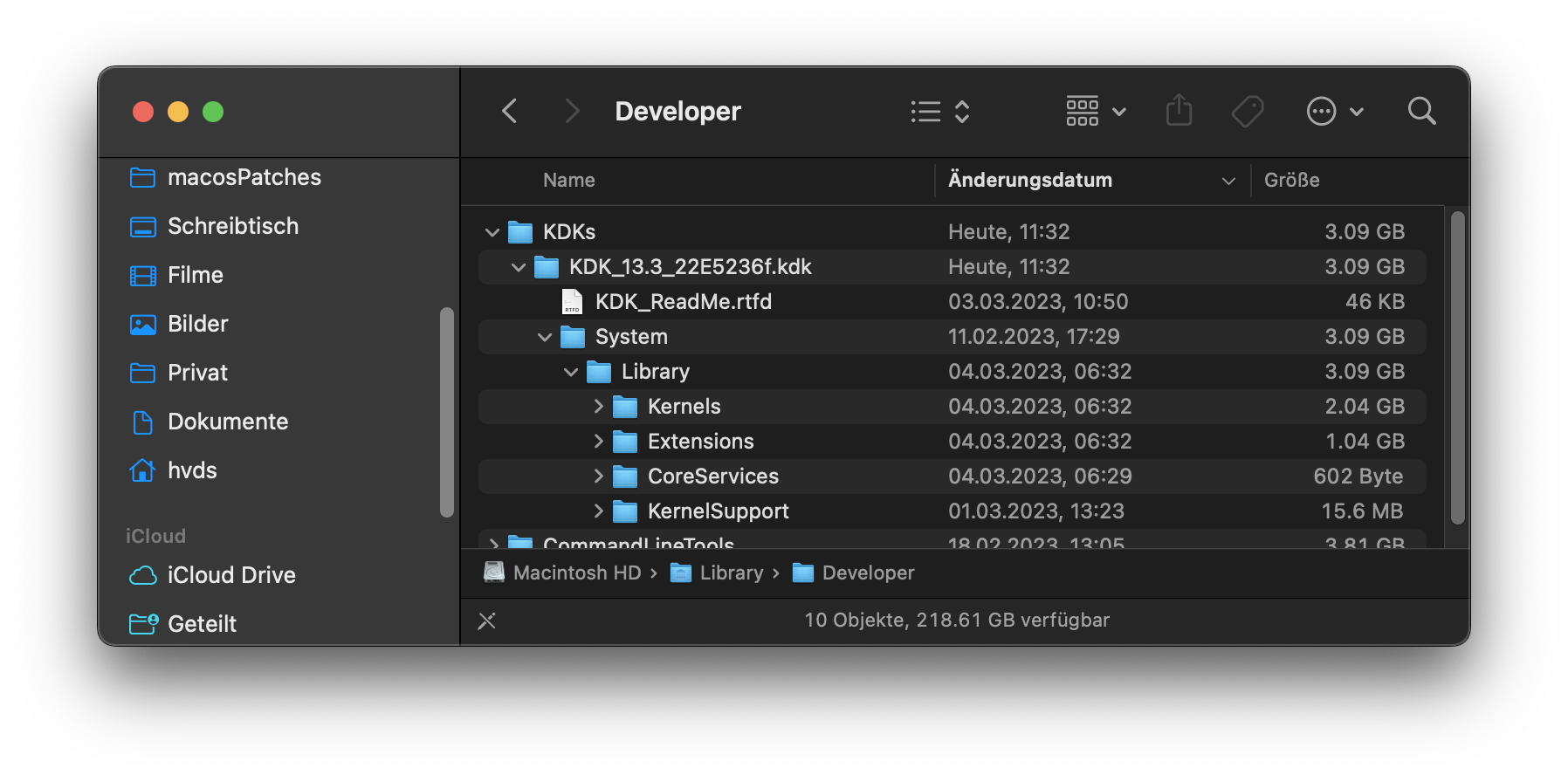

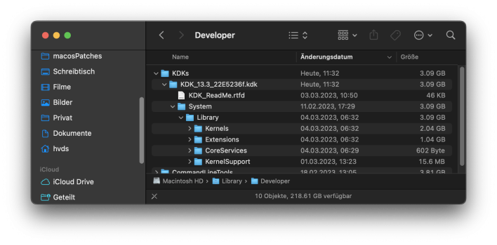

To confirm, manually downloaded the Kernel_Debug_Kit_13.3_build_22E5236f.dmg from Apple. It is the new one they provided yesterday. Double clicking it extracts the .pkg. Double clicking the .pkg installed KDK correctly to /Library/Developer/KDKs. Like it was with earlier KDKs and I guess like OCLP expects it, see install_kdk_dmg of resources/kdk_handler.py.
So Apple have fixed their mistake of providing a .pkg instead of a .dmg, and then calling it .dmg incorrectly.

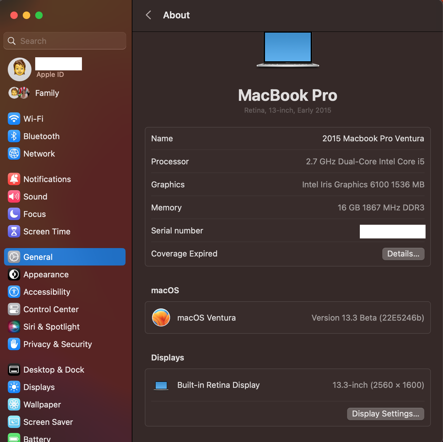

OCLP 0.62n Ventura 13.3 beta 4 no issues early 2015 13" MBP (Broadwell ).
