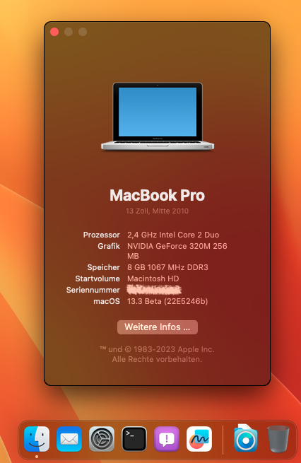

MacBook Pro 7,1 with Nvidia 320M graphics also running 13.3b4 fine with 0.6.2n patches.

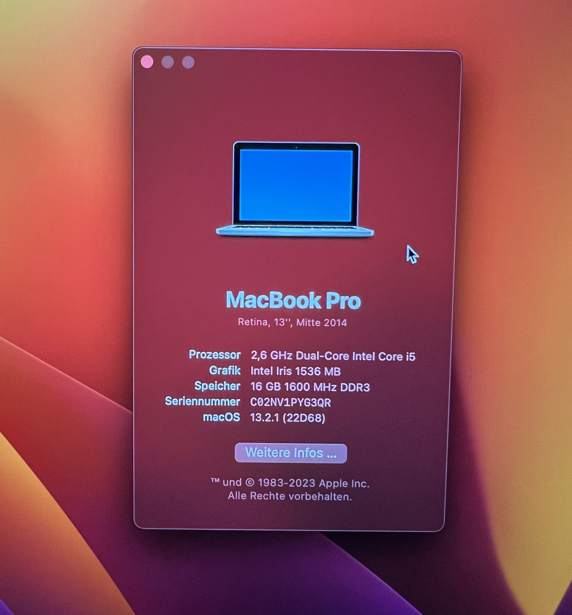

I have a problem with update from 13.2.1 to 13.3 beta 4 on Macbook Pro 13“ 11.1 mid. 2014!
After the update and installation of graphic drivers, it only boots up to half and hangs.What can I do!?
View attachment 2174702I have a problem with update from 13.2.1 to 13.3 beta 4 on Macbook Pro 13“ 11.1 mid. 2014!
Boot into safe mode and unpatch if you can get into safe mode hopefully you didn’t install on main volume patches are in development again 13.3 but not available or promise it will work yet no official release yet or wipe hard drive and go back to 13.2.1 .
Okay, thank you!
I have tried everything possible, but nothing has functioned.I am back now on 13.2.1
Then I wait for an official or a new version outside it works.

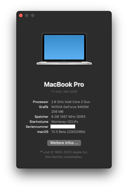

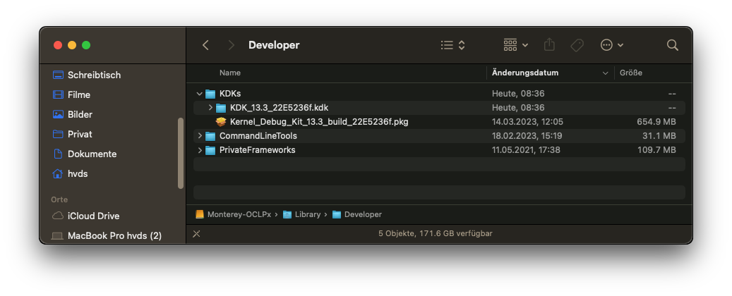

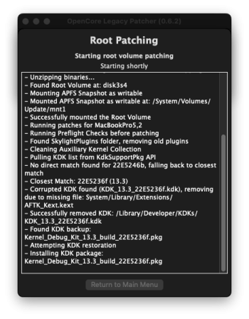

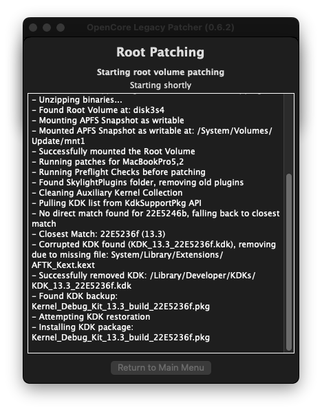

MBP5,2 (Penryn+Nvidia 9400M): same good result.
KDK handling re-installed KDK (which gets incomplete during 13.3b4 OTA installation) correctly from KDK backup.
As backup serves the .pkg file (if still present) which was used to install the KDK.

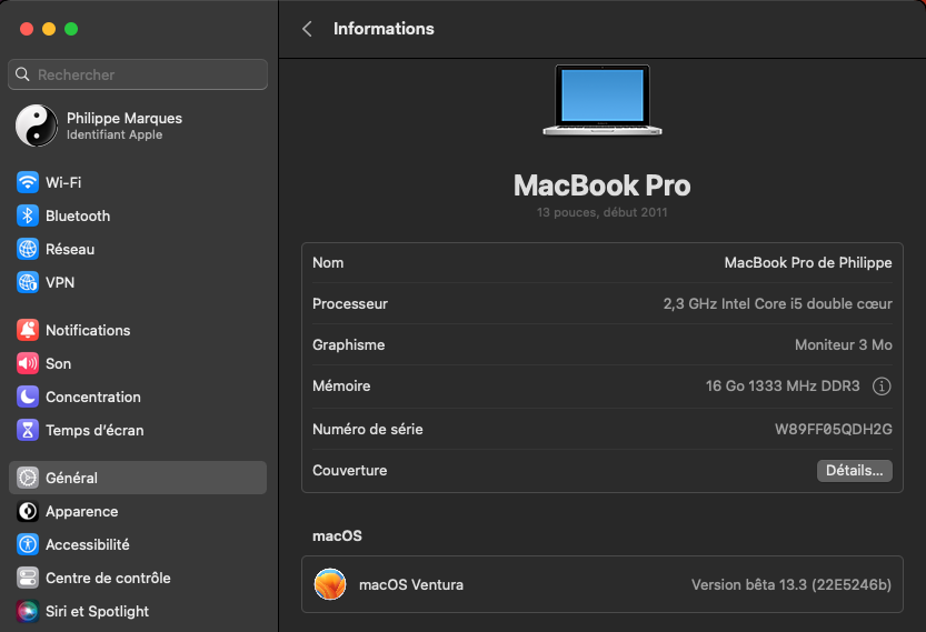

Some real big issues to update from Ventura beta 13.3 beta 3 to 13.3 beta 4 and OCLP 0.6.2-n 20230315
System hangs at boot, with, not all system installed.
Had to boot from another Volume, to see what's on the updated 13.3 beta (no data lost, just part of system, telling that system is crypted).
The only way to solve, reinstall from 13.2 and install reinstall full 13.4 beta, and it runs, now.

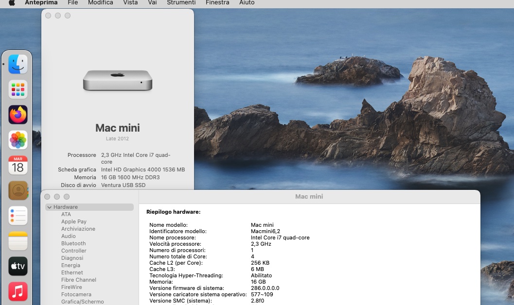

First i again thank all developers. Unfortunately at the moment no way to boot my mac mini L2012 on every 13.3 installation after root patch. I found something to boot them with i thing 70 % acceleration. There are 3 kinds of systems acceleration on unsupported macs. In the first just installed sys info shows 7 MB screen gray dock safari not working, but any other browser works and it is impossible to have custom background. The second, the one i found and use is with 1536 MB screen, monitor used described, gray dock everything works, all resolution displayed, all showed apps in apps folder works flawlessly except Safari. The third is Full one, with traslucent dock bar. I am going to test heavy apps like Final cut Premiere and others, at the moment i am able to play you tube videos also 8K ones, surf with firefox and as i dont work with it i accept it.

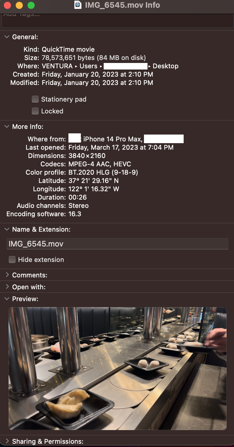

A strange thing with sidecar feature
Since 13.x I can't use sidecar, ipad nor show up for duplicate screen
As I update 13.3b2 to 13.3b4 via OTA 0.6.2n without OCPL post install patch I get the ipad in the menu to duplicate screen
So I figure out that could be a new feature os 0.6.2 I back to 13.2.1 in my secondary system, and apply 0.6.2n patch over the system but it doesnt work as I expect and ipad is not shown as duplicate screen
Then I reboot and select 13.3b4 as before, still without any post install patch applied because of the bug, but ipad is not shown neither in the system
Is there any news about sidecar option with Ventura an OCPL?
How is it possible that ipad was shown in a 13.3b4 system without post-patch applied?
