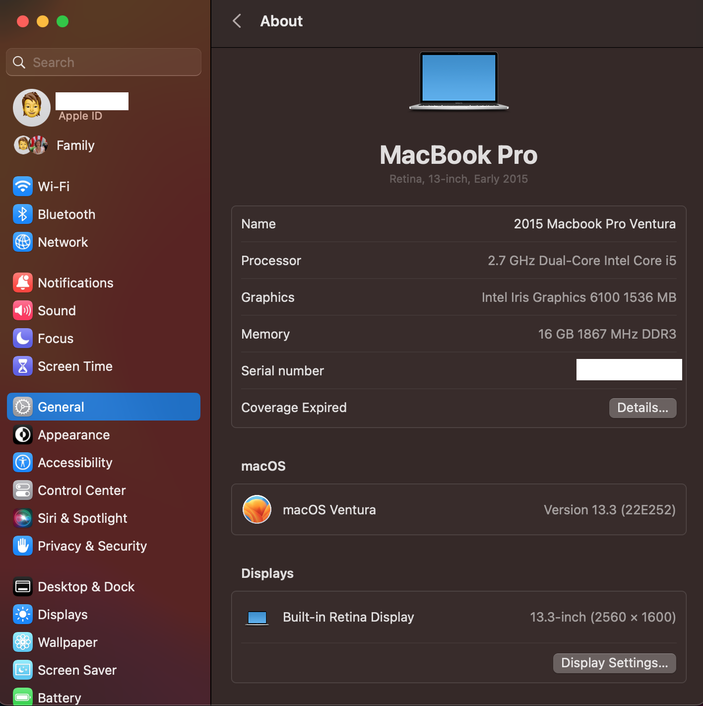

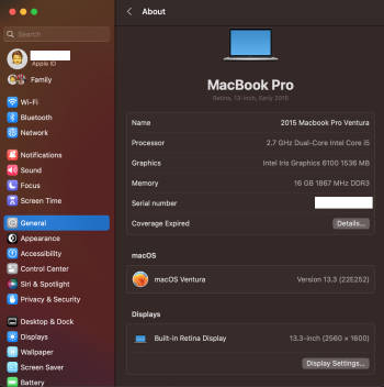

Ventura RC 13.3 2015 13" MBP OCLP 0.62n smooth buttery update.

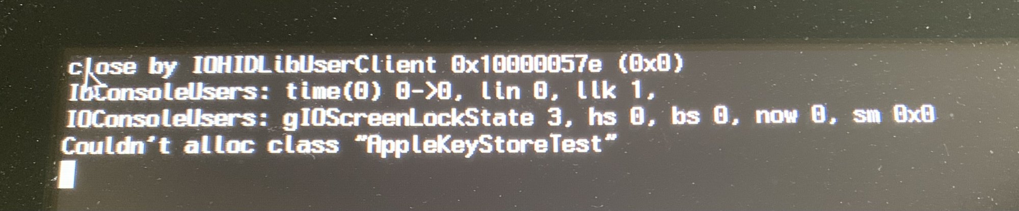

Issue after having successfully updated RC 13.3, rebooted and applied OCLP 0.6.1:
Stuck at this message. No login screen. Booting into Safe mode failed.

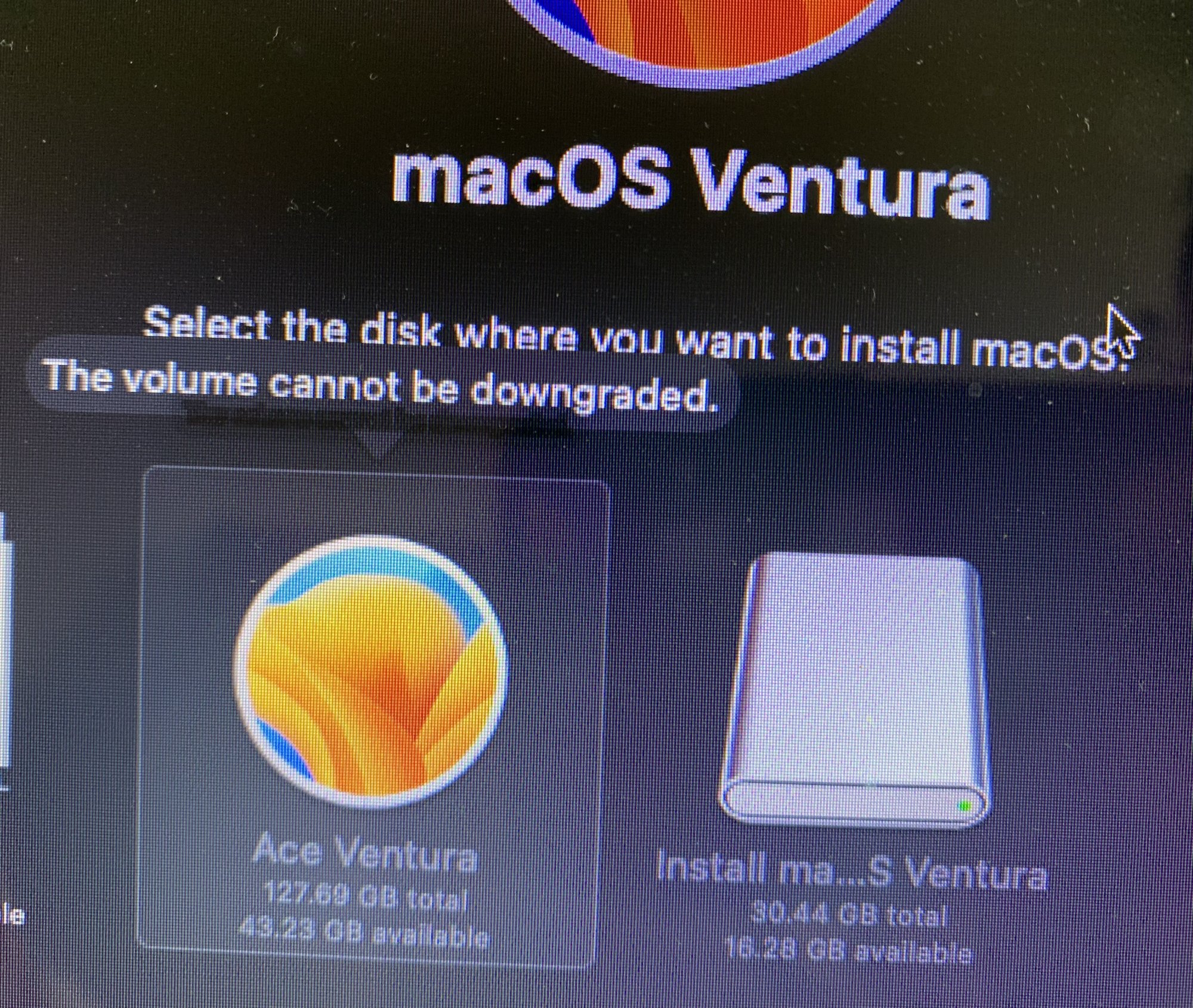

Read back through the posts here 13.3 is not supported in betas or RC should stick to 13.2.1 this has been mentioned many times you could try safe mode to unpatch system if you have data you need .
Also: can’t install 13.2.1 due to downgrade limit.
