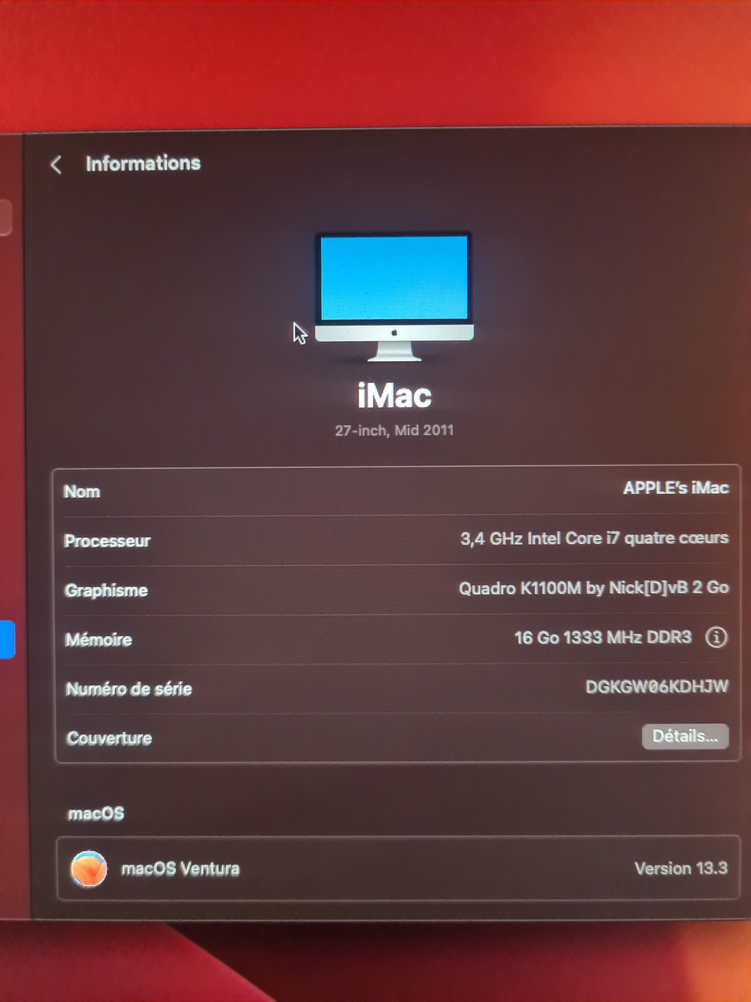

Hello Dastane I had the same problem. Ventura (different versions), USB sticks (different manufacturers) tried to install. Of course, the internal SSD was deleted first - Macos Ext.J. or APFS - Nothing.
I then installed Monterey 12.6.3 with OPLP 5.3 and it worked right away. Software update to Ventura 13.2.1 and everything was fine. Give it a try - I'll keep my fingers crossed for you.
I finaly get it
I had install high sierra os => install ventura 13.3 in HDD
It work very fine so i restaured in my ssd
Do all the patches
And all works fine

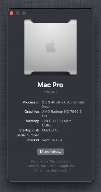

Successful install of Ventura 13.4 using OCLP 0.6.2 on my 5,1 MacPro.
Bluetooth still not working but I have wired keyboard and trackball to use. Also AppleTV locks up the OS if I try using it although I have not tried using it on 13.4 yet.
EDIT: I have been running AppleTV for the past two days in 13.4 and it has not locked up the OS. I am finding AppleTV is working very well on CMP w/ 13.4 installed.

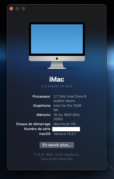

iMac 21,5 and 27 Late 2013 14.1 Successfully updated to 13.3.1 from 13.2.1. OCLP 0.6.3n (Rebuild open core & root patch (was 0.6.2), no issues.
Preview bug resolved
Photoshop crash resolved but not totaly, see ***
ALL Icons in system preference panel ok now 👍🏻.
So far so good.
*** Except Photoshop 2023 won’t open files because you have to choose the color profile embed or another and when you choose it hang at the choice…

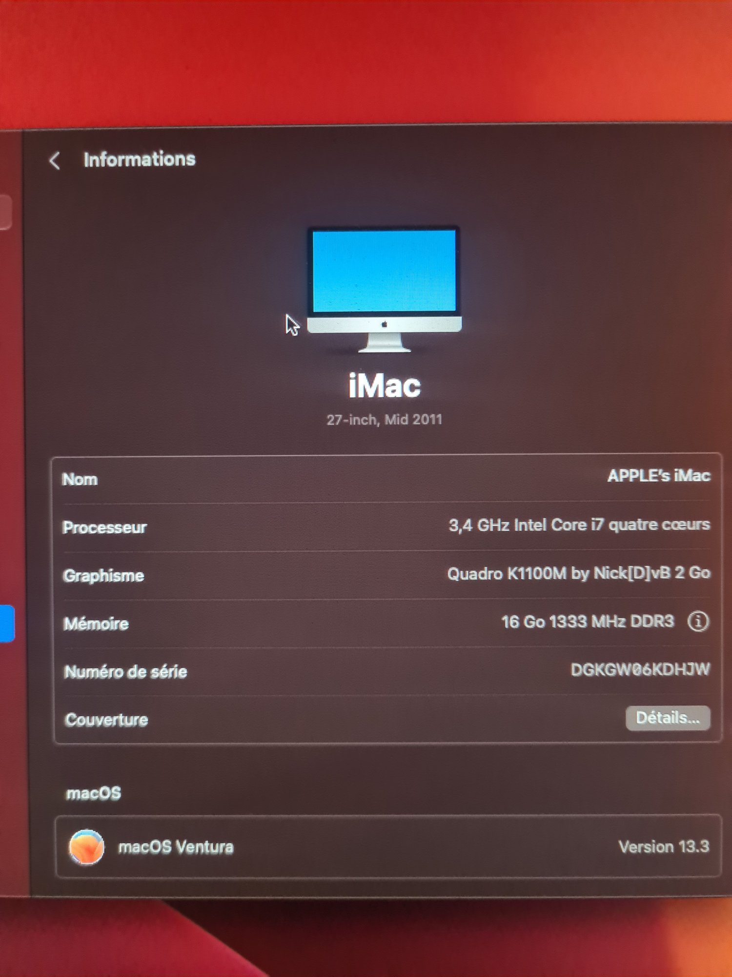

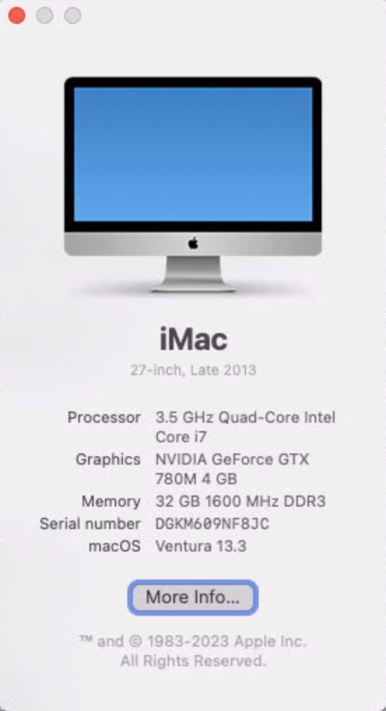

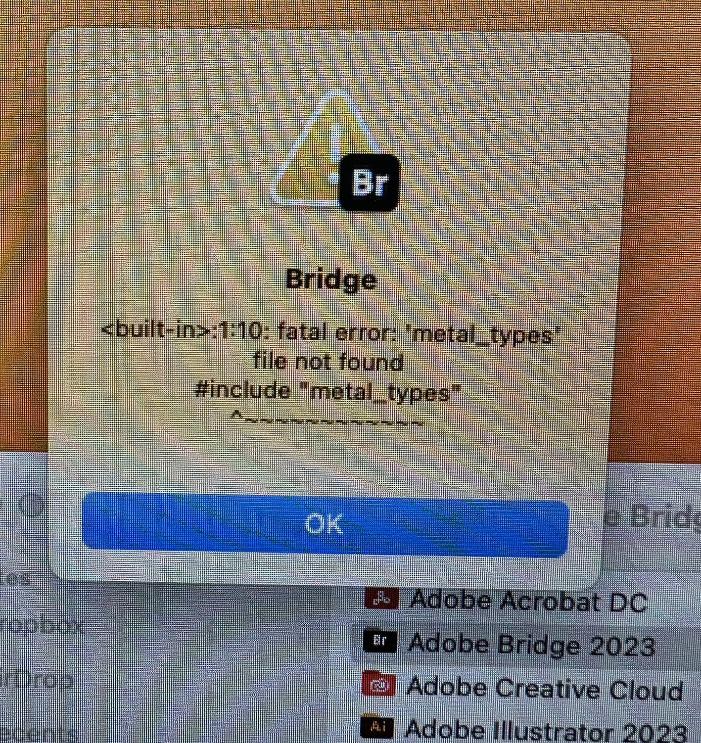

Clear nstalled on iMac 27 late 2013 (1 gb graphic card) with disk formatting ventura 13.3 via open core patcher 0.6.3. Everything works well, except does not display icons in the system settings, zoom can not get access sound and camera and adobe bridge of any version does not start (the licensed adobe package other graphic programs work fine, photoshop, indesign illustrator... Usb installer was created on a computer of the same line but with a different configuration. This is bridge error. Attach iMac profile on which the installation disk was created, the same problem with zoom but no settings icons render issue. Any ideas?
HI @StrongTequila! I also have your same iMac14.2 and although I am very expert I gave up on 13.3 and went back to 13.2.1 with which everything works fine, a thousand times better than Catalina and in a stable way (including the Apps) except "Continuity Camera".
If you also want to activate "Live Text" and "Remove background" you can follow the instructions I provide in a previous post, also explained with two very clear screenshots in attach. In fact, in our Macs, these features can be activated because in our case does not cause problems as in other Macs.
So after all, Ventura 13.3 does not introduce new features and therefore it is much better to have a modern and stable System with macOS 13.2.1 that works at 110%, waiting for the genius Developers of OCLP to fix all problems.
A little tip at end: if you use Photoshop you have to disable OpenCL acceleration in its Preferences, otherwise the advanced sharpening filter gives problems. Without OpenCL, however, PS takes advantage of Metal and works fine.
