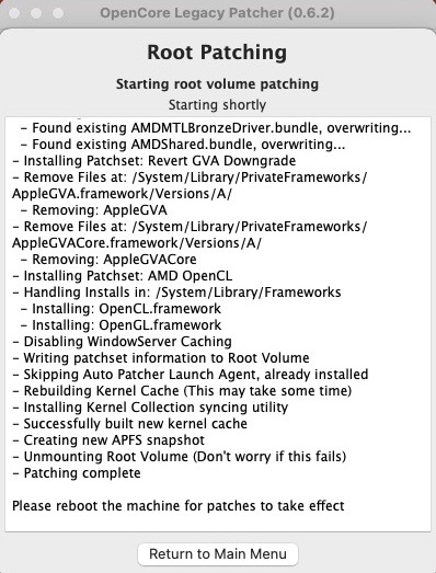

Update 13.3.1 (see #4745 above) offered in Software Update of MBP11,4/14,3. I undid the root patch, restarted, performed the update (about 1.3 Gb), restarted, applied root patch, restarted. Everything working.

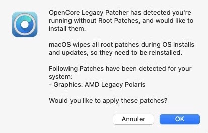

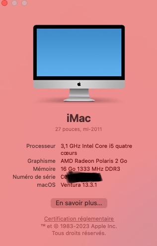

Upgrade OTA from Ventura 13.3 to Ventura 13.3.1 on my iMac 27" mid 2011 + AMD WX4130 (Dell) + BCM 94360CD , all is ok:

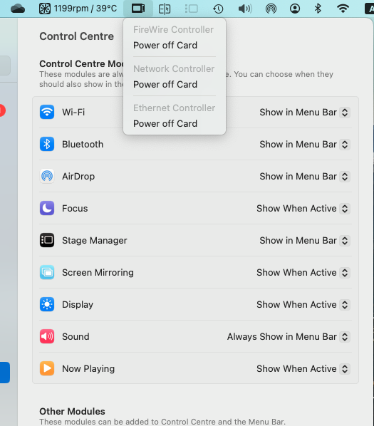

Updated from Monterey to Ventura 13.3 for my iMac11,2 M5100. All is good except for one extra menu icon for which I've never seen before. Any ideal?

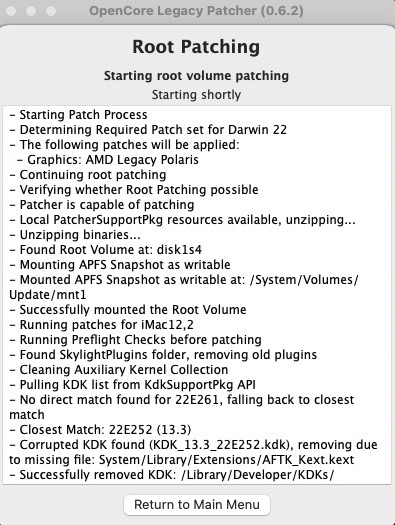

Add: Preview works, including for jpeg/png photos, together with "Remove Background" feature. And the latest OCLP 063n (root patches) has fixed my Kepler iMac12,2 Preview issue running 13.3. However, the "Remove Background" feature and "Live Text" capture are still not working on the Kepler iMac12,2.
Looks like the old express card icon to me...
Agree. But it never showed up in Monterey and there is no such slot in this iMac.
not worried, only a bit annoyed though 😅
Add: This iMac11,2 has an upgraded Xeon CPU. I suspect OCLP may have spoofed to something else which may lead to this extra icon. Will have a more closer look later.
