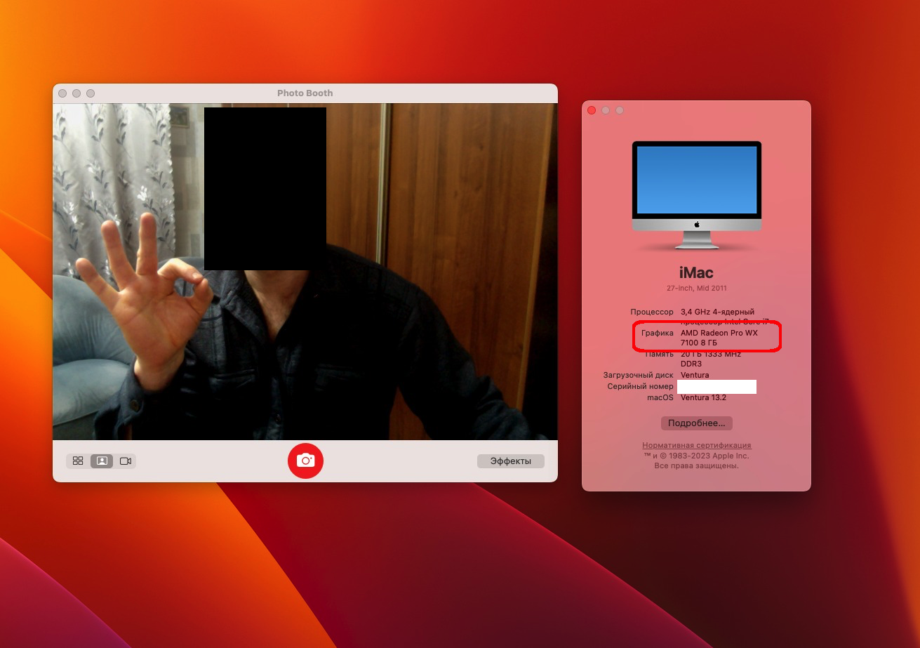

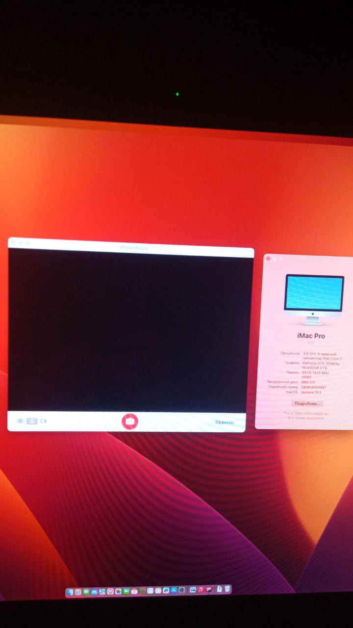

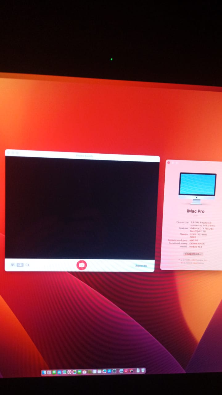

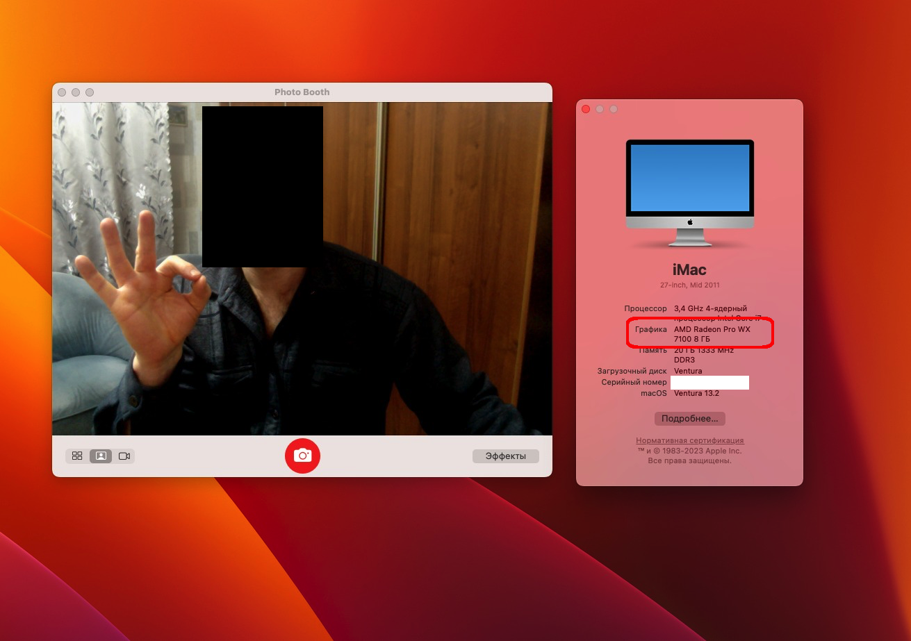

In the Venture system, the camera works if the video card is AMD.
If the video card is Nvidia, then the camera does not work. I personally checked!
Thank you for your kind clarification @idenis42.
However with Ventura 13.3 and OCLP 0.6.3 also “Continuity Camera” works in my iMac with nVidia GeForce GTX780M graphics card and 4GB VRAM.
As I mentioned in my previous post though, I've reverted to Ventura 13.2.1 due to other Metal issues; waiting for the OCLP Developer Staff to overcome the new obstacles that appeared with macOS 13.3.
Reactions: macpro_mid2014
Yes, I understood that. I just wanted to confirm and share my experience :)

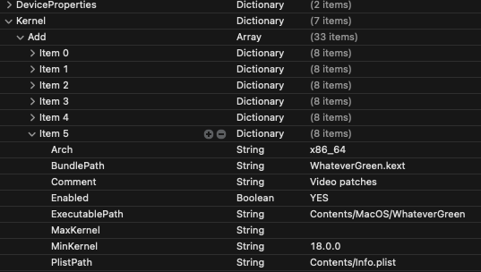

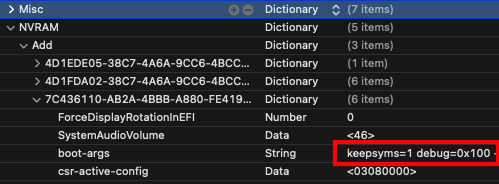

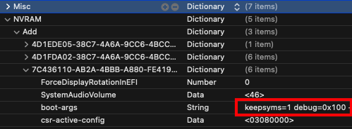

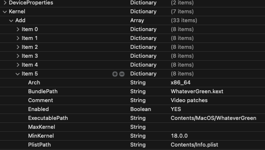

@Bmld, -wegnoegpu is a boot argument for WhateverGreen.kext. If your Open Core EFI includes WhateverGreen.kext, then adding the boot-arg is as simple as adding -wegnoegpu to the existing list of boot-args in your Open Core config.plist:
If your Open Core EFI does not include WhateverGreen.kext, then you'll need to add the kext to your EFI/OC/Kexts folder and inject WhateverGreen.kext via your Open Core config.plist:
If I'm speaking a strange language to you, then this will be a good learning experience.

On Ventura 13.2.1 with Opencore 0.6.1, MacBook 15" 2012
I can confirm, the Finder is causing all these trouble, I relaunched the Finder but the problem is still exist!
on MacBook 15" 2012, Ventura 13.2.1 with Opencore 0.6.1
here is the report from Console:
Code:

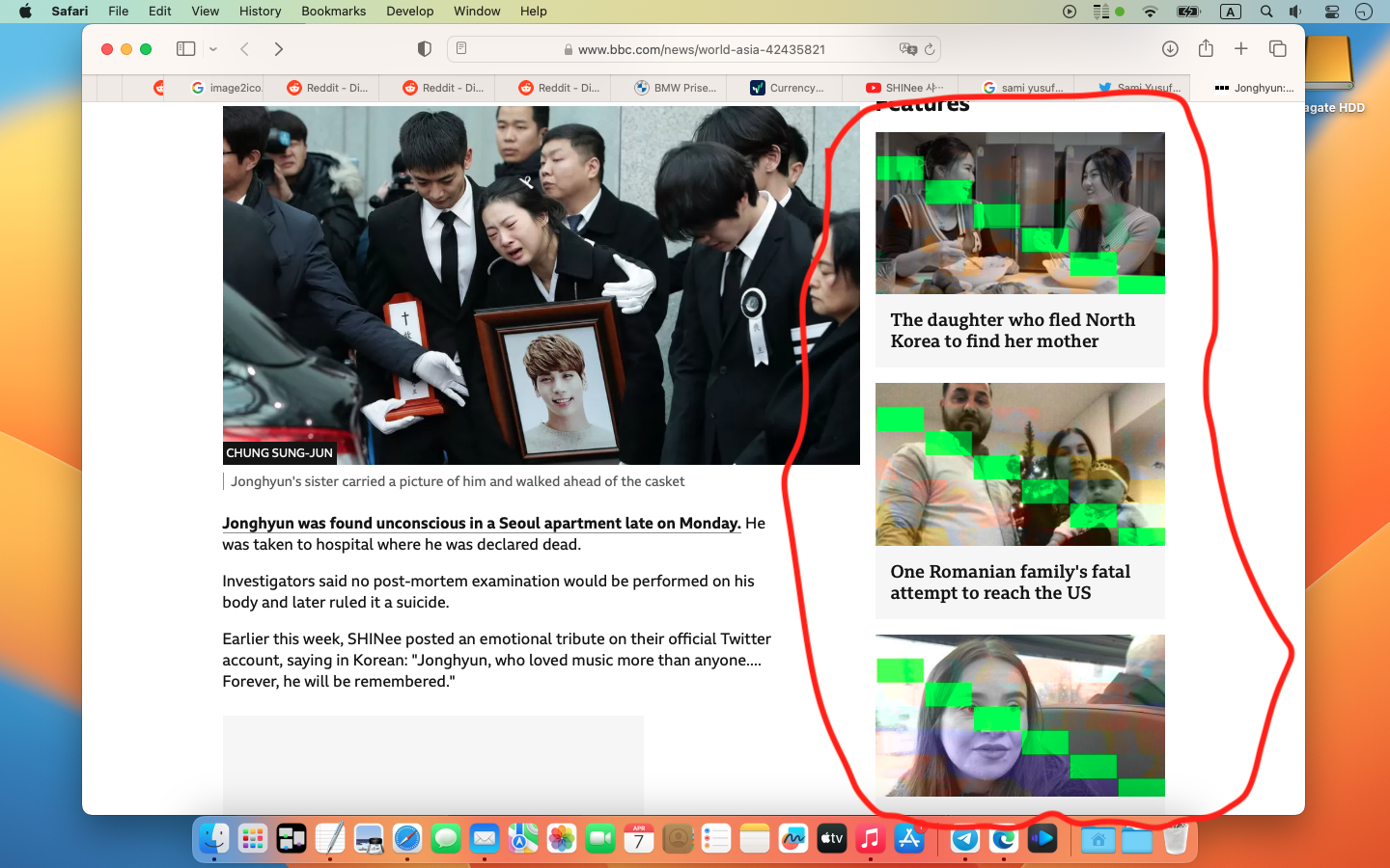

I've been recommending Safari Technology Preview for those having Safari issues. Well, this had been working fine until the most recent update (Release 167, Safari 16.4, WebKit 18616.1.8.2). Now I'm having problems fully loading web pages, general sluggishness, problems typing and scrolling, etc.
Maybe ad blocker issues? Or just Apple quality control maybe...
Other browsers work fine.

A lot of users had and have problems with Kepler and Ventura 13.3 - would it be possible to upload some error logs from the Console app?
Just open Console app, select the crash reports on the left hand side menu, now select one report and right klick -> show in Finder and this folder opens magically ( /Library(Logs/DiagnosticsReports ).
Find those reports with a Shim.dylib entry as shown on this post.
Please compress those reports (the ips files) and please upload here. We will collect them.
Thanks in advance!
MBP 6,1 with 13.2.1 and OCLP 0.6.2 root patches done just over a month ago.
i think OCLP 0.6.3 (nightly build) will fix this bug in Safari:

Even if my MBP11,3 has a Kepler dGPU, there are no diagnostic reports with Shim.dylib: strange… Anyway, the problems with 13.3 and 0.6.2 are the usual ones: Preview shows only a grey background when opening images; and Parallels Desktop, VMware Fusion and Oracle VirtualBox won’t start or resume VMs, due to AMFI being disabled (for now). Let’s hope that all this - and more - will be solved, eventually…
Thanks in advance!

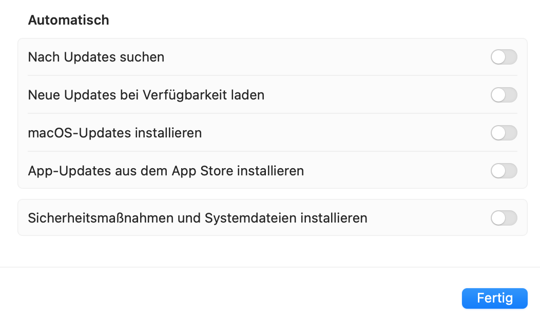

I will - because right now my 9,1 decided to install 13.3. And this time I am absolutely positive that I didn't play around. Automatic updates were disabled. The only thing I did was to install a MacFuse update. Rebooting 13.2.1 failed a couple of times. I did a PRAM-reset (could that possibly reset the the system update settings?). After that there was one more reboot and then I read something like "About 6 minutes remaining..." and was welcomed by 13.3.
Everything worked well so far - but I had preferred to stick to 13.2.1 for the time being. 10,2 back to Monterey, the 9,1 will be my 13.3-explorer. Hoping that AMFI might return...
EDIT: First major issue found. After this update Seafile won't launch anymore. AMFI-related? In that case I'd return to Monterey with the 9,1 too.
EDIT 2: What's happening? I was still in the course of setting up my 10,2 in Monterey, when all a sudden all apps quit. The computer shut down - and a quarter of an hour later I was back on Ventura. Am I the only one stupid enough not to control the update settings effectively? At least my TM backup on Monterey had finished... And I might as well play around a little bit on the 10,2 to look for other issues.
EDIT 3: See the screenshot. My 10,2 after it went from Monterey to Ventura. All updates disabled - after it went from Monterey to Ventura without my doing. 🤔
Hello Makra and all,
Have had the same exact problem as you on my 9,1, exact same self-initiating of updates. Difference, I was installing an update for Boom 3d (4.x) when all of a sudden after the required reboot post install, I found my self in a lengthy install ending up with 13.3. It works fine but for Powerpoint and Parallels Desktop crashes/launch failure as others have posted in the forum. Since I need those apps in particular, I have reinstalled from scratch (reformatted SSD), installed 13.2.1 and then migrated the usual suspects using Migration Tools which doesn't migrate everything (had to put back some .mbox (on my Mac) and Office templates manually, etc- no biggy, just a hassle. I still wonder like you what can push the MacOS to unilaterally decide to install upgrades on its on. I know the Crew is working on 13.3 for the "Kepler" gang and this will go away, maybe related to our Kepler??? Cheers
Reactions: makra
@deeveedee Many thanks for this! Exactly was I was looking for so feeling lucky ;)
Would you mind commenting on the ExecutablePath should be different if my OCLP is on it's own volume named "OCLP"
(Win multiboot reasons) . Should I change the paths then to the EFI/OC path?
There is some issue with graphics? the intel HD 4000 and nvida 650M are same with this problem?
This happened in Photos app too. any ideas? on MacBook 2012" ventura 13.2.1 with opencore 0.6.1
here screenshot:
I too installed 13.3 on my MacBook Pro 13,2 (2016, 13" only Intel GPU) yesterday with 0.6.2 and am running into issues with x265 in IINA. When I disable hardware acceleration it works with no issues but obviously uses a lot more power and resources. FaceTime doesn't work for me at all with video. I think that Continuity Camera also uses x265 hence why it freezes FaceTime on my machine.
I am replying to myself in search of answers. Can I use the EFI folder already prepared by OCLP, add the WhateverGreen kext, spoof the HD 550 (in my case) to HD650, and make the necessary edits with ProperTree to the config.plist?
You are very welcome. The "root" of the ExecutablePath (e.g., Contents/MacOS/WhateverGreen) is the Contents directory which is in the Kext (which is a container), so there should be no difference in your ExecutablePath. If you're curious, examine the contents (Show Package Contents) of the kext to see what I mean.
Reactions: perez987 and houser
The EFI folder prepared by OCLP obeys all the principals of Open Core (it is an Open Core EFI). After OCLP prepares an EFI, you can modify it in whatever way you want, as long as your mods obey Open Core principals. After you make your mods (e.g., adding WhateverGreen (WEG) to OC/Kexts and adding WEG to config.plist > Kernel > Add), you should run Open Core's ocvalidate Utility to verify your config.plist mods. Note that just because you can modify the EFI and ocvalidate confirms a valid config.plist, that doesn't guarantee that your mods will work for your rig.
Short answer - if adding WhateverGreen and spoofing HD 550 is correct for your rig, then the answer is 'yes.'
