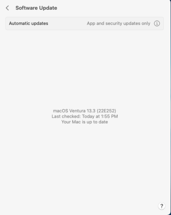

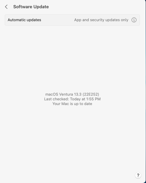

I currently have OCLP O.6.3 installed on a Mac Mini 3,1 (Mac Mini late 2009) with macOS Ventura 13.3. When I go to 'Software Update' I do not see an available update to macOS Ventura 13.3.1. I'm hoping someone could offer some guidance as to why this would be the case and how to address this issue, if possible.
You could always download through OCLP or from here:

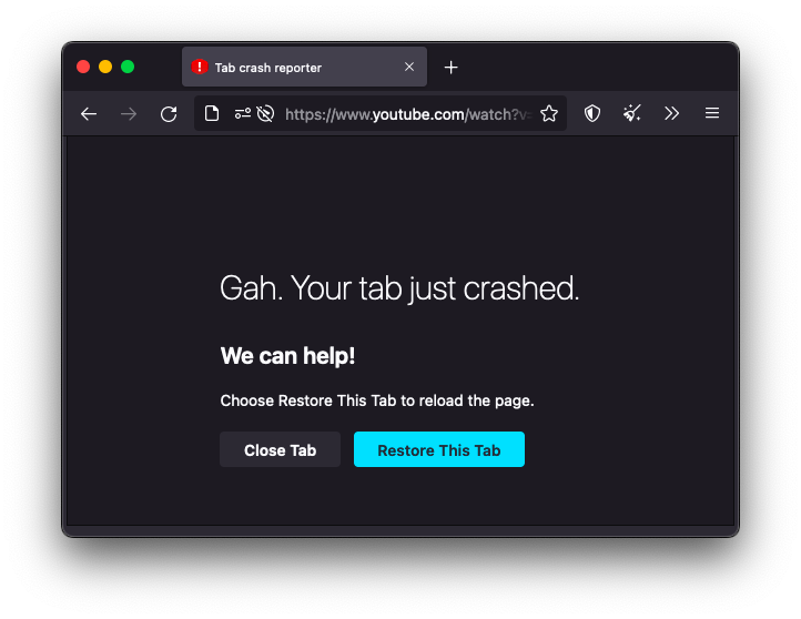

just updated to 0.6.3 .. App Preview came back to work fine with every extention BUT (damn'it) now Youtube doesn't work in any browser, Wmware Fusion continue to refuse to start the vm, and it's impossible to use camera and microphone with any video app (skype, google meet and so on) because apparently they didn't succed to ask permission to the system (Settings > Privacy > Camera/Microphone is empty).

Ok folks,

ÀMFI is the cause, if you are still on 13.2.1 just install OCLP 0.6.1 and don't update to 13.3.1

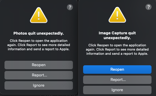

13.2.1 and OCLP 0.6.2 (reverted). Still getting paste text errors with Messages. But I can paste text into Finder, Text Edit, Safari no problem.
Tried to copy text from Messages crash log to here, crash log crashed upon copy, ha!
I see if I right-click to paste into Messages, all is good. It's the keyboard combo that's bad.
Firefox crashes with Command-t or Command-v. Right-click paste is OK.
Reactions: iPlasm

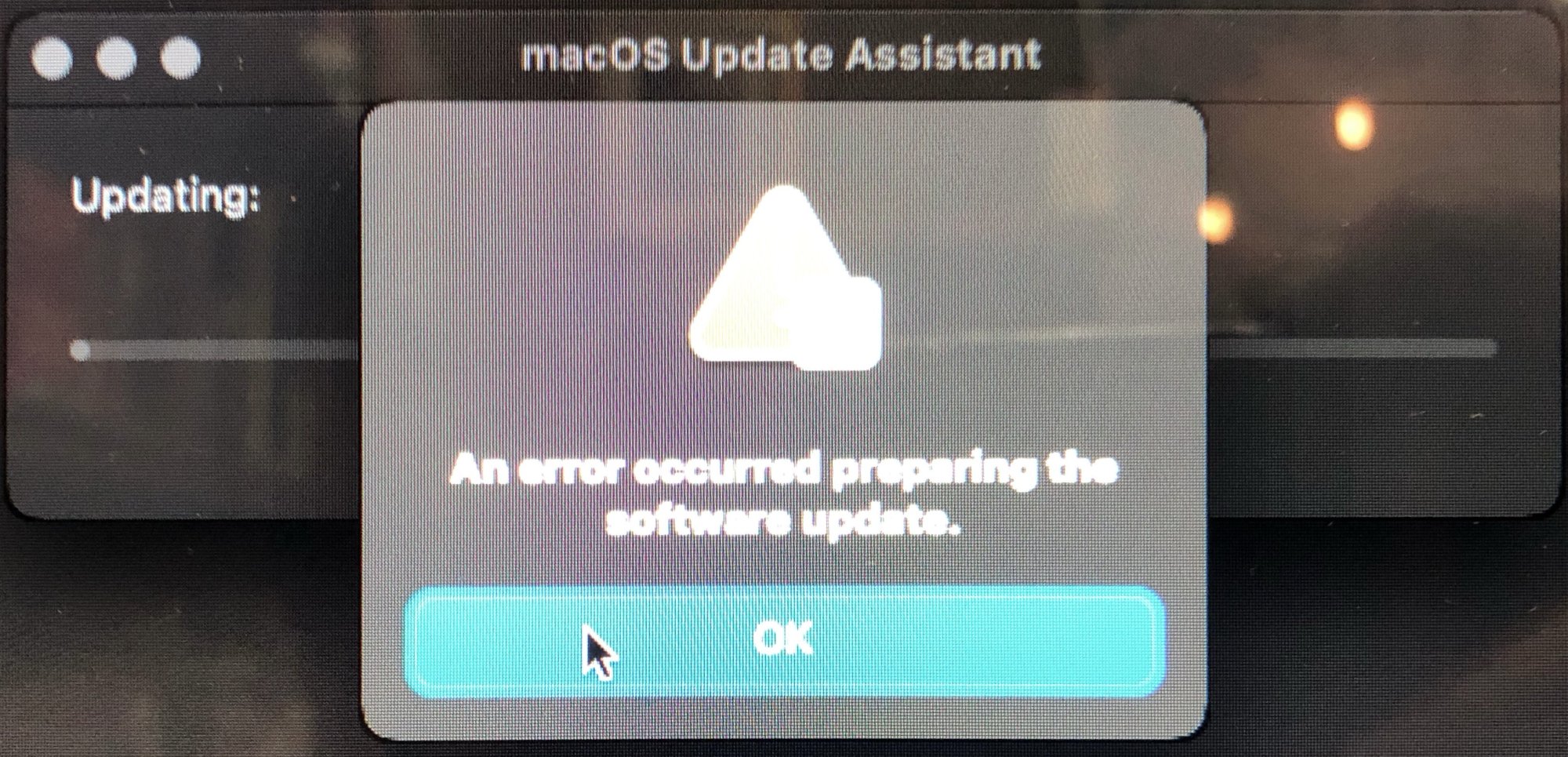

Successfully installed 13.3.1 for a non-metal iMac10,1 with OCLP_063 and an OCLP generated installation USB flash drive on a newly created internal Samsung EVO860 SSD partition. The installation was very smooth that it booted up with the root patch applied automatically. Ventura runs very well for my needs (basic stuff), thanks to all the developers for the excellent work, particularly the non-metal part of the development.
Also like to point out that the same installation to a Samsung external T5 SSD always failed at the second installation phase never completes to 100% (“An error occurred preparing the software update” message appears with less than a minute remaining!) with the "macOS Update Assistant" window in the background. The external T5 has multiple partitions and I've tried to Erase/Add/Merge APFS multiple times which did not make any difference: it always failed at the same spot (time consuming as well because it took long time to get to that point). Not sure if it's partition related or AVX2.0 related issue. But the fact that Ventura installed successfully to an internal SSD indicates this issue may be partition related.

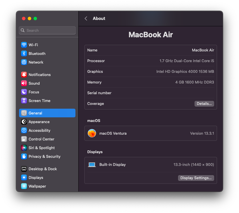

With 12.3.1 and OCLP 0.6.2 reverted from 0.6.3 on MBA 6,1, I'm having sudden weird issues as described earlier, including crash warnings after quitting apps (because I am using the keyboard shortcut, which causes the crashes).
I don't think going to 13.3.1 is going to give me less issues, maybe I need to go back to 0.6.1?

Also, I ALWAYS have issues ejecting external hard drives. It's usually QuickLook hanging things up, but right now I saw this:
I still don't understand why OCLP moves itself to this App Support folder, that seems very odd.
Moved OCLP back to Applications, deleted the App Support version.
Still on 9.6.2, re-enabled AMFI, rebuilt OpenCore, rebooted.
Fusion now opens, oddly AMFI is disabled again somehow?
Whatever works... I'll see if the key combo crashes return.

try other Command <shortcuts>. In my case they are causing the application in foreground to crash unless the application has an application specific command to the related shortcut.
e.g. Safari command x , or command up arrow ....
