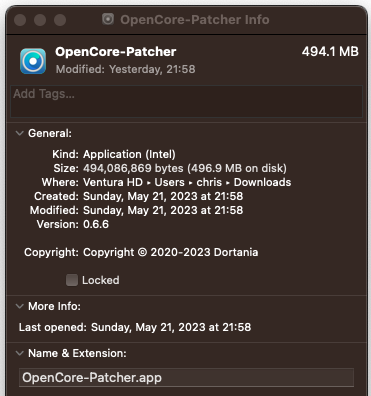

The link (see post #5781, https://github.com/dortania/OpenCore-Legacy-Patcher/blob/main/SOURCE.md) has a blue link to the GUI. That is always the latest version. No need to go searching around. As far as I know, the latest version is dated 10:58 am, May 22. (Edited)I downloaded the OCLP 0.6.6 and installed open core & root patch but I will try the updated version you mentioned but excuse me if I clicked the link you provided to me before I will get the updated version 0.6..6n or there is a link for it because I can't find it on github so it will be kind of you to provide me with link of the newly updated version 🙏🏻

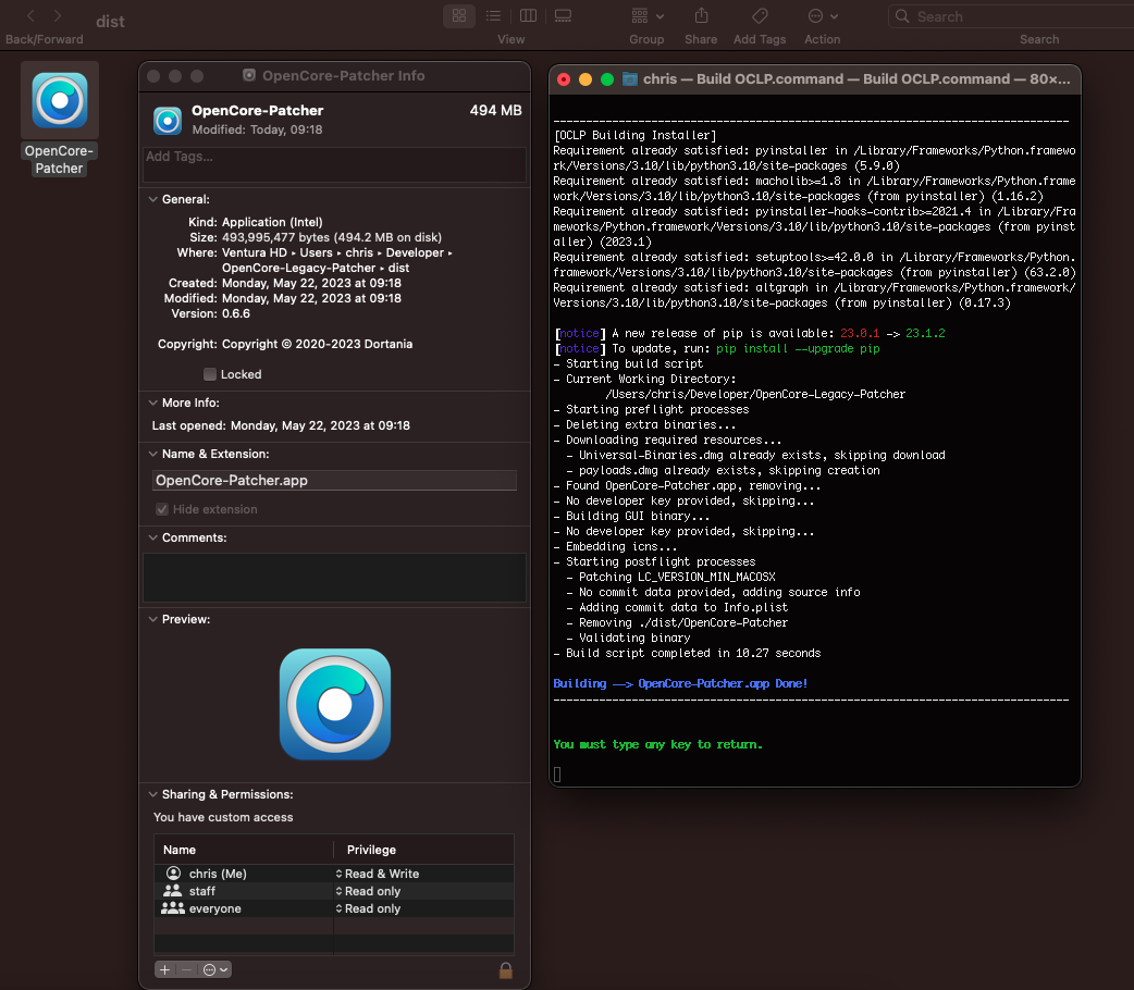

I just re-downloaded it, the latest is dated May 22, 10:58. Your copy is a day old.@davidlv Created Sunday, May 21, 2023 at 21:58
Commits on May 21, 2023
@davidlvI just re-downloaded it, the latest is dated May 22, 10:58. Your copy is a day old.
