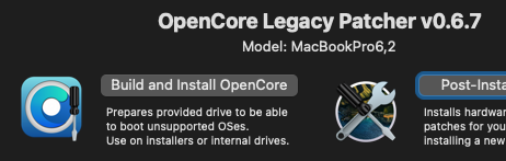

I can't really test it if it won't let me install OC the button is greyed out, same thing also on my Probook which I already have OCLP 0.6.6
@chris1111 - not sure if this helps you, could it be that you are choosing an SMBIOS model that OCLP doesn't think needs to be patched (OCLP is detecting your hack as iMac18,3)? When I run OCLP 0.6.6, I don't see any SMBIOS models after iMac17,1. Just to test, if you choose iMac17,1, is the button still greyed out?
Press “settings
In “Target Model” select MacBookPro11,1
In “SMBIOS” section set SMBIOS Spoof Level as “Advanced”
Set SMBIOS Spoof Model as MacBookPro14,1
Press “Generate S/N MacBookPro11,1 and then return main page
Now you can see “Build and Install OpenCore” is active.
I have already test this it does not work
thanks anyway

Strange. I, too, have a hack. When I select my SMBIOS model on the Settings screen (don't leave as "Host Model")
The button is no longer gray for me
Going with the readme first point on the beta test
•You must be building OpenCore on the host (so you cannot be building the EFI for another device)
So it may be disabled when picking yourself on purpose for the test being in beta creating to many issues or at least that’s how I read it as OCLP will automatically pick for you.
In some hack's the smbios is displayed correctly. In others is the name of motherboard or OEM name.

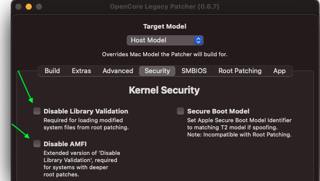

In my Probook 4540s, Ventura 13.5, patch rooted, AMFI and Library Validation are enabled! Thanx a lot, dev's! I'll report about other 3 legacy MBP and a few legacy hack's.
