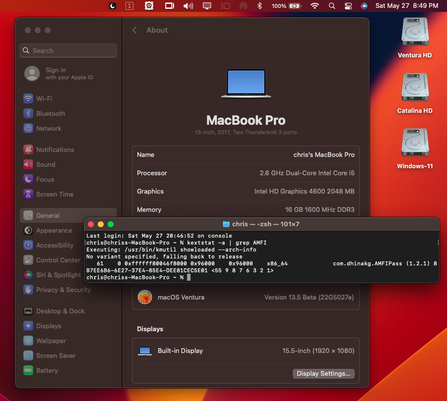

I use the Binary kext AMFIPass.kext with my EFI, no OC install from the patcher, only RootPatch from AMFIbeta2
Good news
