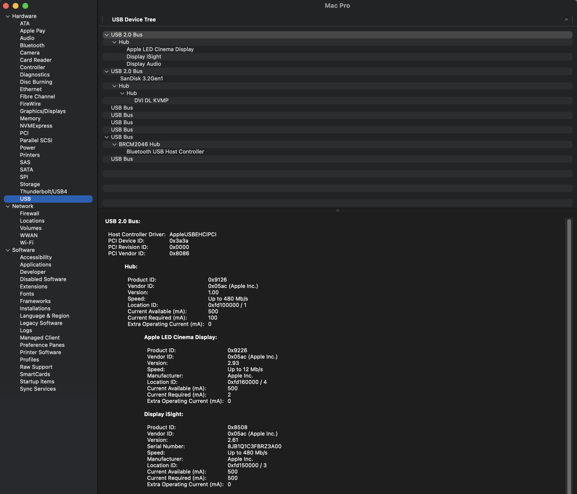

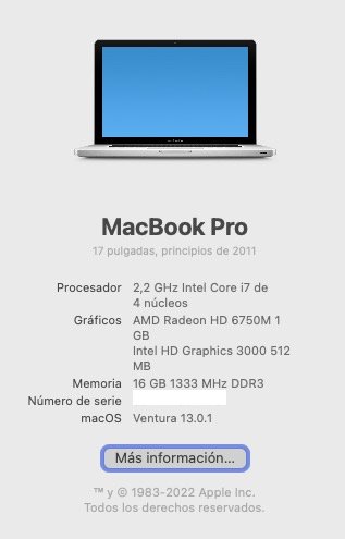

USB hub is still needed for Macs with USB 1.1. Any USB 2.0 hubs should work.
We couldn't get display output with Navi GPUs on non-AVX Macs. No idea if we'll ever be able to get it working.
Well then according to my system report I should be good?
Low power devices like keyboard, mouse and the bluetooth card runs through USB 1.1.
So I do need a hub- ok - does it matter which port ?

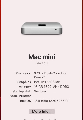

reverted patches on 13.5 beta 1 . OTA to beta 2 at 771mb went through no problems and then patched again using AMFIPass Beta.
AppleTV works on new episodes but normally have to patch with OCLP reboot , login then reboot again and then it will play episodes after first reboot after patching box pops up then disappears second reboot plays fine.

Same here, OCLP 0.6.7 didn't work with AMFI enabled and Validation Library enabled; reverting to AMFIPass Test 2 everything was back to normal, working like a charm.
macOS Ventura 13.5 beta 1
AMFIPass Beta
Reactions: hvds
AMFIPass Beta
OCLP 0.6.7 Release does not include AMFIpass kext.
This is why enabling AMFI does not work when using the release version.
Dhinak told on Discord a third beta version will be released at some point.
So, if you need AMFI enabled, stick with AMFIPass Beta2 for now.

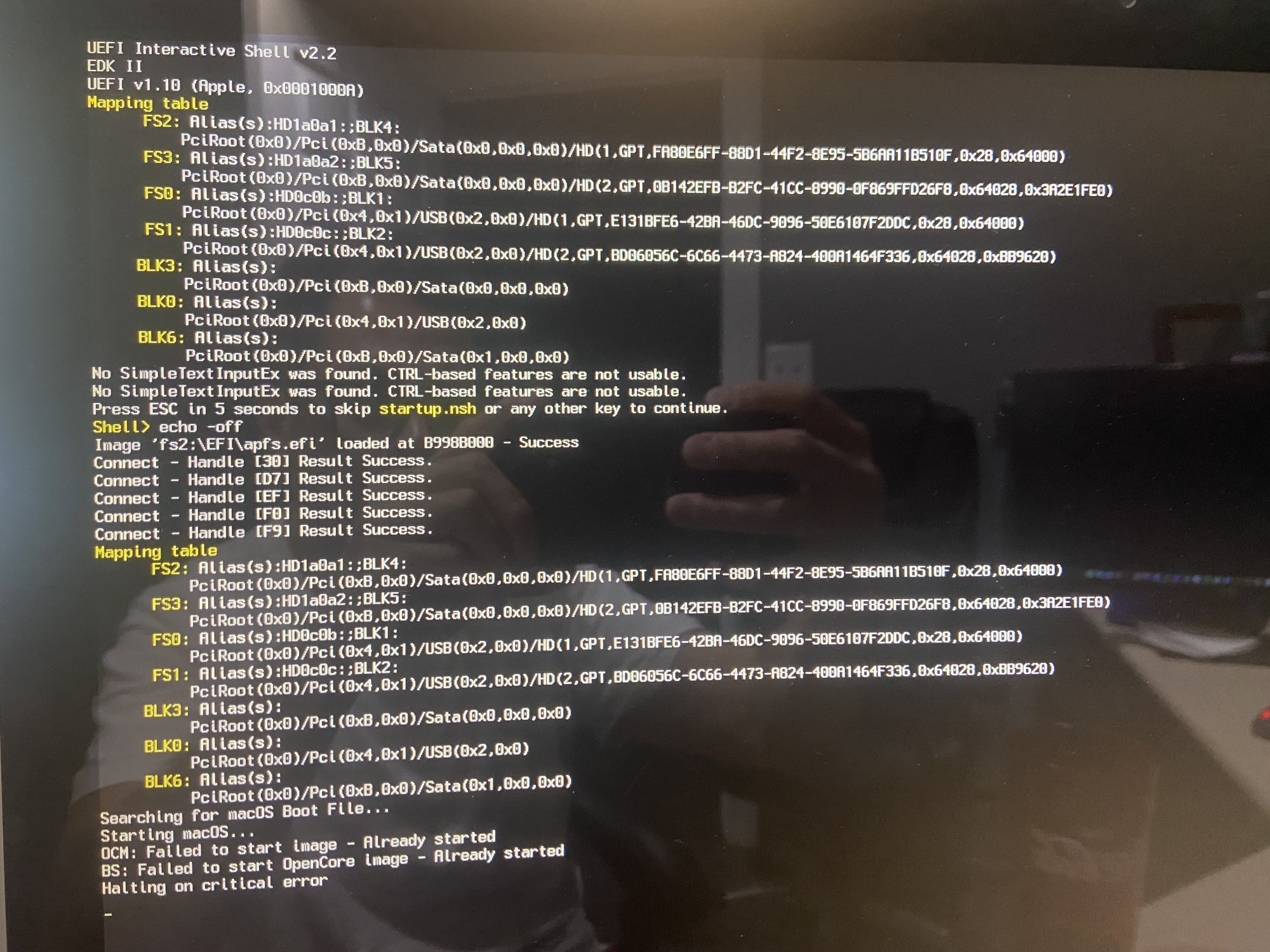

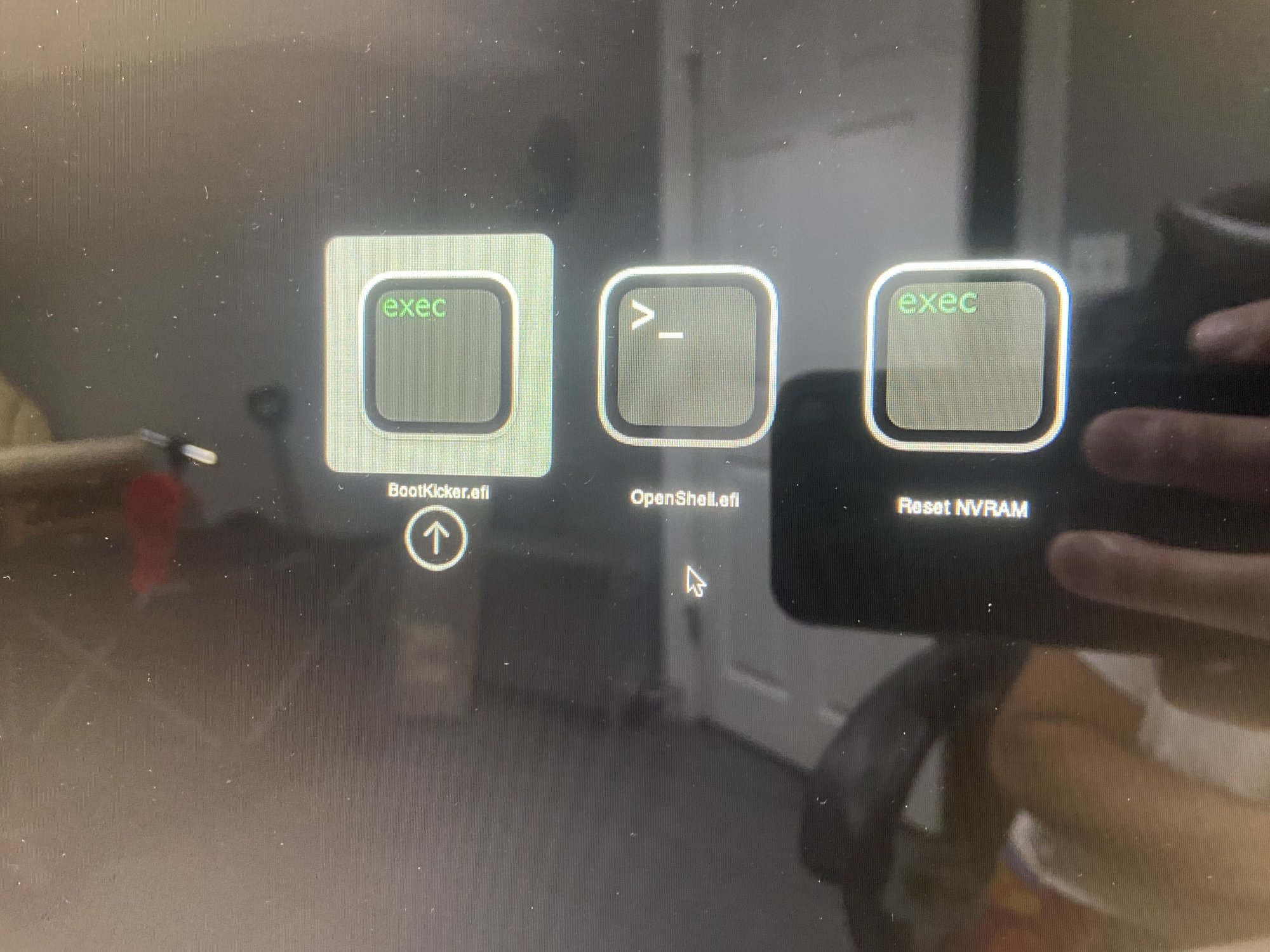

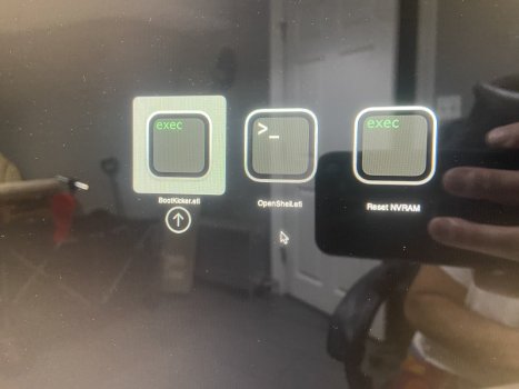

so....I messed up ventura installation using opencore, i tried fixing it but just ended up digging a deeper hole and now whenever i turn my macbook on im presented with
[Bootkicker.efi / Openshell.efi / ResetNVRAM]
help!!
HI Tea, It happened to me samething with Ventura, could you fix your problem?, I am stock and dont know what to do
I guess your macOS Recovery partition is damaged so it's not possible to get into Recovery Mode.
Have you reset the NVRAM yet? If not, your machine will still boot to OpenCore. In that case, your Option-Shift-Command-R key combination could be sent to OpenCore.
To enter internet recovery mode, make sure you press Option-Shift-Command-R early enough (immediately when you hear the startup chime or see the Apple logo light) so the signal can be sent to the firmware, not OpenCore.
If the problem persists, there could be something else wrong. I would suggest that you check if pressing the Option key takes you to the boot device selection menu. Only if the Option key works can we proceed to the USB installation way.
I assume you have a PC? You may try gibMacOS (open source software) though I am not sure if it works in this situation.

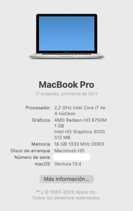

For years I work with two system, an external usb and the internal one. Usually when I change between them I have to resolve a problem with iCloud and it ask me the pass and the six code of 2pass protect. I switch between 13.2.1 and 13.4 but it's a common issue to me when switch with other older system

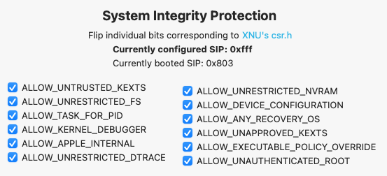

The question is about copying file to /System/Library/LaunchAgent/ folder I'm following a tutorial that order me disable SIP, I have to do it through OCPL Patcher in Settings/Security tab. After Build, install OC and Root Patch ... I'm still not able to copy anything in System/Library/LaunchAgent folder, I have a forbidden signal
Anyway I see the next problem when I try to change permission
sudo mount -uw / mount_apfs: volume could not be mounted: Permission denied mount: / failed with 66

You can't directly mount the root volume since Big Sur, you need to mount it a different place, do your changes then create a new snapshot.
The process is described there.
