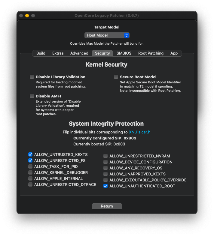

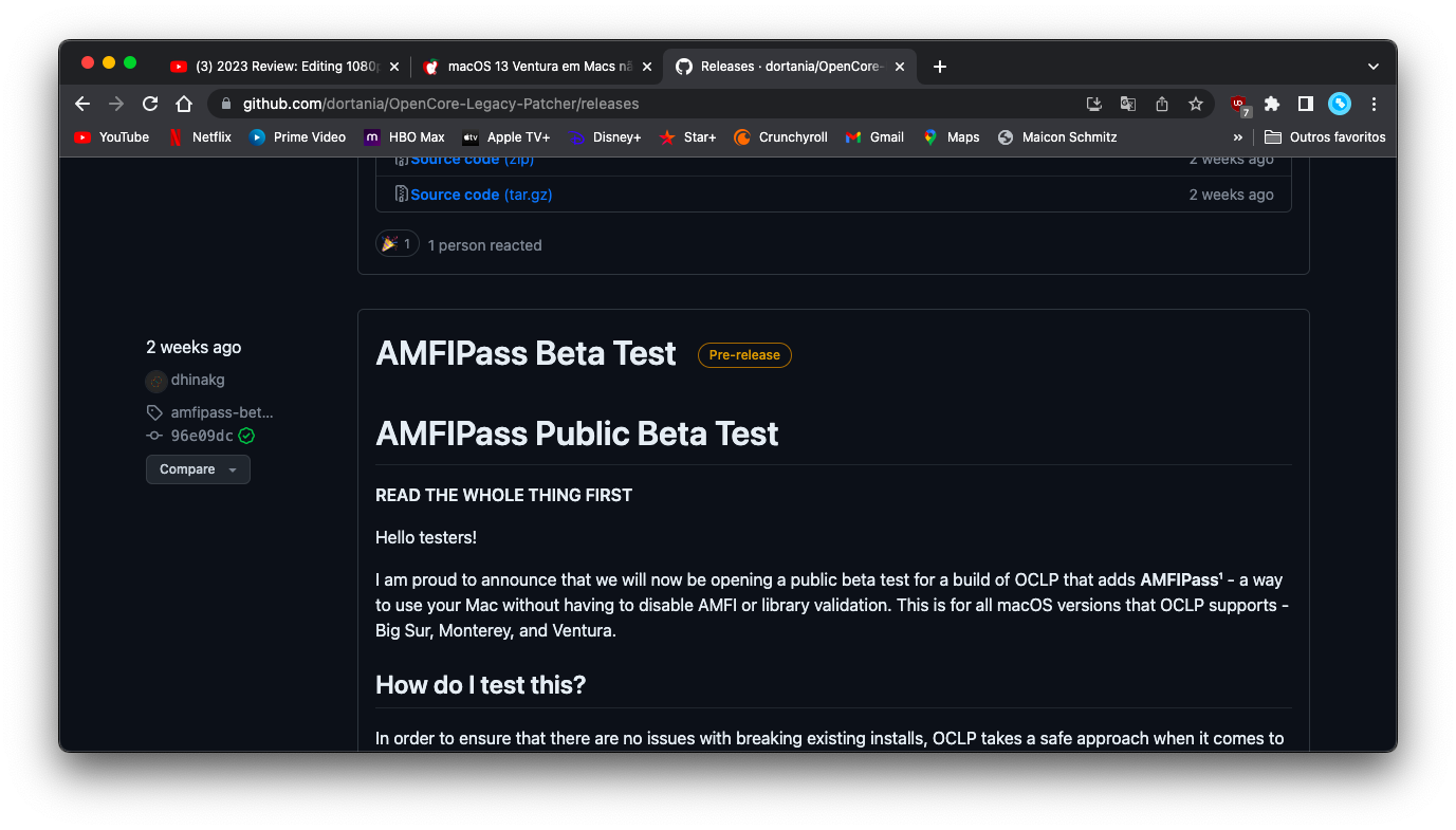

Does OCLP 0.6.7 incorporate AMFIpatch?
I just used the OCLP 0.6.7 (Release) to build an OC EFI for my MBP6,2 and it did NOT include AMFIPass.kext.
EDIT: Note that I unchecked "Disable Library Validation" and "Disable AMFI" in the OCLP GUI before building my OC EFI (what the GUI calls "Build and Install OpenCore").
