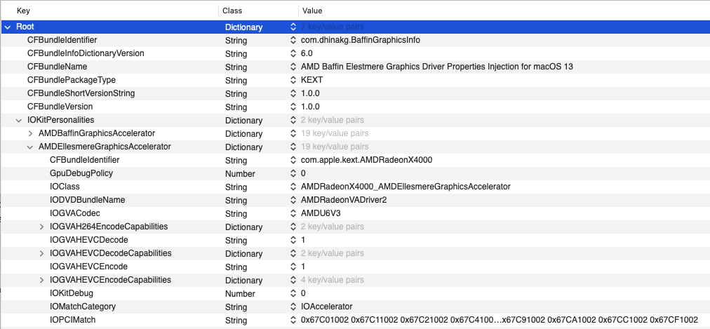

Apple systems are always focused on IQSV and the features of discrete graphics cards have long been removed from the system. But they can be returned manually.
To do this, you need to follow two steps. First, enter the commands from this list.
Here is the list of commands
And now the second step. In order for them to work, you need to create and then boot a kext, in which you need to register the properties previously removed by Apple. Here, on the example of Baffin or Elesmere.
There is no executable in kext, only info.plist.
It boots, I use it for my old system.
I'm afraid my poor knowledge of english will not allow me to explain this more clearly.
I'll include this kext for reference. If it suits someone, you can use it.

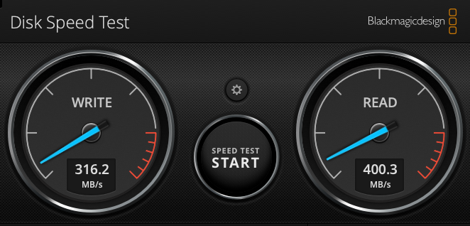

I have a question regarding the 2012-13 A1398, which uses a proprietary SATA SSD.
The speed of the SSD has noticeably decreased.
Has anyone experienced this and may know a solution?

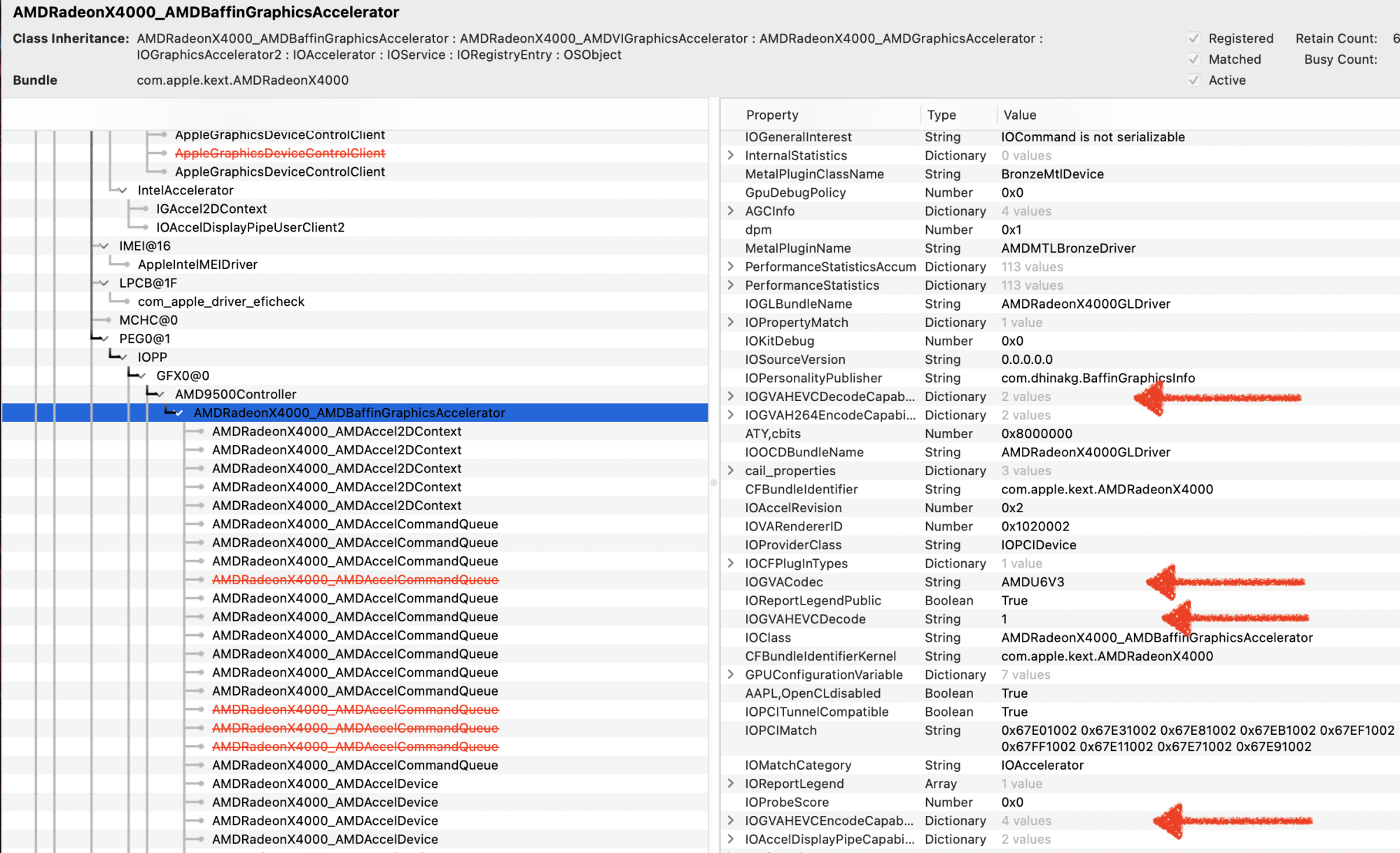

Another big picture. But it shows how the kext returned the properties that I specified to the system. It is important that it contains the correct ID of your accelerator.

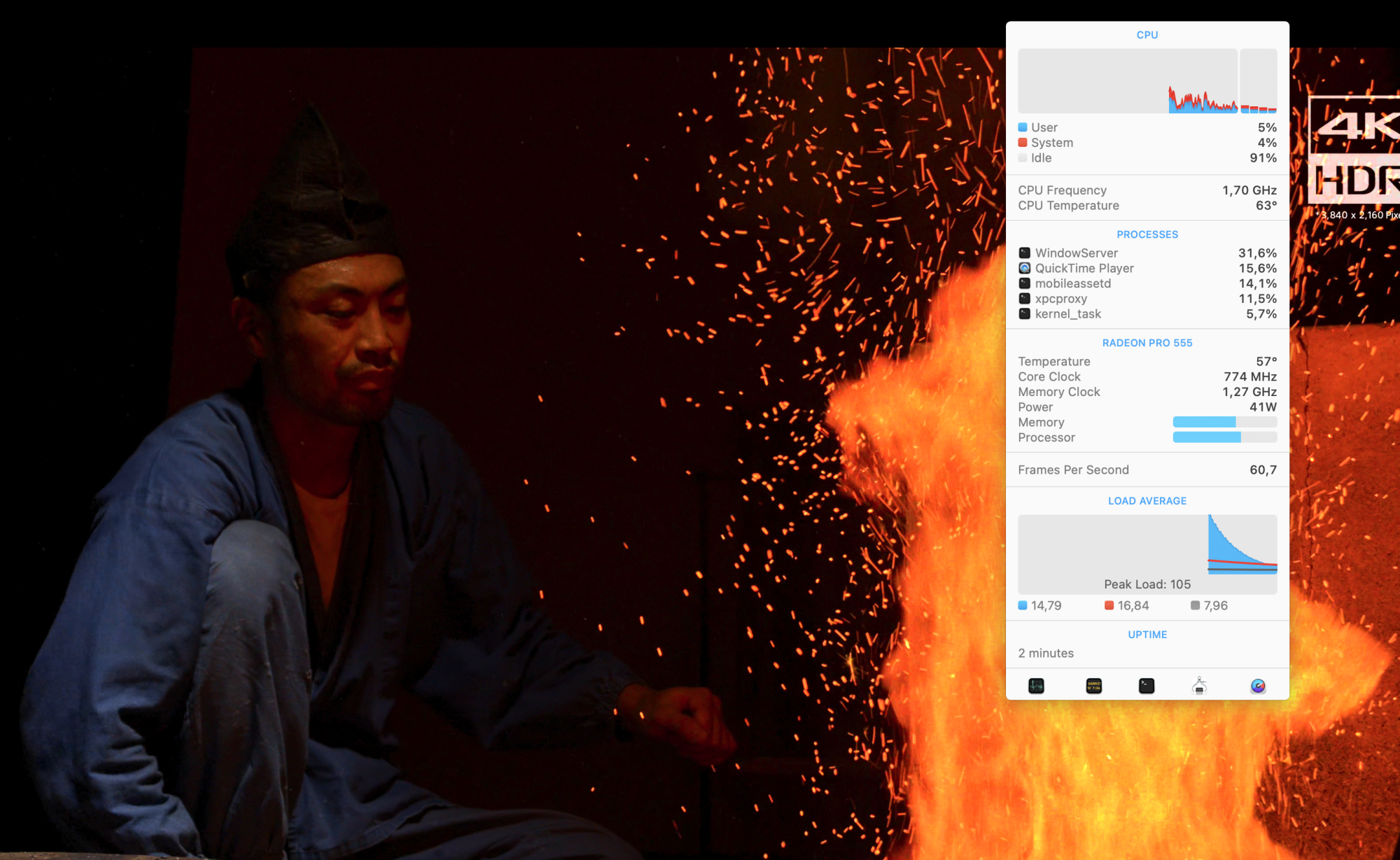

It was necessary to immediately show this image.
This is the famous Sony Swordsmith - is a promotional video in Ultra-HD reproduced by Baffin.

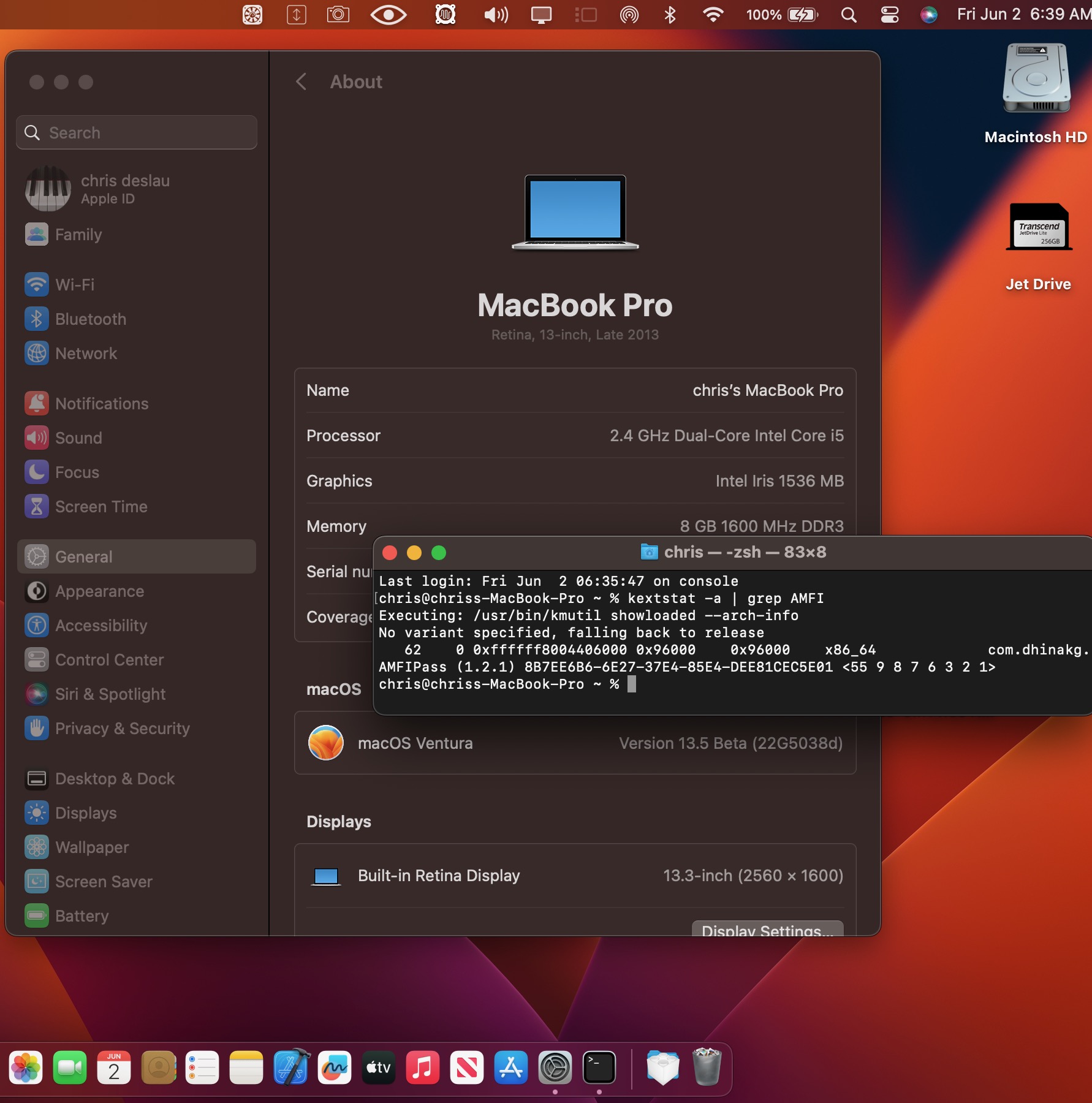

Has anyone been able to update their mac to the latest Ventura 13.5 beta 2? Did the AMFIPass Beta Test need to run again?
Thanks
I have updated all my Mac laptops to Ventura 13.5 Beta (22G5038d) without issue. I never did the AMFIPass Beta Test. I just updated to OCLP 0.6.6 and had no issue with the updating process. For me it was all a smooth update then I performed the usual root patches and was all set.
Reactions: chris1111
I am not technically very astute, but I believe I did. I updated OTA the same way before and after the AMFIpass beta.
I had the AMFIpass applied before upgrading OTA (+11Gb) to 13.5B2 (22G5038d). Upon reboot, OCLP prompted me to reinstall the post-patch which I did and so far so good. I did not take the nightly OCLP, still using the AMFIpass version. Hoping the Devs incorporate/merge it for the next nightly/version.
