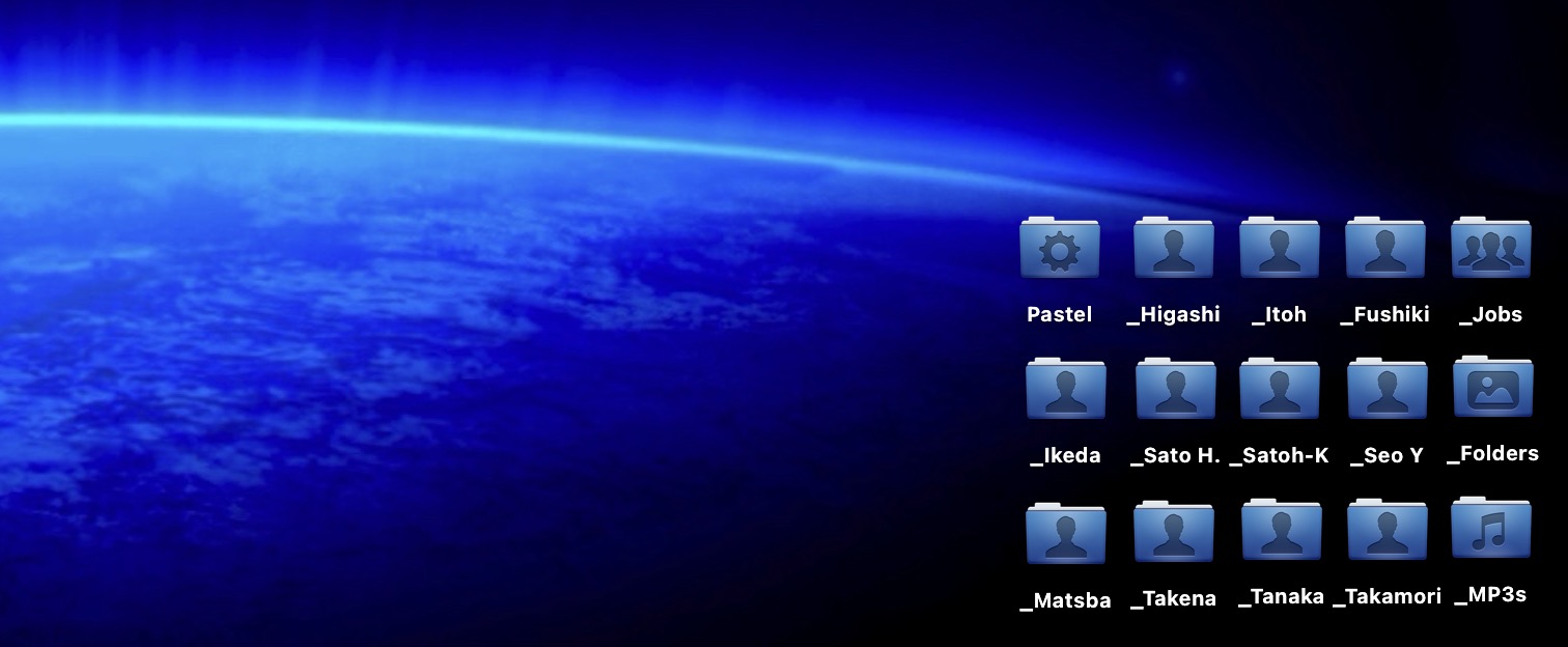

In addition, I (and I assume many other users) have a hard time with the color scheme macOS uses for folders. The greenish, almost florescent tone looks terrible. So I looked for icon sets on the Deviant art site,
Using those makes life a little better, at least the screen doesn't scream at me like it used to. You should be able to find something you like.
In addition, I (and I assume many other users) have a hard time with the color scheme macOS uses for folders. The greenish, almost florescent tone looks terrible. So I lookedd for icon sets on the Deviant art site,

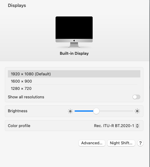

Had previously tried P3, as well as all the others listed. Thanks for the link to deviant art. Far from what I'd really like, but for me this is the one with the least objectionable folder color:
