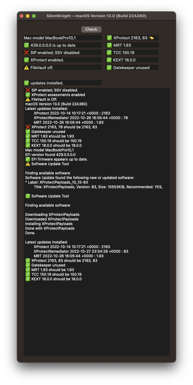

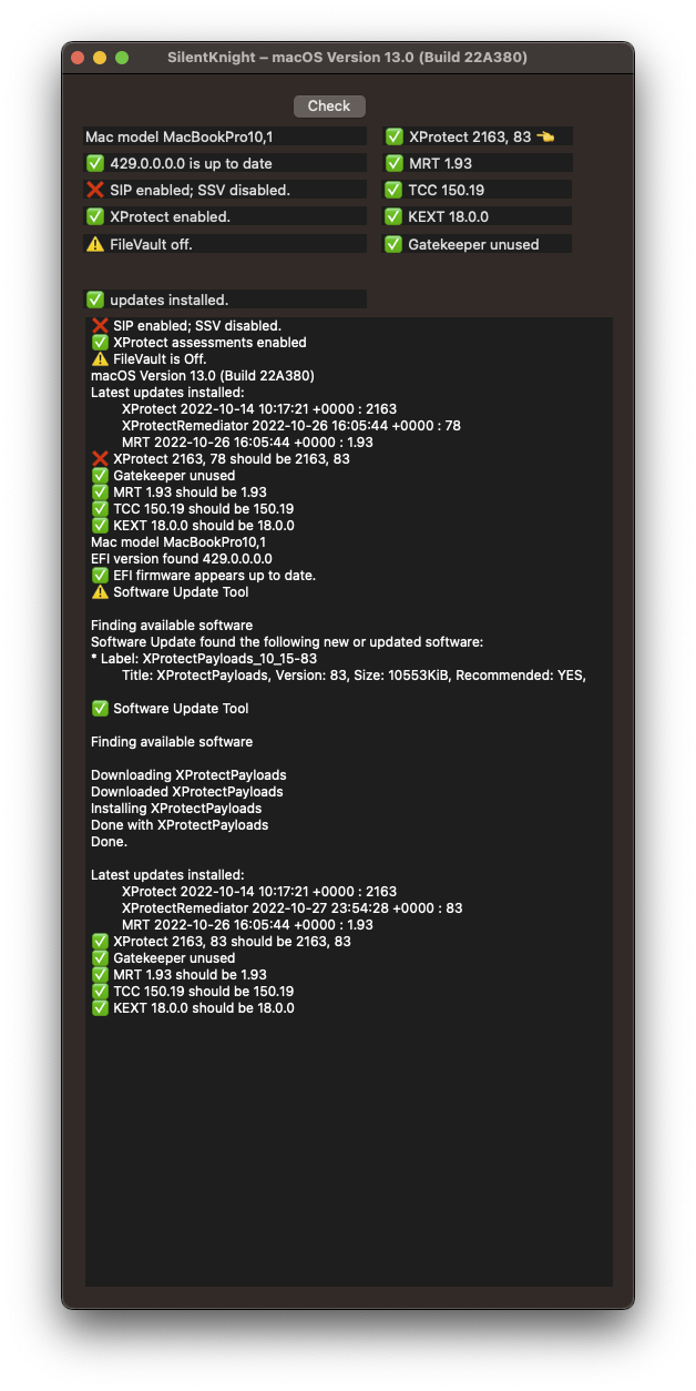

FYI SilentKnight update alert this evening:
XProtect 2163, 78 should be 2163, 83

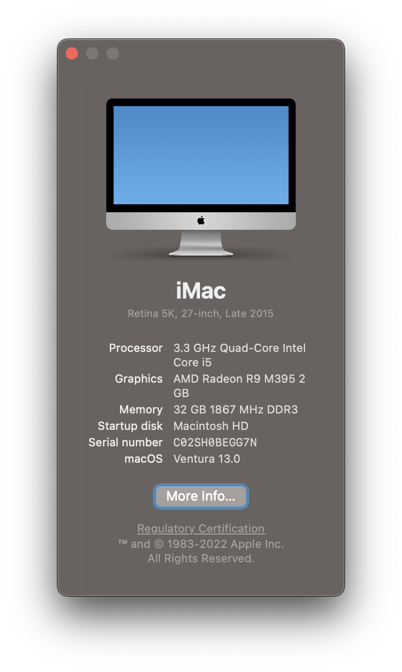

I have successfully updated my late 2015 27" iMac to Ventura. I installed OpenCore to the SSD instead of the HDD and everything has been fine. Also, because it was an upgrade over Monterey, which is natively supported for this Mac, OCLP notified me of the Root patches already being installed. So didn't need to do anything extra after the update other than turning off the option to show the boot picker.
Funny... I have the same iMac and had to install the Root Patches because after the install the screen wasn't recognized as an Apple built-in but as a 3rd party monitor, which broke the resolution (huge screen space). Also the control keys of the keyboard weren't working.
After installing the root patches it all came back to normal.

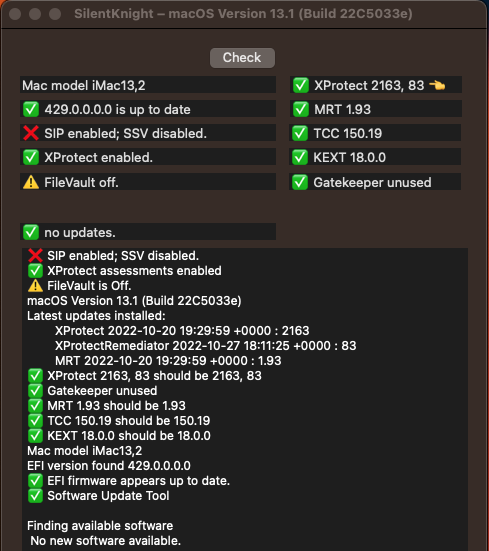

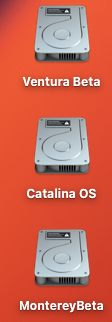

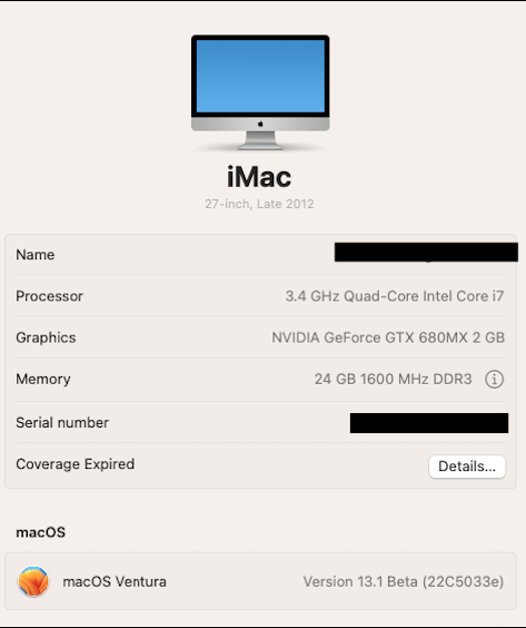

Hello to all,
Successful installation of Ventura 13 beta 11, followed by update to Ventura 13.1 beta1 on late 2012 iMac 13,2.
Method:
While booted into Monterey, and using Disk Utility, created a 200 GB APFS partition on iMac’s (original) internal
1 TB Fusion HDD. Drive has two other partitions (for total of three); other partitions hold Catalina and Monterey.
Downloaded latest OCLP patcher from Dortania; (then) OCLP 0.5.0
While booted in Monetary, build and installed OCLP onto USB thumb Drive and iMac’s internal HDD.
Downloaded latest, then available, Ventura beta installer from Mr. Macintosh site ( Ventura 13.0 22A5373b B11 P9)
Created a USB Ventura installer via OCLP’s build-in function (selection in OCLP’s main menu)
Booted into USB Ventura installer and proceeded to install OS onto designated internal HDD partition.
It required few reboots to complete, including a stall (latter required hard reboot), but Ventura fully installed.
Installation does necessitate a level of vigilance, to make sure that during reboots, boot-picker points to the appropriate installer, e.g. install MacOS , or in latter phases, Ventura (Beta) icon, rather than inadvertently reboot into other operating system version (or not at all).
Applied post install patches while booted into Ventura.
Rebooted without incidents, into fully functional, accelerated Ventura 13 beta11.
Updated to Ventura 13.1 Beta1 via the OTA route without problems.
Applied (latest?) Post-install patches using OCLP 0.5.2n. On reboot found Ventura 13.1 beta1 fully operational, and very responsive. Appears to perform significantly faster than Monterey.
Applications, such as MAPS, GIMP, Blender, LibreOffice, Safari and FireFox (developer edition) perform as expected; no problems noted with playing any video content, inclusive of YouTube.
Tremendous thank you to all the superb developers.

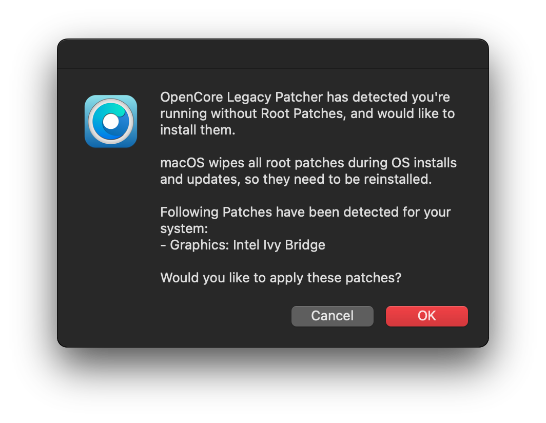

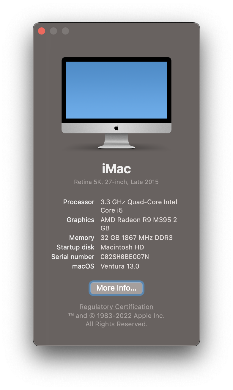

Guys, I'm new to dis... How will OpenCore handle the future OS updates?
How did you update? It's mentioned on this thread the recommended way is to create a USB installer with OpenCore patcher and do either do an upgrade / clean install that way. I'm glad you were able to get it working by applying the root patches after install. Mine either did it automatically, or since I had Monterey installed, it kept what was needed from that. Mr. Macintosh makes reference to this situation in his video here:
In this video, he uses a 2015 MBP, different machine, but same results I had with the iMac.

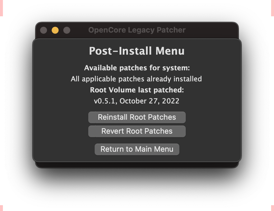

OCLP doesn't do it - all the patches from previous installation get wiped out.
I was expecting to apply them after the upgrade, but after going into post install patcher, it said they were already installed, and the graphics like Dock and menu bar, the display, etc all worked. While the installer was running, yes the graphics were not correct then, and everything was tiny. However on the last reboot into the OS, everything came back normally, and I didn't have to do anything. The only message I got from OCLP after the upgrade was to install to the internal drive vs the USB drive. I came from a natively supported OS to one that needs OCLP. Wonder if that's why I already had the native patches. All I know is the machine didn't need anything else than what I mentioned in my posts.
This is what I saw after checking the root patch status yesterday.
I wanted to update XProtect using SlientKnight on my Mac mini running Monterey. After hitting the update button in the app, the machine rebooted and began to install Ventura without me taking any action. Not quite what I was expecting.
I too had SilentKnight listing XPR as outdated on my 12.6.1 but also Ventura Update was listed. I pressed "Install all updates" in SilentKnight hoping it would update XPR... My Mac began downloading, after 2 Gigs I made a restart because I feared it would update my main disk to ventura.

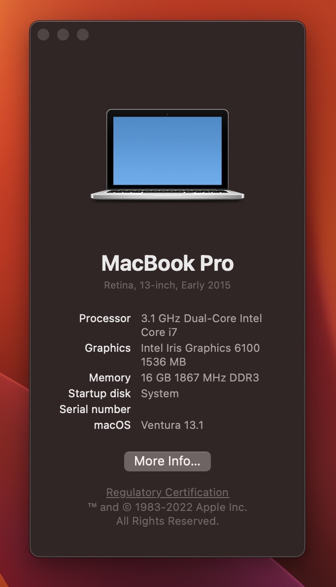

OCLP 0.5.1 with Ventura Beta (build 22C5033e) installed on an Early 2015 13-inch i7 3.1GHz/16GB/1TB MacBook Pro. Everything seems to work smoothly so far.
Thanks to the hard work everyone on the dev team has put to make this a possibility. If I run into any issues I will be happy to feed them back to help improve the overall quality of this installer. Awesome work!
